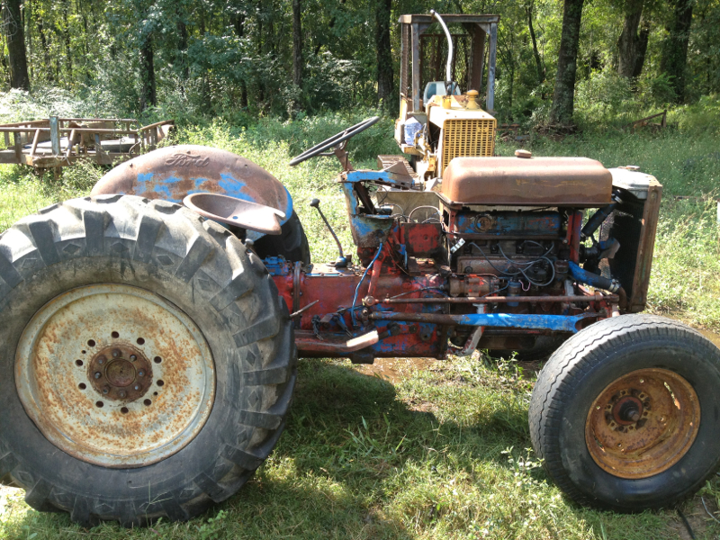

Did a little cleaning on the 640
/ 640 with loader #37
interesting rears.. what size are they?
check out the frotn axle.. i detect some bowing in the radius rods.
/ 640 with loader
#38
The rear tires are 13.00 x24 there are from my forklift, the tires that came with the 640 we put on the 8N, yes the front axle is about shot I'm gunna have to go get it bored and bushing back to std and get a new pin. As for the radius arm it is a little bowed but the right isn't the trunion balls have a lot of wear and slack
/ 640 with loader #39
unless the balls slip out of the socket completely.. they are a non issue.
a chain and bottle jack can usually straightent he arm.
a metal slug, lead weight or penny can be put int he socket behind the ball.. so can a piece of inner tube.. works great..
