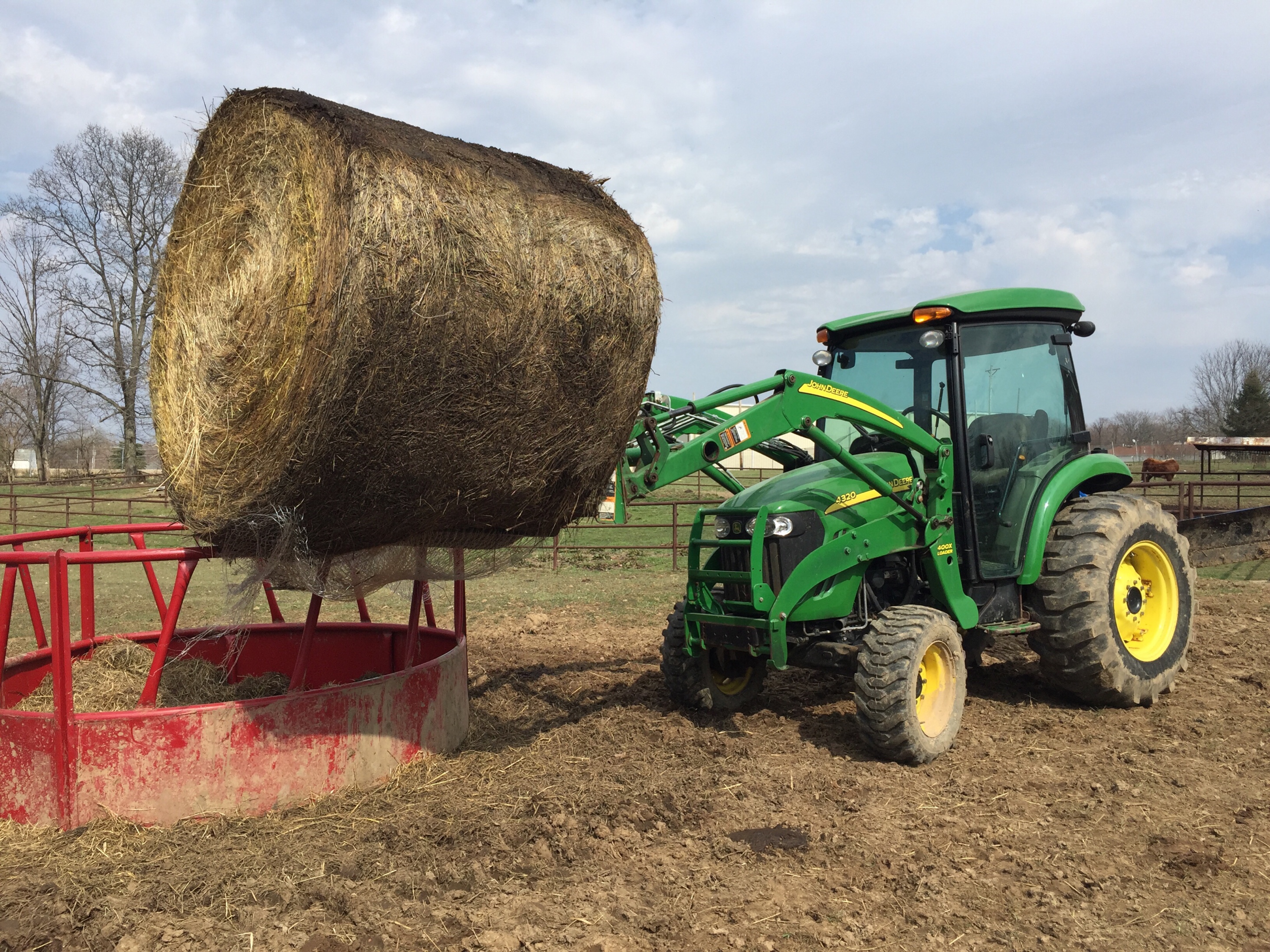

You can put a FEL on anything, only thing is with a 2wd you will need lots of rear ballast for a FEL, if I'm on a slight hill pointing down with a round bale on dry grass my rear wheels will spin pretty easy and start digging up my turf, I have found myself kicking it in 4wd often.
Also going down hill with a load up front you only have rear wheels to break, there's a few guys on here that went for a ride because there rear got too light and there barn stopped them after there forks put a hole in the wall, that scenario can be dangerous for obvious
If I didn't have a FEL I wouldn't own a tractor, that's 90% of my use for it.
