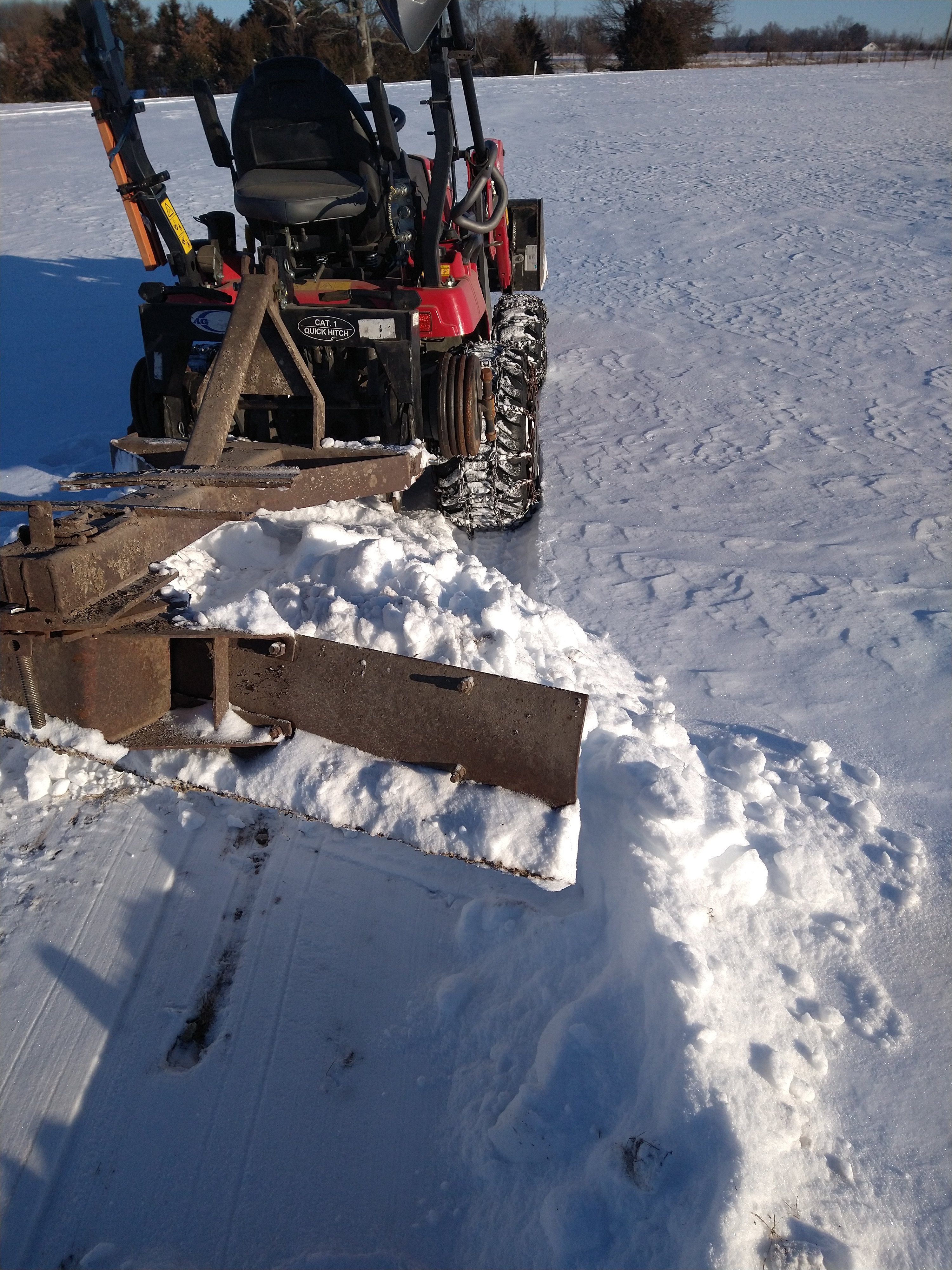

Follow up on snow removal with my tiny tractor up north. My hacked together 6' utv plow was ok til the snow got deeper I ended up putting the loader bucket back on . Other things I learned the somewhat hard way for next winter the mmm deck will be removed I high centered it on the deck several times in deeper snow. Hopefully it's not damaged to bad but I'm ready with backwoods hackery to get it going. Next year I'm running 4 tire chains, no mower deck, and I'm saving up for a 4' tph PTO snowblower. My neighbor up there has one and cleared the plow bank for my driveway entrance in no time. Before this I was using every inappropriate 4 letter word imaginable directed at the county. I apologize no pics of the snow depth up there but I will say I got a long track deeper lug profile snowmobile buried on my property to the point I had to use a chain fall to get it out, using more inappropriate 4 letter words. This winter was a very decent one up there imo. Maybe I'll post more on my tiny tractor as projects I use it for entail and next winters up grades.

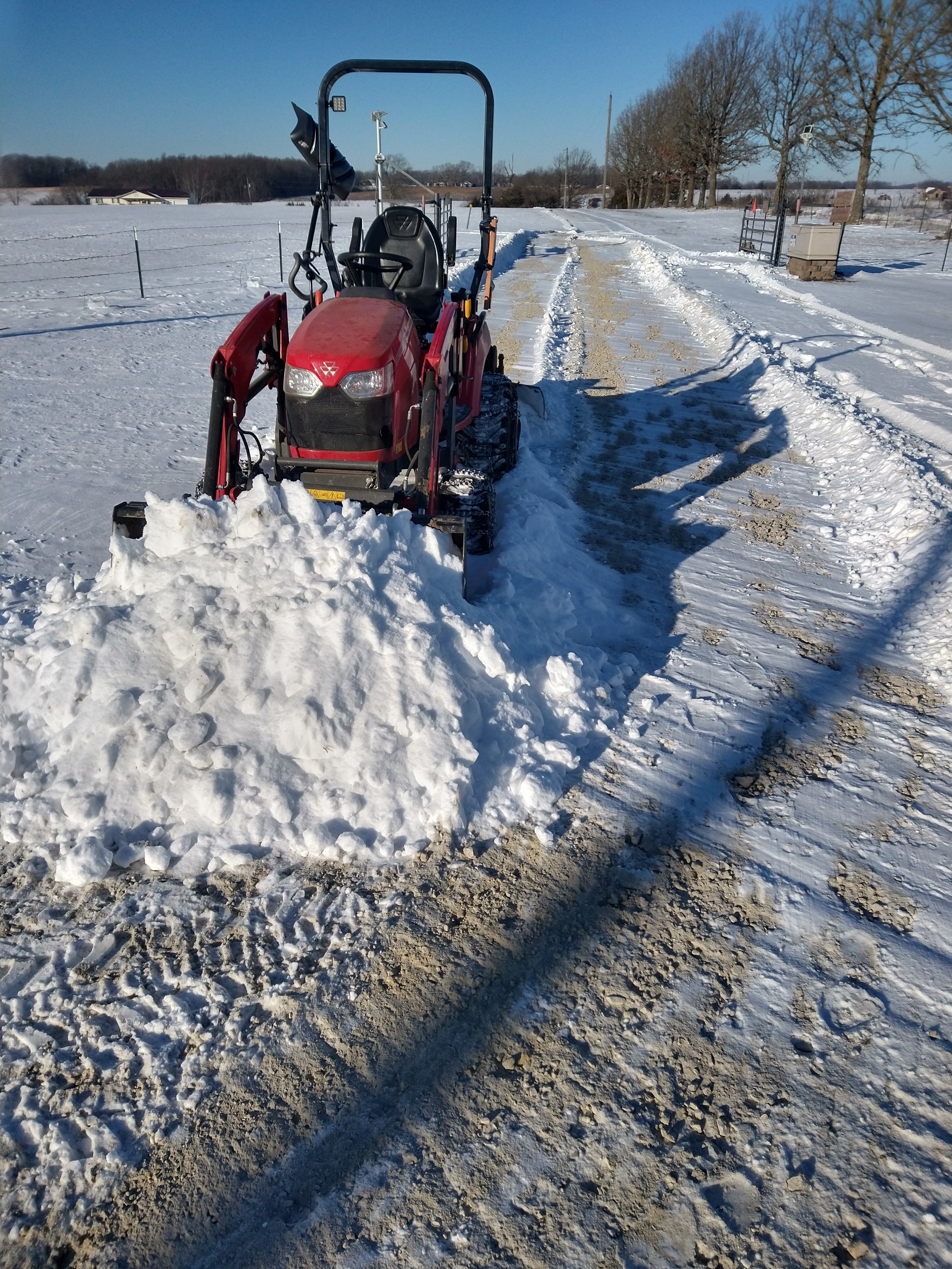

Here is my tiny tractor getting it done ...
I have filled tires, wheel weights and an extra 275 Lbs on the BH frame, to help me keep going straight!
Sure beats a shovel!

Yes, chains help alot in the snow!
