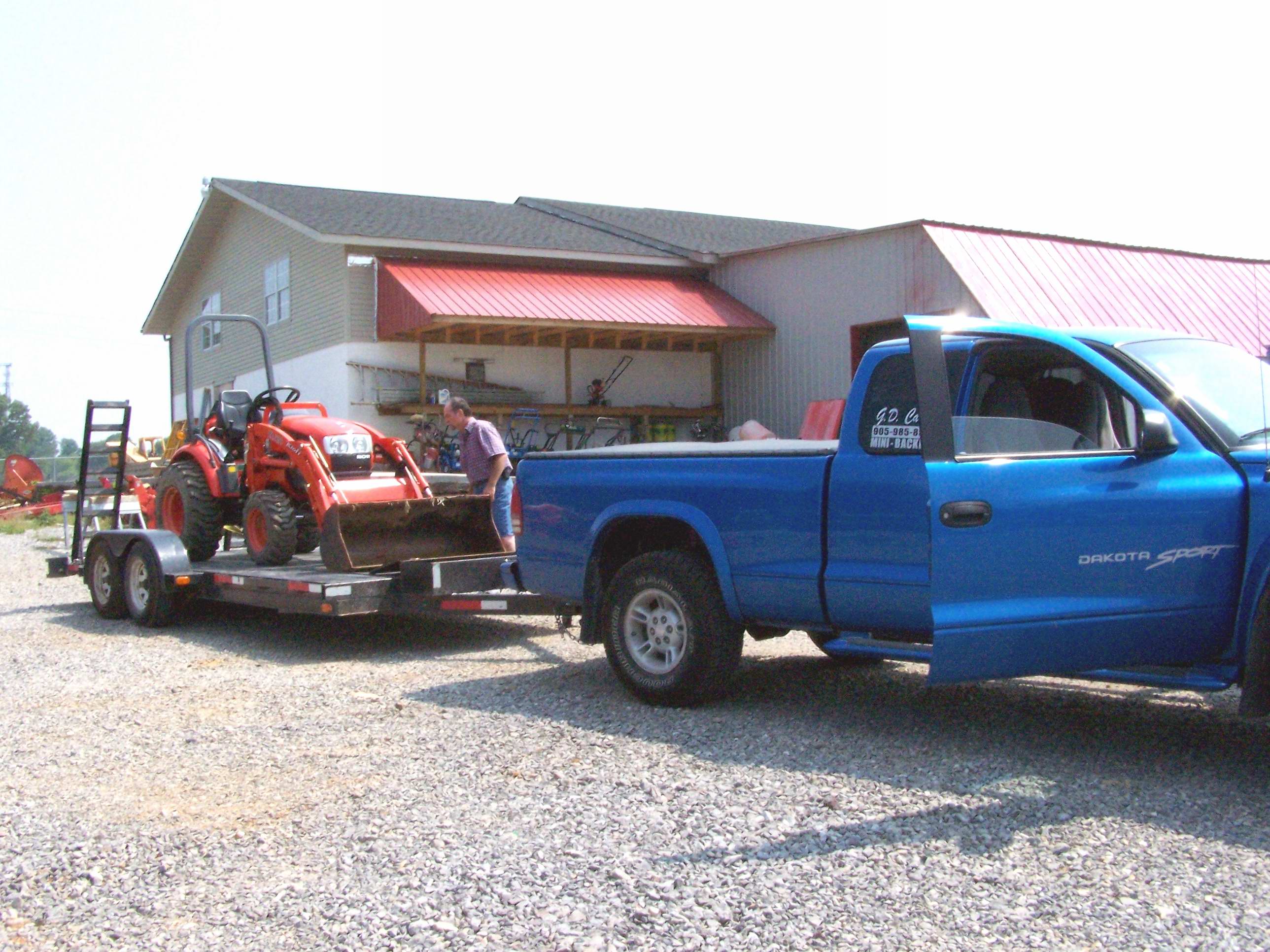

Mr Brown that setup should really work for you, I tow a 7000lb trailer with brakes at all wheels with a Dodge Dakota v8 with trailer package and haul my ck20 loader and backhoe all the time with absolutely no problems, drew the kioti home to Ontario from Tenn. this past summer . Gary
