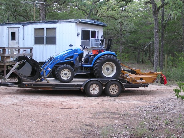

like everyone else - I'd go with the heavier trailer ....and LONGER ... If you stay at 16' -- you WILL be sorry. Go at least 18 and 20 would be better. I had 2 16' trailers, the first one was used and came with the 8n, I now have an 18' ....AND WISH IT WAS LONGER! I want a heavier tow vehicle and a 22' gooseneck. see attached pic why I need a longer trailer.
I only have a BX and I'm trying to keep it real. I don't disagree with you one bit, but at the same time I really don't know if I want that big of a trailer. Standing on the deck, it IS bigger. Significantly bigger. And heavier. I'd be giving up even more capacity to the trailer itself, which is what I'm trying to avoid. Again...totally agree, but I think 16' fits me pretty good.
I've been thinking about it and with the capacity being what it is, I have no problem swinging my BH boom to one side or another (shifting a whopping 300# or so to one side) and picking up another 3 feet of open deck space if I need it. Thusly oriented, my tractor consumes about 12.5 feet in length...15.5 feet with the BH centered behind the tractor.
