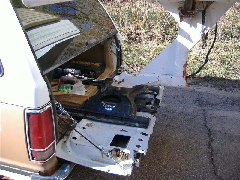

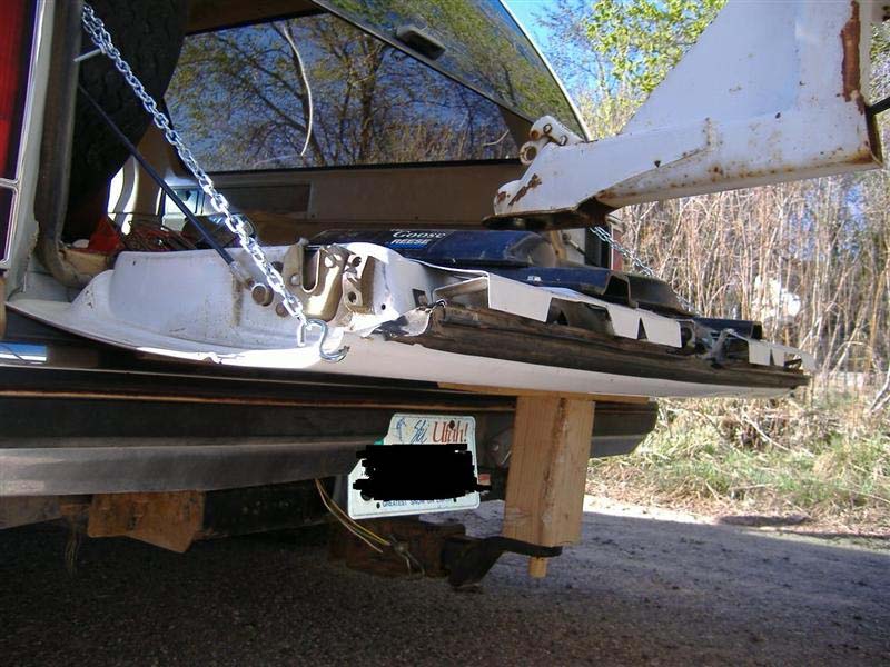

I can't fathom the fuzz bothering "normal" folks when towing their trailer. Normal, I mean truck towing trailer with reasonable object attached to trailer with some manner of care. They aren't going to fiddle with what package my truck has and whatever. You KNOW when the setup is backwards.
I always keep these pictures handy just in case we digress too deep into the hole. THIS is what I think the laws are written to prevent.
Any questions?
