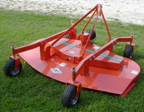

O.K., I don't think anyone has posted this idea yet, so let's try. Now, I realize I was born stupid, but if your new mower is like this one:
it appears that the wheels are held on just like the ones on my KK RFM. If so, why not just get some pipe or bar stock the same diameter as the bar stock on the wheel support, cut it to an appropriate length and when you're ready to transport, pop the pin holding the wheels in, pull 'em out, install the longer piece of bar stock (you'll need a hole for a pin drilled in the correct location of the bar stock or some type of stop welded to it) and set the unit down on the four "stands". Since this utilizes the structure that is designed to support the mower in the field, it would seem the least likely to do any damage.

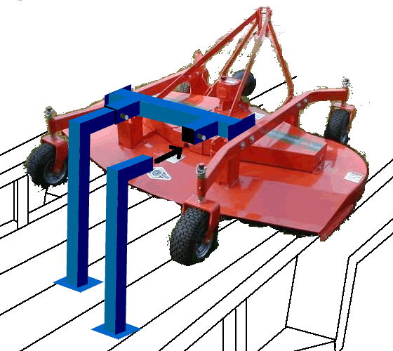

Is this similar to what you suggested, See attached pic.
CVHoss,
This is the type of common sense approach that most of us totally overlook.....I think it would work!

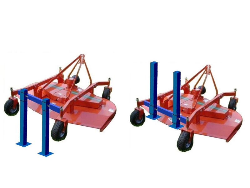

Sort of..... I was thinking of a vertical stand that worked like a jack stand.
If this pix posts. Here is a view with the stands down for transport and up for mowing.
