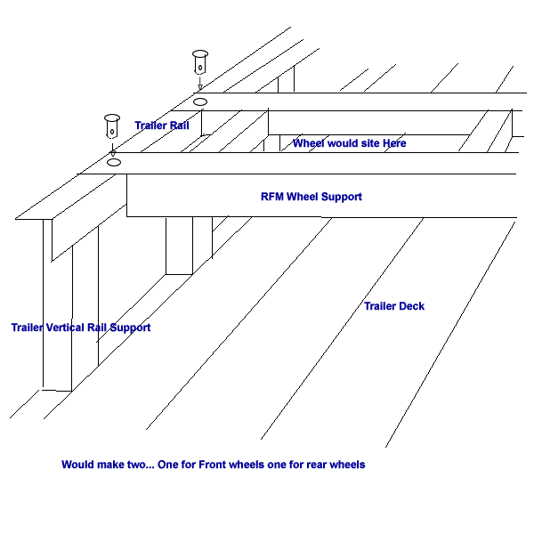

To get it large enough to cup the wheels it would have to be pretty largewhich would translate to a lot of weight to be moving every time I load and unload.
What if I take two pieces of angle and weld some shorter pieces perpidicular to them to form a unit. then the wheels could cup in the space in between. See attached sketch.
What do you guys think?

How about a couple of screw type trailer tongue jacks mounted to the back of the mower? Screw down to put the weight of the mower on the deck of the trailer. Screw up to mow.
Or, a simple pipe and pin set up like on cheap jack stands. Pull the pin and set the pipe (stand) down to the trailer deck to hold up the mower. You would only need two holes on the pipe. One to hold it up and one to hold it down.
I'll see if I can dummy up a picture/plan.
