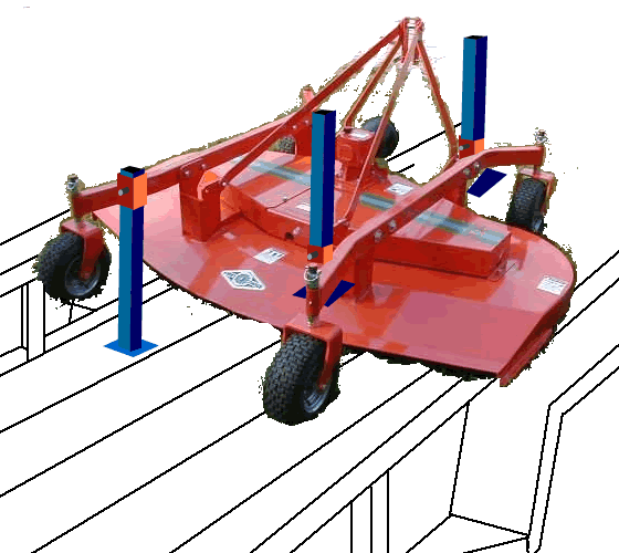

Yes, but I'm adding 2" square steel uprights in receiver hitches to hold it.

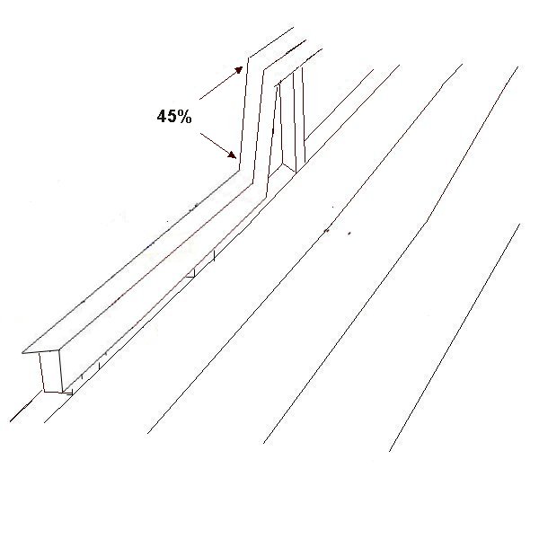

After seeing the drawing of the trailer you have, I think that you can safely modify the side rails to accommodate your mower.
The additional rigidity you get from the rail is not in the uprights but in the angle welded to the top of the uprights. It doesn't matter how high they are.
You could start just behind the wheels, drop the rail to just off the deck, and still maintain the integrity of the frame.
See attachment.

I was talking about the operational weight of the mower. I broke the bead on one of my gauge wheels, on my 600lb 72" First Choice finish mower yesterday. When I turned real tight on soft ground. Brandon's mower weighs an additional 200+ lbs, running on @ the same size tires. I'm not sure that adding more weight to an already heavy mower is such a good idea. Maybe JimMC will have an answer to this.
   / 7' First Choice RFM on 6'9 #44
Re: 7\' First Choice RFM on 6\'9
I hadn't considered that but I think if a wheel was broken while turning too sharply, that is more a function of lateral force put on the joint than it's weight. Not sure if 200# either way would have made a difference.

That would work, But after looking at my trailer I am thinking that I might have to back the tractor on to get the propper weight distibution on the trailer. The 20' trailers have the wheels pushed more towords the rear that a 18' or 16'. I think it would also be nice to have the flexability to got either way.

Here is one that takes a little of the weight out by eliminating the cross brace tubing. Will need one at all four corners.
See attached

Too bad you don't have longer shafts on your casters. Then you could just lower them down enough so the mower would be high enough to clear you rails.
