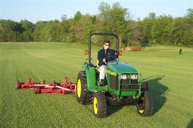

Billy: We have an RC field (www.flymha.com) but the 6 foot mower has problems scalping when you cut the grass that short. We usually use a 15 foot gang mower that floats over the bumps and small hills since it is not graded 100% flat. The gang mower has 7 gangs, and the max width on any one is 30 inches. Grass really fllys when we use it. Or in this case while I'm drinking a beer watching my wife cut the grass....

Hi Wayne, you have my interest here, thanks for the idea! I will spend some time researching this type of mower. What is the price range for such a mower and what do you do about sharpening or replacing blades? My field is very flat since it was groomed with a cat when I built it but it's still not perfect.

The gang mowers are great, just do not let the grass get to tall or you will have problems with cut quality. The blades are self-sharpening by a friction bar that touches them in the rear and is adjustable for optimum drag on the reel. We bought our setup used about 10-12 years ago...not sure what we paid.
Check around some golf courses, find the maintenance shop and have some cash and beer with you, you might just get lucky!
Another thing to remember when using it is to plan your route carefully, you CANNOT back these things up! We used to tow it with a pickup truck before we bought tractors!

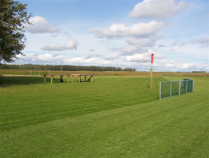

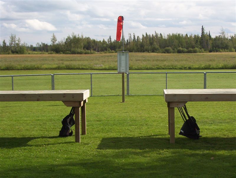

Hi Kenny, never expected to meet so many RCers on here. I beleive you are the third one now and I haven't been a TBN member very long. I have a private field on my own land. There are few locals in the area that fly here regularly and a few weekends a year we have people come from within a few hours away to camp, relax, socialize and occasionally fly a plane or two. Been tough to keep up with my 48" L130 but it did do the job. A new tractor is much needed for snow removal when my 1/4 mile of driveway blows in during the winter months. Here are some pictures of my setup. Thanks for the information and ideas.

WOW:eek: That sure is impressive!

BTW: Very nice looking field! Our club's field is rather rustic by comparison.

Our first mower was a three gang jacobson. I bought this one from a golf course in PA, it's a Toro as Kenny D said. It's not quite as good as the Jacobson units, but it's 15 foot wide versus 6. We've pulled this with Kenny's tractor, my 4400, my B and an IH-340 I had a few years back. It really needs 25-30 HP to pull, especially when the grass is a bit tall. My one wheel drive F-250 won't pull it under many conditions. The bad part is, it cuts many many acres per hour. Hardly enough time to finish one beer and I'm done with the field...
The web site TurfNet.com - The TurfNet Media Network has used turf equipment on it, and the prices are way better than anything I've seen on Fleabay.
