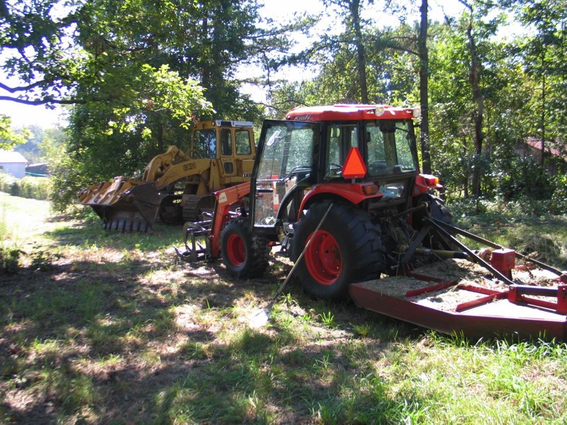

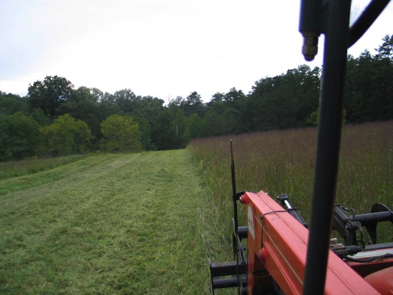

I bought a 7ft dual tail wheel International Machines (World Agri-tech) medium duty cutter a couple of years ago for about $1700. I've used it to mostly reclaim neglected fields. I've been very happy with it.
