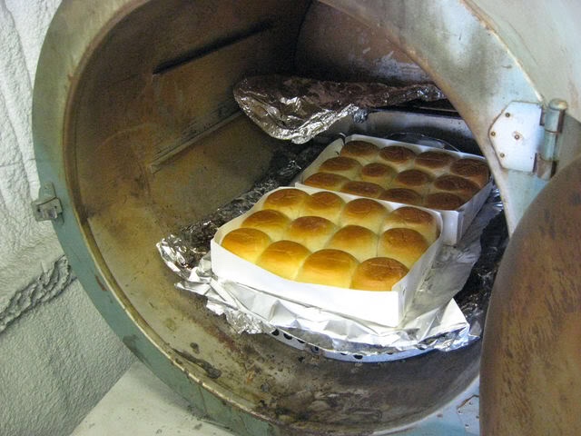

/ 7016 Rods? #10
Nothing welds better, than 7018 right out of the rod oven!
And nothing SMELLS better than 0212 dinner rolls right out of the rod oven!
/ 7016 Rods?
#11
But...but where did you put your rods while heating the dinner rolls for (Canadian) Thanksgiving??? (We lived near Merritt BC for 8 years on & off)
