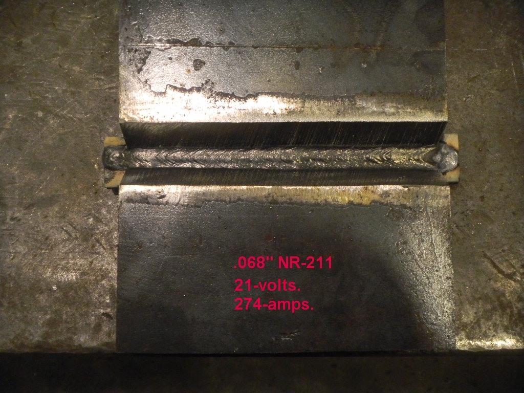

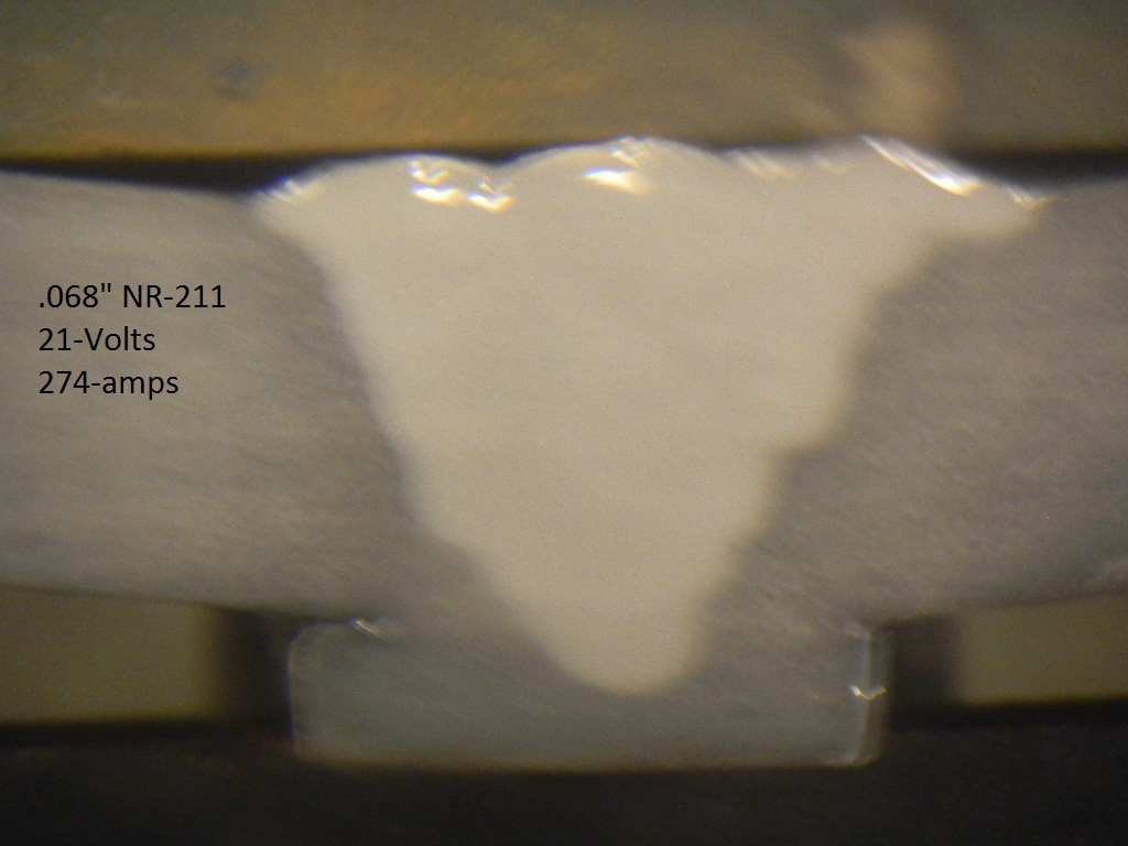

In my line of work, .068" self shielded wire was considered small. About the only time we seen it was if doing all vertical up welding. Most of the time we got 5/64" wire, or even 3/32" wire.

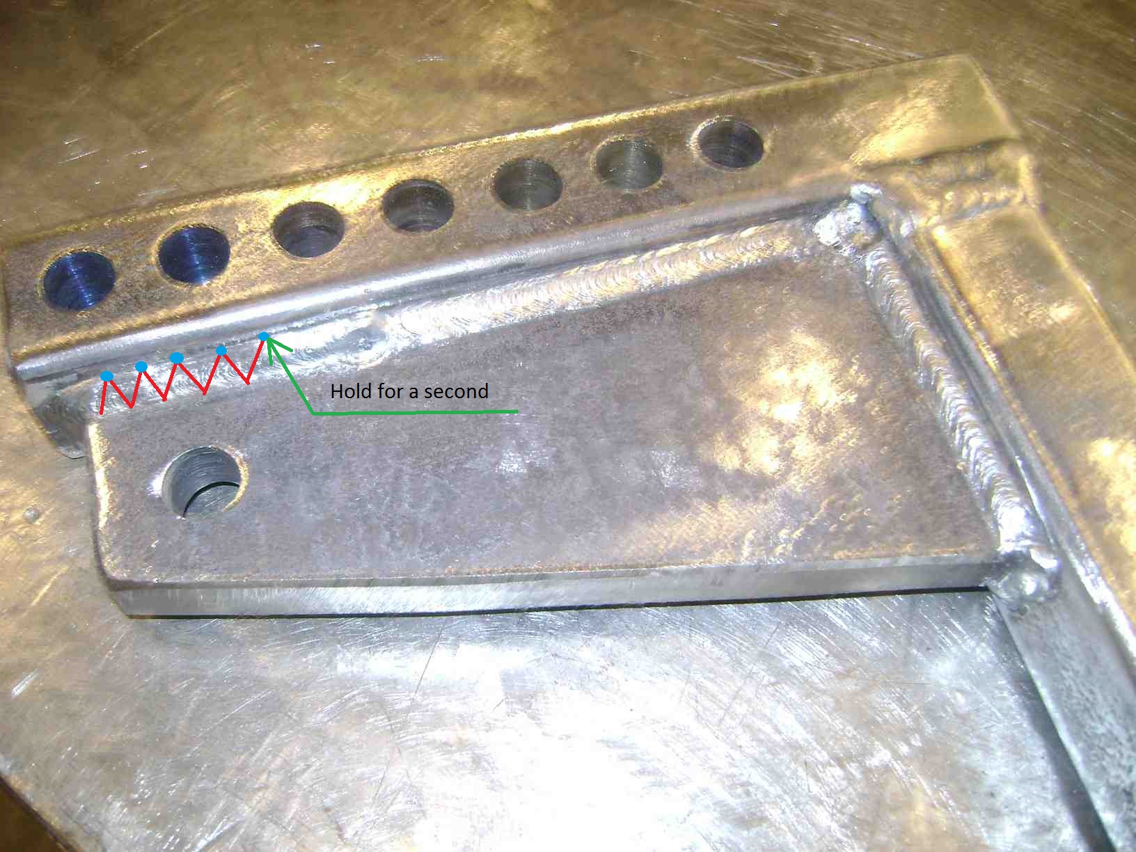

If you are right handed. Hold the Mig gun in your right hand. Start your weld on the right, and travel to your left, (push). Anything that produces slag, start on the left, and travel to your right, (drag).
99.9 % of the time I do a little up & down motion, or a little side to side motion.
