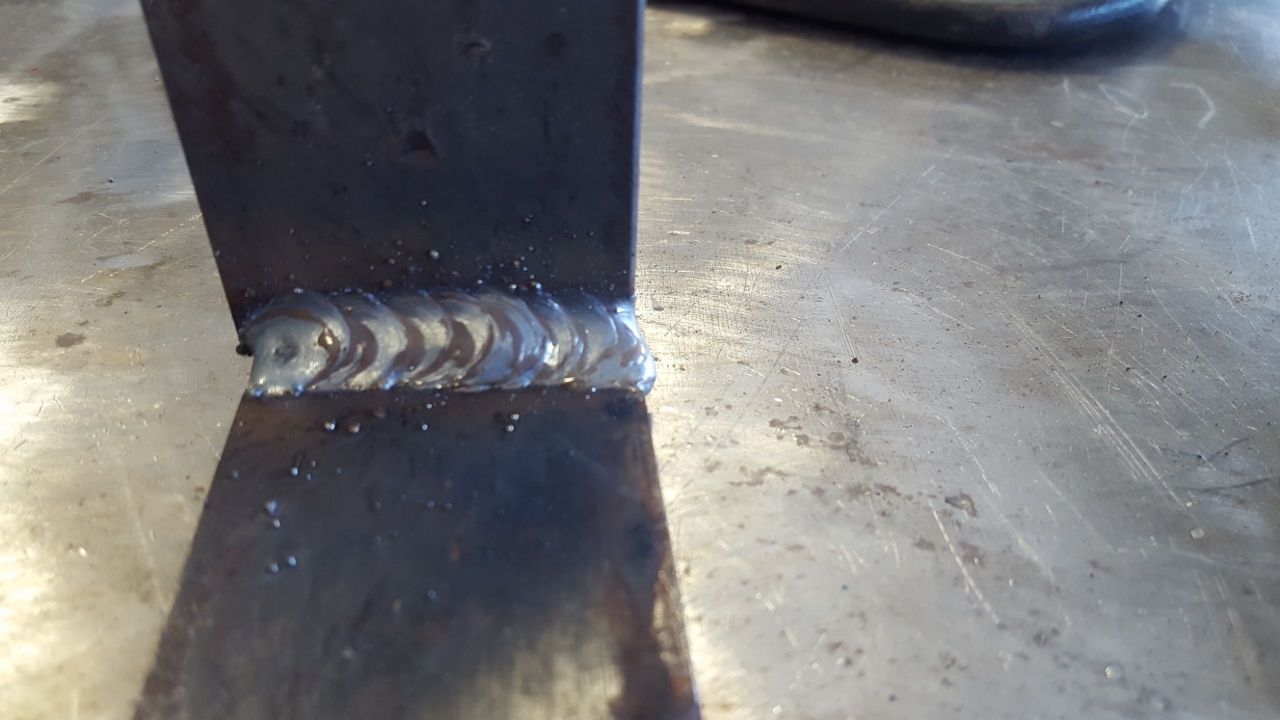

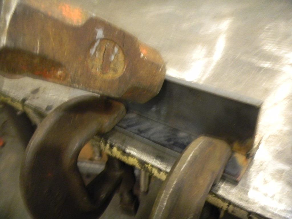

Do the same weld on the back side as you did on this one (both welded) and hit it, the material will bend before the weld breaks (most likely).
Yeah, most definitely. Actually I think a proper weld and the 1/4" material would bend even if only welded on one side.

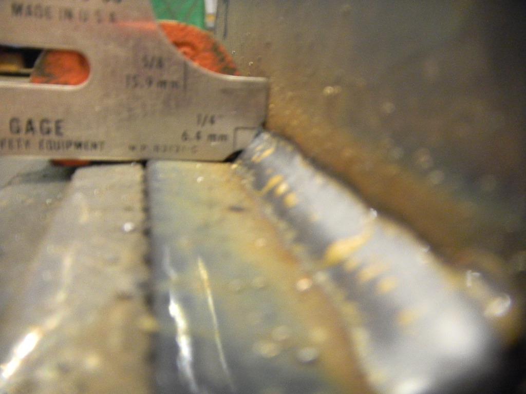

What I tried to do was duplicate Shield Arc's example to show the difference in a proper weld and an inadequate weld.
I could do that weld again and based on the weaknesses I see in this example, produce a stronger weld. I didn't get anywhere near enough penetration and my bead is too small. Not enough thickness in the center of the bead to produce strength.

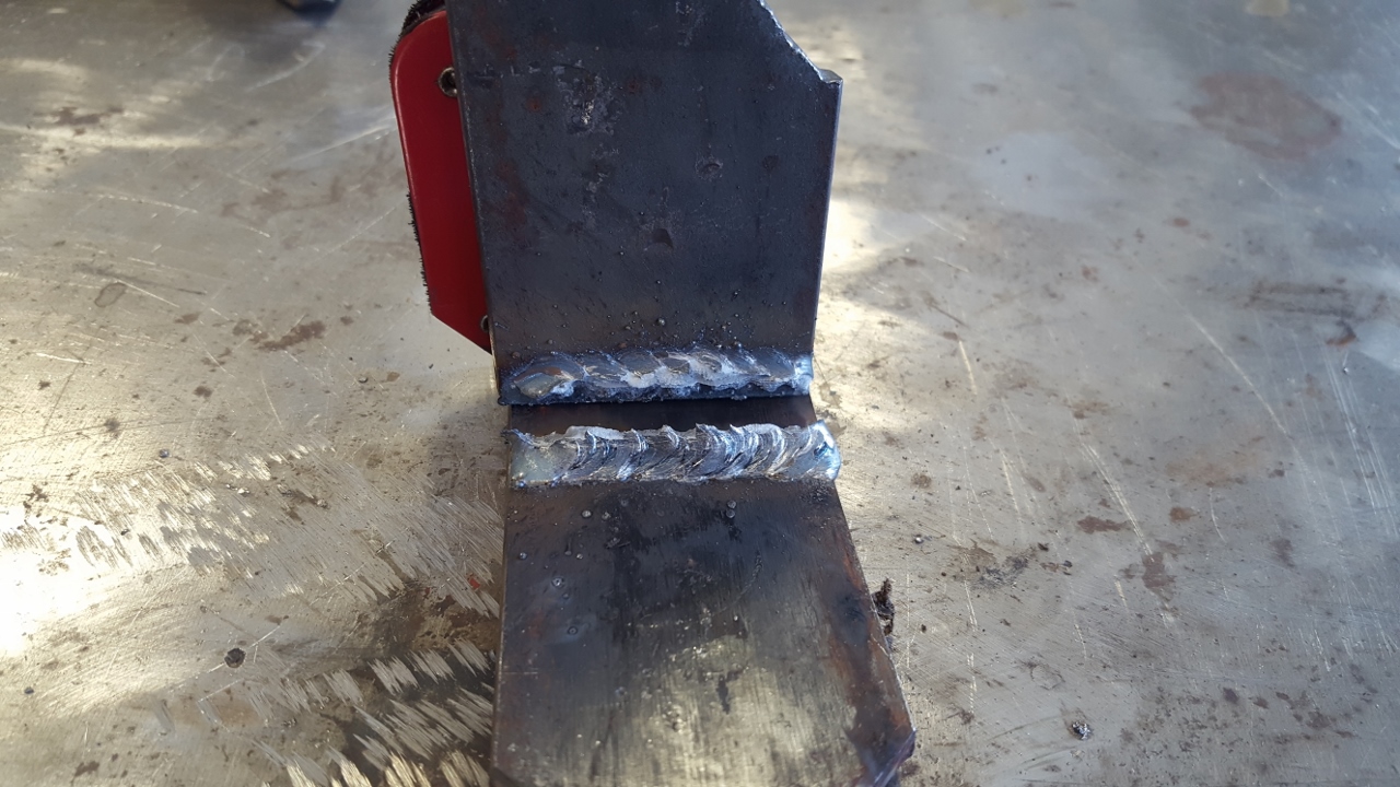

Here's my second attempt. Same welder setup. Slowed down a little and tried to push my heat more into the vertical piece. Bent the metal this time and had to hammer it the other way to finish the break. Still inadequate when compared to SA's examples. Almost need heavier wire and more power. :)

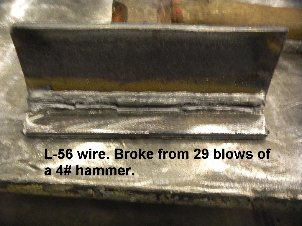

Here is a Mig fillet weld break test I did.
When I see the break pic I feel a little better. Then I look at the weld pic and I'm so inadequate!!!! :)
What is L56 wire and do you remember the welder settings used??

L-56 wire is made by Lincoln.
Here are my Mig settings.
.030" wire flat. 22-volts. 154-AMPS. 400 wire speed.
.030" wire vertical up hill. 21.6-volts. 78-AMPS. 200 wire speed.
.035" wire flat. 23-volts. 160-AMPS. 240 wire speed.
.035" vertical up hill. 18.0-volts. 125-AMPS. 198 wire speed.
.045" wire flat. 21.5-volts. 191-AMPS. 200 wire speed.
.045" wire vertical up hill. 18.5 volts. 140-AMPS. 120 wire speed.
