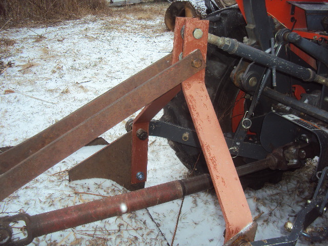

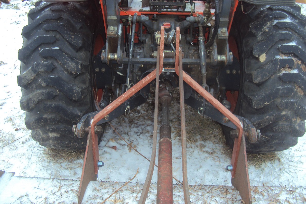

Okay, here's the old gal back together. Put some 'thoroughly tested' hours on her to give her some shake down time. Works like a top! :)
Props to the weld shop that fabbed up my new pieces. Really nice guys that are getting bigger all the time, yet still willing to do some small work and not make you feel like you're inconveniencing them.
Gave a couple of bucks under $70 for both, forgot 4 holes that needed punched when I first called and got a quote from them. That's why increase over original quote.
Attached a few pics:

Looks good as new. Now to deal with that bent blade.
The vibration may cause the new parts to fail - in another 20 years or so.
   / 7018 Vs. 7018AC, Need Layman's translation please:
#116
Looks good as new. Now to deal with that bent blade. The vibration may cause the new parts to fail - in another 20 years or so.
It really is a good old mower. :thumbsup:
The bent blade doesn't cause any vibration during use. For its age, ye old girl is actually quite a smooth runner.
I have no way of knowing whether the blades are original or have been replaced some time in its history, but I've checked them out pretty thoroughly. The mounting bolts don't have any slop or spots where they would hang up, and the blades aren't worn down to where I'd be concerned about any kind of breakage nor are they missing any chunks.
Now, in an attempt to not kill and or maim myself or anyone else around while using the mower. I have a question about heat and tempering and possible blade failure: If, one were to heat the offending blade up to straighten it out, is this some kind of major no-no that would change the metallurgy and make it brittle and therefore turn it into a flesh seeking missile of some sort?

As beefy as the blades are, it seems rather remote to do them much harm if one was careful to not heat the offending blade to fast, centralized, or overly hot. Just enough to let the offending 1/4" get taken out. It doesn't catch by much.
