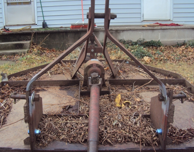

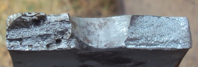

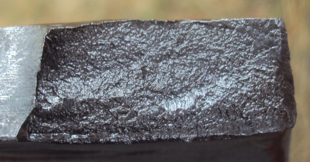

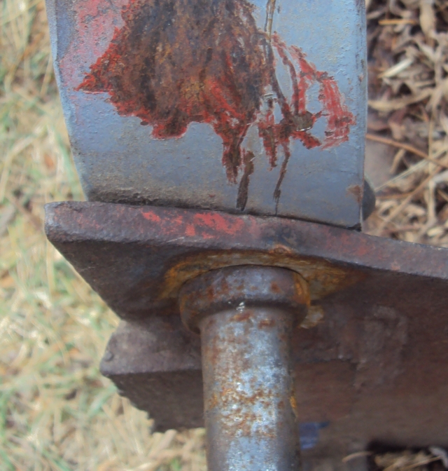

I'm hi-jacking my own thread because while I have all of yours attention, I could really use some advice please.
I've attached pictures to hopefully help out
Problem: Top link arms have broken in half (Front View)
Compounding Problem: I'm not quite sure what kind of metal I'm dealing with (Metal Identification) (Break)
Tried: I cleaned everything up, really chamfered pieces at break (while chamfering, sparks lead me to believe I was working with Cast Steel or mild steel, now I'm leaning towards Cast Iron), welded back up with 6011 rod, did not preheat prior to welding, held for 6 or so hours of hard use then reverted to previous state (broken)
Questions: Am I correct in thinking that I am now dealing with Cast Iron? What rod is best: Ni-55, Ni-99, or S.S. 312, or something else? If cast, how hot am I aiming to heat area before welding? I have no Sand Box for slow cooling, what else that is simple will work? What is the best way to reinforce the break? I've thought about welding washer to front and back side, yeah or nay? I also thought about laying a bead of 312 along arm and upright bracket, yeah or nay? Anyone ever used a rod by KT Industries known as Nomacast and is it (rod) or they (KT Industries) as a supplier of rods any good?
Thank you all for your time and sharing of knowledge.
