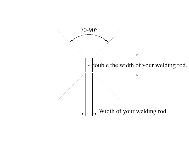

Butt joint preparation.

I need a little further explanation of proper way to bevel.
I double beveled both halves down to a heavy 1/16th of original material touching. My bevel was over 45 degrees as well.
It didn't break in the same place either. It was close but different.
I will definitely use heat this time and go with some 312.
Any comments or suggestions about adding some reinforcements anywhere and how best to accomplish that.

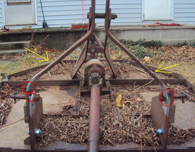

Really you think they used cast steel on a King Kutter brand "Bush Hog"
for the 3 point frame. You might want to look a little closer on what broke
and where it broke. See my modified picture.
Ron I was just going by the picture. But now I too believe they are mild steel, but you got to admit that's some nasty looking steel / break. :confused2:

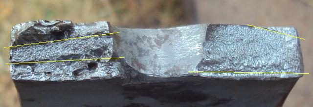

Lack of penetration is the problem very clear in this picture. I see little
evidence of beveling. The yellow lines show the limit of penetration, does
not matter how much preheat, fancy super duper rod or post heat you use.
You have lack of fusion, it will fail.

Shade Tree Welder or anyone else,
I gather from your comment, I produced a 'cold' weld, which is highly possible.
With 1/8th inch 312 rod, what would you say amperage-wise I should be using?
Do not use stainless rod 6011 will be perfect for this
repair 90-100 amps for 1/8".
