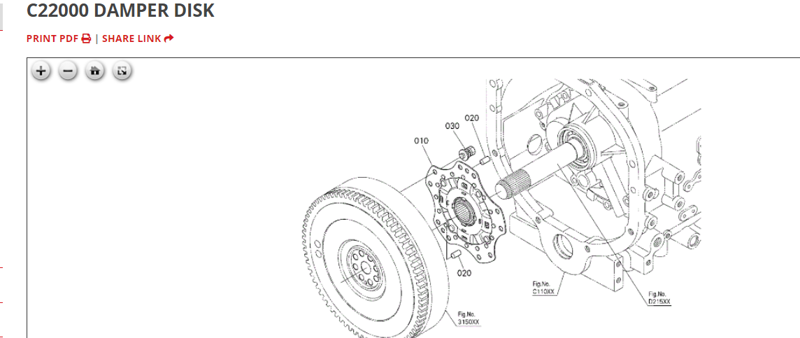

I have had this tractor(bought new) since 2016, and a lot of my use is mowing/shredding pastures.
I pull a 15' modern ag shredder. It weighs 5600 lbs, with a tongue weight of 1800 lbs.
I know,,,the 7060 is borderline for this cutter, but the ground is so rough I have to go slow anyhow, and seldom bog the tractor if I'm paying attention. I am normally running the tractor at 2000 to 2150 rpm, in 4th gear, low range . I have some areas where I need to go forward and back a few times. I put shuttle lever in neutral(the tractor stops immediately), shift to 2nd or 3rd gear, put shuttle lever to Reverse, and back up...Put shuttle lever to neutral, shift to 4 low, put shuttle lever to forward and the tractor "lunges" harder than is healthy for the tractor or cutter. So, since the "pedal" and the "lever" serve the same function, I have found that using the pedal to "modulate" the application of pressure to the clutch packs results is a much smoother "launch" back to forward mowing speed. I don't "ride" the pedal, I just let it engage the clutch packs a bit more gradually than the lever which "dumps" the pressure all at once..This seems to be the easiest on the equipment AND ME :)

I think your confused when you stated "damper clutch vs. wet clutch packs". A Kubota M7060 with hyd shuttle has both damper & hyd(wet) clutch packs so there's "no versus involved". IMHO one should lower engine rpm's before shifting hyd shuttle from fwd to rev & vice-versa. The higher engine & ground speed PLUS WEIGHT OF tractor & batwing exerts tremendous strain on the damper hub & springs. I think you continue your shuttle shifting practice & the hub & springs in damper clutch will prematurely fail.
My M7040 with similar hyd shuttle has over 1750 hrs & has been used to handle many 100's of rd bales &"knock on wood" the hyd reverser shifts fine at lower engine rpm's. My M7040 operators manual clearly states to shift hyd reverser while tractor is moving slower.

Kubota hydraulic shuttles all have a proportioning sensing vale that senses impending load and modulates the speed and lockup pressure of the wet travelling pack in the case. That is what you feel and like Jim states, I'd reduce the engine rpm appreciably with reversing with the shuttle lever to mitigate the shock load on the damper plate in the bellhousing when pulling the heavy shredder. If you have the WSM, it calls out how to adjust both the lockup pressure as well as the lockup time but you'll need some special tools to accomplish that. I've never adjusted mine in 6500 meter hours.
