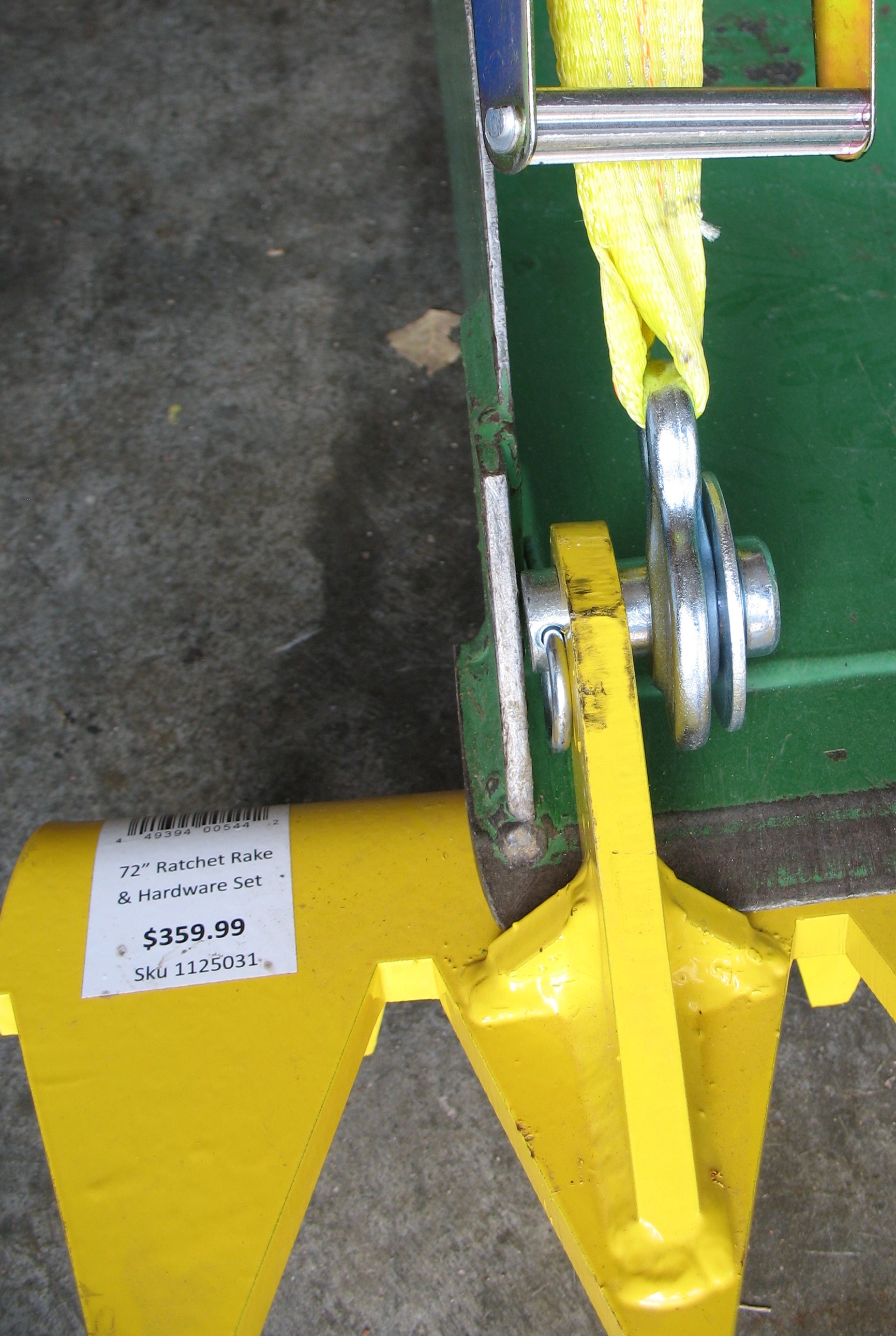

Picked-up the only one in stock at their "TSC" Sioux Falls, SD location. I have a JD 419 FEL for my 04' JD790, the bucket inside dimension is 61" so I'll be looking at the strap hooks in the spring (have JD59 attached at the moment)since some posts suggest you really need a total of 61.5" for clearance. Having not really looked at it, perhaps I can attach something like a chain shackle with a screw pin to each outer bracket then go from there to achieve clearance enough for the hooks......thumbsup:
Today I took off the JD59 Front end snowblower (used once this season) and mounted the Rachet Rake. Since I didn't have clearance for the strap hook to fasten into the mounting bracket hole I simply installed a 1" x 2-1/2" Zinc Finish Clevis Pin to provide a mounting area for the hook (Fastenal Part No.0156795) + a washer and retaining pin. WORKS GREAT !!:thumbsup:
Very Clever! :thumbsup:

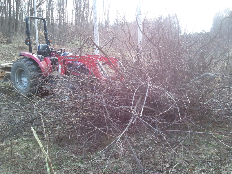

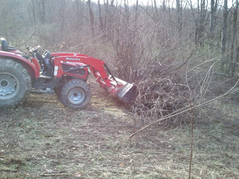

Pushing some brush with the RR.
