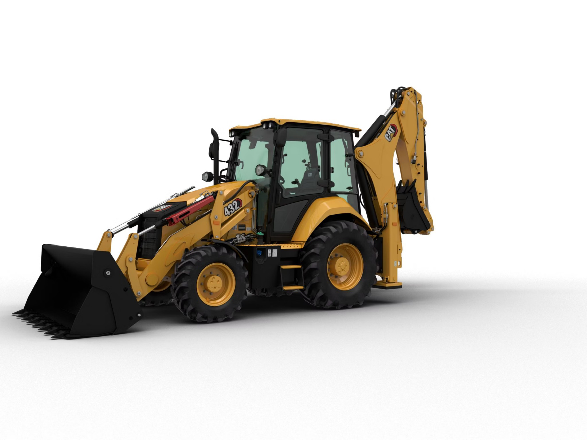

Morning folks..
I'm retired and want to build a garage with a apartment myself.. I used to do hvac and maintenance so I know a little about construction and Ive been reading.. No building inspections in my remote area of Iowa.
So I'm going back and forth about what machine would be the most versatile on my tiny acreage.. I think the skid (Case 95XT) would build a stick built garage faster and fit into small areas, but that the back hoe tractor (Case 580 4x4) could do more, but slower, bigger.. But it has a backhoe and a bucket..
I'm probably wrong about this but picked two machines that use the 4bt engine I like..
Opinions? Real life experiences?
Thanks!
I would take the loader/backhoe, whether it is fixed center pivot or 3 point (with subframe) 4x4 is a must over a skid steer. I have a smaller loader with 3 point (subframe) backhoe and I have not regretted the extra cost. If I were ever to go larger, I would take either a center or side shift

Get your self a self a 360 digger, it will be a decision you will never regret. It is rare that ours is not in use most days.

Buy the skid steer. With attachments that you can buy or rent, it can do almost anything. They work well in tight spaces and Lou can do precision work. On
Rent a small track excavator, vs the backhoe. They have much better maneuverability than a tractor-mounted hoe. When you have finished digging footers you can send it back and it’s someone else’s to feed and maintain. Also, rent trencher for underground lines, they’re faster, more accurate depth and make less work to backfill and compact.

I suggest the backhoe with a hydraulic thumb would give you long term assistance. One step further would be the backhoe as an attachment to a wheeled tractor with a three point hitch and quick attach front loader. I built a 3300 sf post and beam house using a Kubota L48 with that combination plus: front loader cement mixer, fork crane with remote control winch, snow plow, grapple, York rake, & grade blade attachments.

I started out with an old case 480c , got the job done but less you have wide open area to work in
it gets tight quick , added a case sr160 skid steer tons more work done with that machine ,
Best addition was a mini excavator 4 ton . Now that machine gets 80 % of work done .
If I got the mini x first would never had added a backhoe .Only time backhoe gets used is if I need the lifting power of it .

. . . Looks like they put allot of stress on the three point too.
A little late to this conversation, but . . . A "real" TLB does not attach the BH to the 3pt hitch. They are "frame mounted", but usually still removable.
Avoid 3pt hitch backhoe's like the plague. Fragile, sloppy and dangerous. IMHO.
