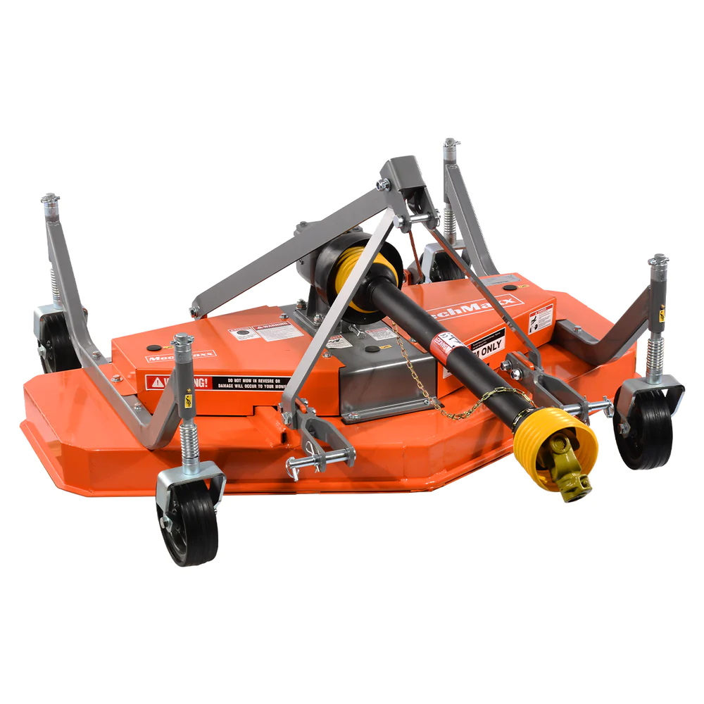

For a mower for a tractor you don't need a belly mower you have
a choice of this pictured below or a brush hog instead of belly mower
willy
