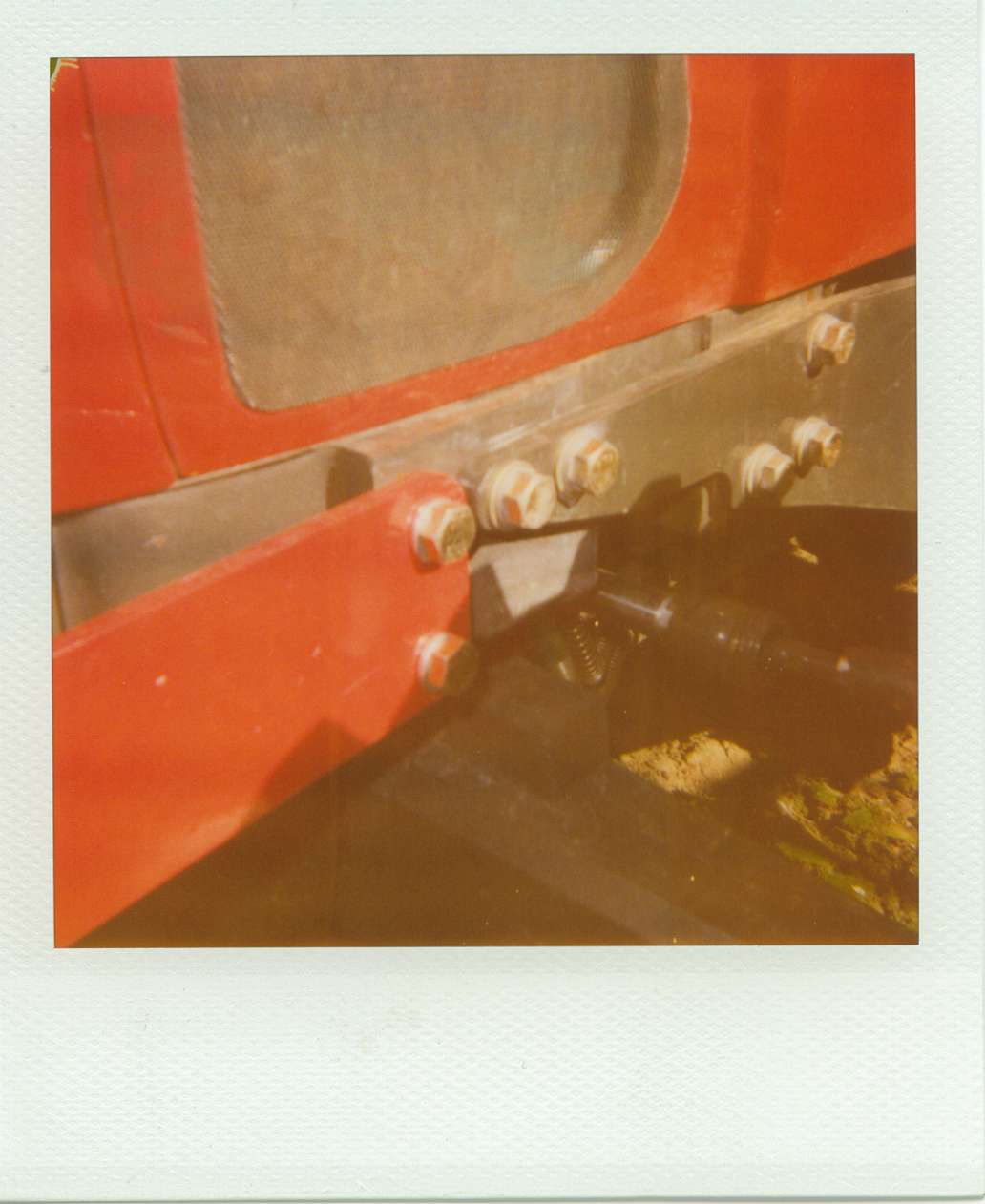

My short term memory strikes again. I should have gone back to my post about it last spring. The 275 loader guard is different from the 276 which is what I have. The 276 loader grill guard is part number 1590-2053.
According to my 276 manual, the loader is the same base loader as the 275 but moved forward to clear the new front axle?
Brandi, I feel the same way about the bolt setup. I figure that if I hit something hard enough to do that, I may just have other thoughts on my mind then of scratching the grill work, ha!

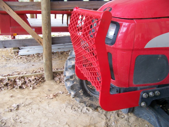

I forgot to take my camera:(, but the owner at Top Flight lent me his ancient polaroid camera:D. The 7520 engine casting is wider than a 6520. When a 6520 doesn't have a grill guard installed, but has a loader, a 1/2 inch thick shim plate is installed where my grill guard mounts. I have to loosen all 7 (see left photo) forward loader frame bolts to install my grill guard. If I had a 7520 I would weld a 1/2 inch plate over the area of the forward holes ON the grill guard and then you can have 4 bolts for the grill guard, but they would be two different lengths. I forgot to detail the front axle, but I think the 6520 and 7520 has the same axle, thus the same deminsions.
