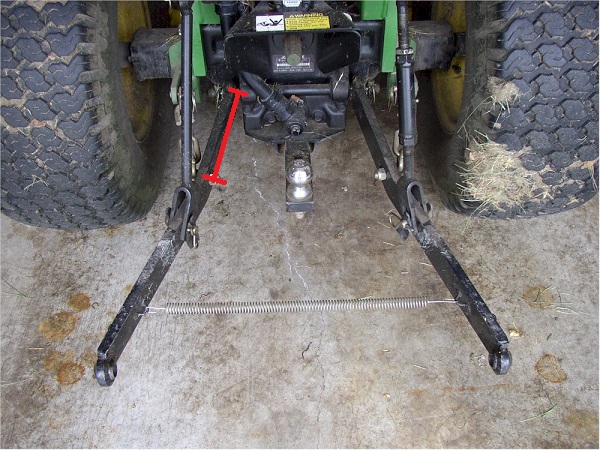

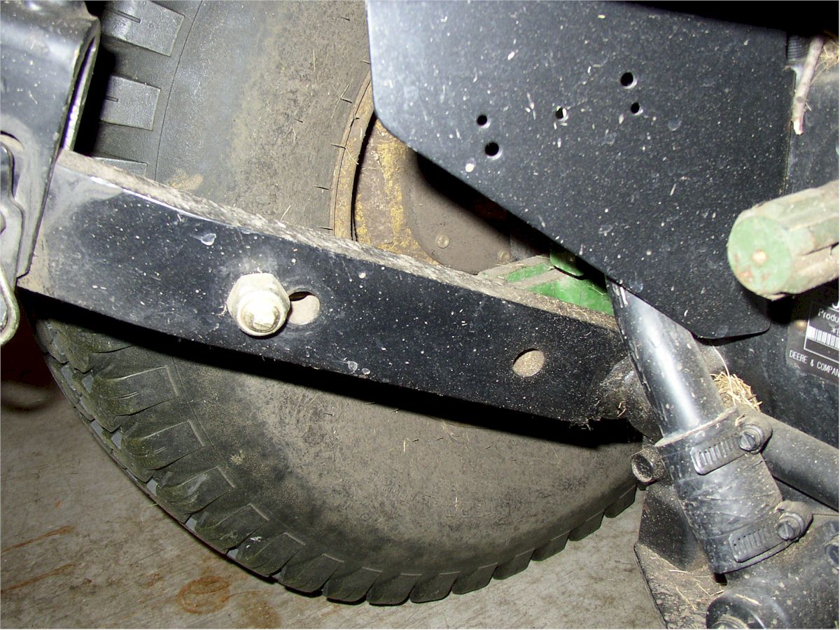

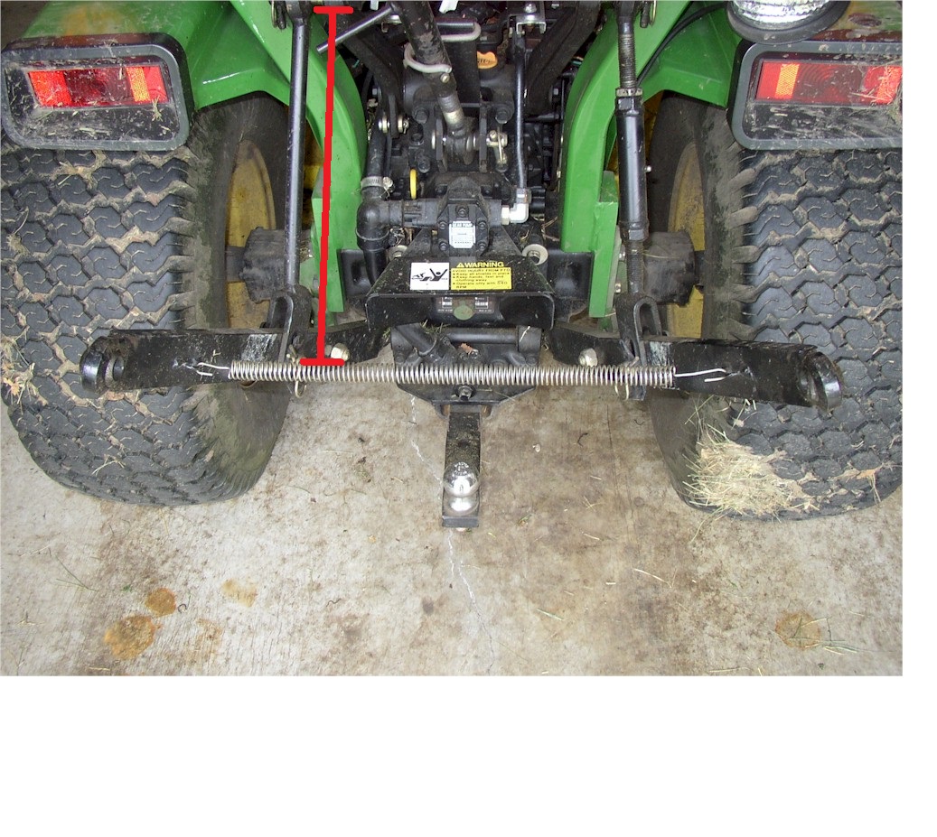

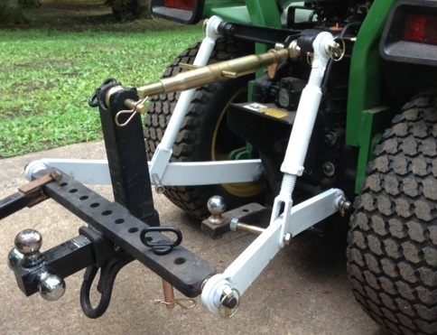

Jul 28, 2013 / 755 855 955 3PH question #21 T tachnem Member Joined Sep 29, 2008 Messages 35 Location NOVA Tractor a ford and a deere Hoping for one more measurement if it isn't too much trouble?! Center to center from the front draft arm ball socket to the stabilizer hole: Getting there... Just need to get the stabilizers setup and finish painting. Have about $60 and probably 10hrs into it so far.
Jul 29, 2013 / 755 855 955 3PH question #22 JD755 Platinum Member Joined Aug 16, 2009 Messages 920 Location Kansas Tractor John Deere 755 purchased new in 1993 Glad to help. That dimension is 8.5 inches. If you are wondering, the nearby hole is one inch less but I think would be too short for the adjustable chain. Not sure of the reason for the extra holes. Attachments 3ph2.jpg 215.4 KB · Views: 175 3ph1.jpg 231.6 KB · Views: 172
