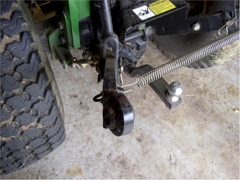

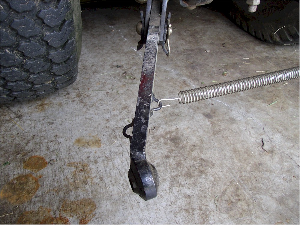

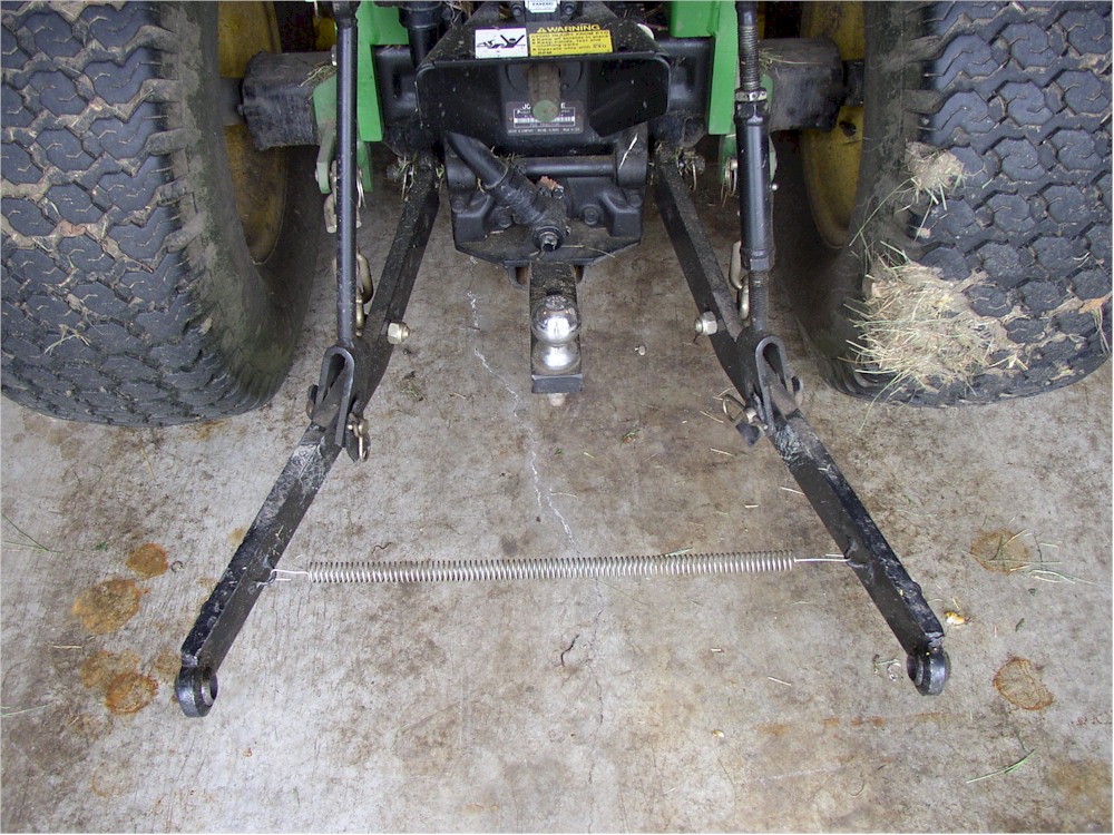

As shown in attachments, my standard style draft arms are perfectly vertical in up or down positions. The end links, because they are in a different plane, are only vertical when in the down position. It may mean nothing, but JD did change part numbers for the draft arms at one time, although that new number is now shown for both style lifts. The drawings, again not always completely accurate, do show different sets of holes between the two types. Your draft arms look to be the same as mine.
Late model 755 tractors advertised a higher lift capacity than early ones. 1005 vs 785 pounds at 24 inches behind the end links. I never knew how they did that, but perhaps there is simply a different geometry with where the lift links attach. My draft arms are 25 inches long between link centers, and the lift links attach 12 inches back from the end link centers. The JD Parts drawing for the Hi Lift seems to show two sets of draft arm holes vs my one set for different lift link mounting. Maybe you have a mismatch between your draft arms and lift links, and need that other hole position.
I measured the lift for my draft arms. They are 30.5 inches in float position, and 32.5 in non-float position. A different set of holes could provide increased lift, but then maybe my draft arms would not line up vertically.
After all that, I will just say do what ever positions the draft arms as vertical as possible with what you have.

As shown in attachments, my standard style draft arms are perfectly vertical in up or down positions. The end links, because they are in a different plane, are only vertical when in the down position. .
By end links, you mean on the ends of the draft arms? I'm surprised they are in a different plane. It does look like it in your photos, though.

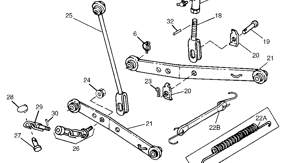

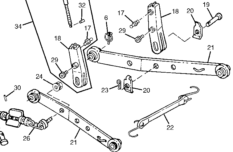

It may mean nothing, but JD did change part numbers for the draft arms at one time, although that new number is now shown for both style lifts. The drawings, again not always completely accurate, do show different sets of holes between the two types. Your draft arms look to be the same as mine. .

There is an issue that I knew I had, but looking at your photos caused me to see how it relates to the question in this thread. My left draft arm is straight. Someone or something took the bend out of it. The other has a bend, but maybe not as much as yours. If they had (more) bend, that would change the geometry, and would probably match up better with the lift links set the stock way. There is really nothing else on mine that can be out of whack, based on what I see.
The previous owner must have beat the heck out of the 3PH stuff in some way or another. Either that or he tried to fix something that wasn't broken, meaning the bend in the arms. There are other signs of abuse/stupidity and dumb mods on the tractor, but fortunately the tractor was tougher than the abuse. I've had it 8 or 9 years, and I'm just now getting around to fixing some of the niggling things he messed up.
I have been meaning to heat the left arm and put the bend back into it. I'd like to get another measurement from you. I'll grab one of your photos and put it into another post. BTW thanks for taking the time to shoot and post those photos. And thanks to the others who have replied too.

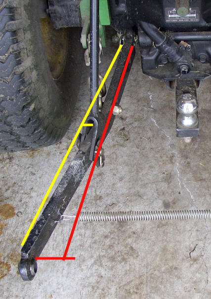

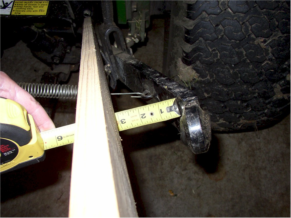

JD755, can you measure the bend for me? Either the distance from the outside yellow line to the center of the bend, and/or the offset of the end of the bar stock from the orange line running along the front section? See photo. Thanks!

Yes, the end links are the ball mounts on the ends of the draft arms. Referring to my previous post, the second picture is with the arms all the way down. You can see the end link is angled in to line up parallel with the end link on the other draft arm. The first picture is with the arms up, and the end link looks tilted because it is. If the end link in that first picture had been angled at a 90 degree bend instead of the small angle it is, it would be approaching horizontal at full lift while the long part of the draft arm would still be vertical.
It does sound like there is something strangely wrong with your draft arms. I measured the offset you requested and it is 3 and 1/8 inches. The camera position makes the board look warped, but it really is straight.

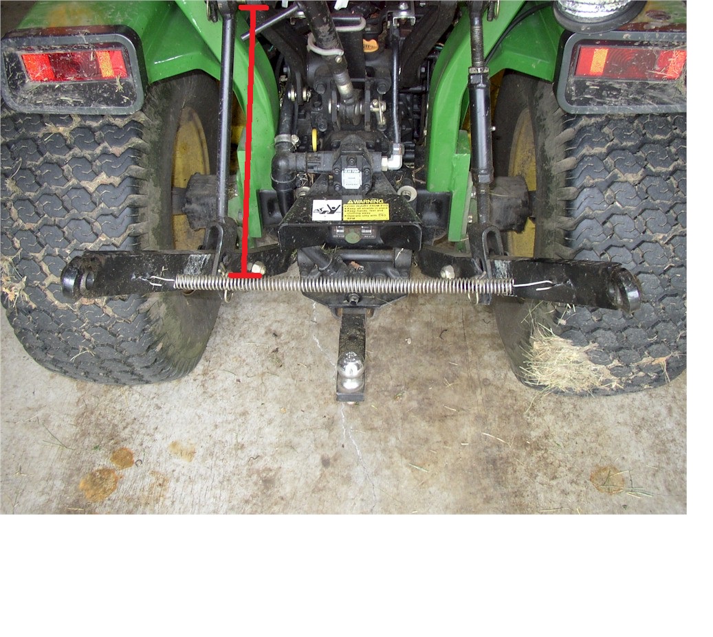

Can anyone tell me the eye-eye length of the fixed lift arm on the 655/755/855? Thanks!
/ 755 855 955 3PH question #17
The eye to eye length along the bent arm lower draft links measured with a tape measure is close to 26 inches. My adjustable top link is currently set at 23 inches. Hope this answers your question.
/ 755 855 955 3PH question #18
That is helpful, though I am specifically looking for the distance in red. Thanks!
/ 755 855 955 3PH question #19
OK. I wasn't sure before which dimension you wanted. That dimension is 17 inches.
