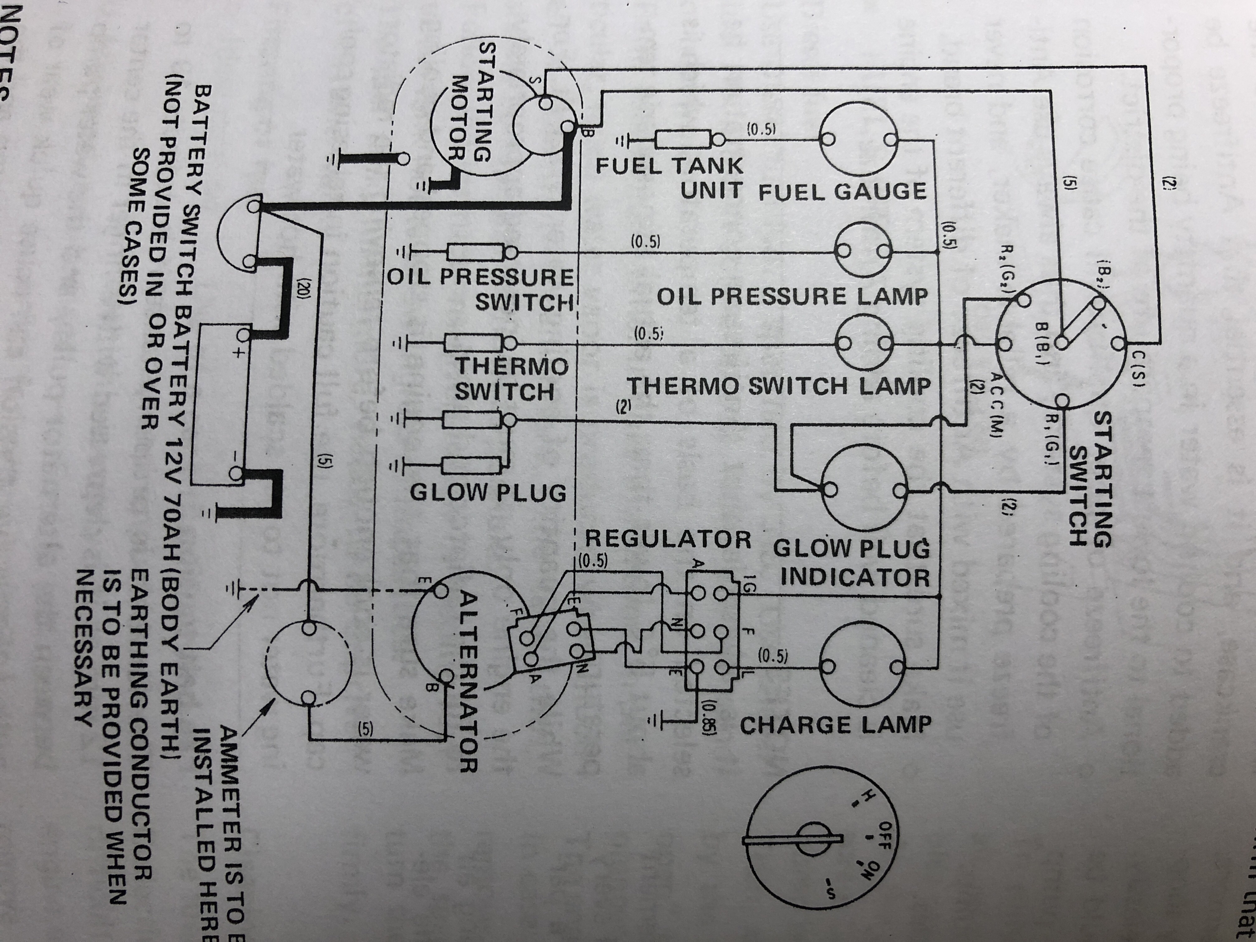

My diagram shows 4 connections used on the stock switch and I have 6 on the replacement and theyre all labeled differently than the diagram. On the new switch I have R1, R2, BR, ACC, C, and B the diagram has labels AC, 50, 170, 300, and what looks like 19 or 49. AC goes to the voltage regulator and the headlights (accessory), 50 isnt used, 170 goes to the S on the starter, 300 goes to the +battery, B on the generator, and the + side of the starter, and 19 or 49 goes to AV2 on the glow plug indicator and eventually the glow plugs.
On the new switch Im guessing:
C is common and should be matched to the 170 wire to the negative side of the starter?
ACC is accessory and matched to AC wire
B is (who knows, maybe bias?) and matches B on the generator.
Just not sure which one glow plugs go to.

Found this one in the repair manual and it makes much more sense. I see where youre talking about the indicator in the circuit.
   / 77 Satoh Beaver S370D wont start, low compression #18
You'll probably have to map out the new switch with a multi-meter and adapt it to the diagram the best you can. Some switches don't have provisions for glow plugs which makes for a real headache.

I used the second diagram and it makes a lot of sense to me and its easy to follow. Traced out all the wires to make sure theyre going to where the diagram says they should go and its all correct so I changed the switch. There were a lot of wires spliced together with twisting the wires together and electrical taped, then the whole loom electrical taped so no one can see how horrible of a wiring job it was. I rewired with all new thicker wires except for the ACC circuit, there was just too much going on there and I dont need it to start the engine. It will definitely be looked at after I get the starting issue resolved, and when its not raining, and Im not hunched over the engine with a tarp on my head. Also put the glow plug indicator back in the circuit the way its supposed to be and it works, so thats awesome. Unfortunately the tractor is still not starting, but it sounds more like its going to start than before. The only thing I can think of is the battery is too weak. I topped off the last cell with water when I got home and it charged for 2 hours befods I tried to start it. I also have yet to retest the compression, it got dark and it was dinner time so that will be done tomorrow.
