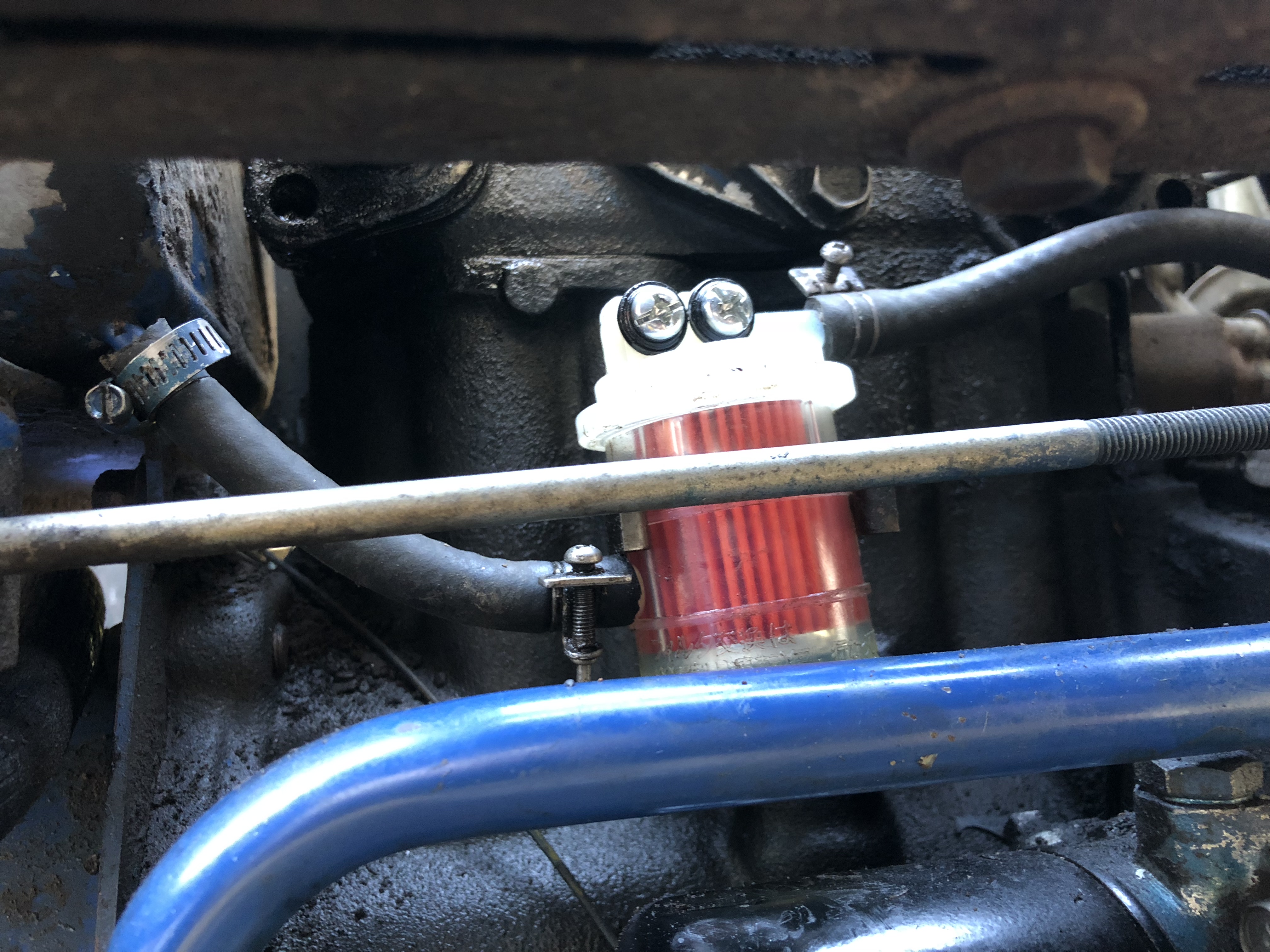

Heres the pictures of fuel system and ignition rewiring. The wires are thicker than what was there and I didnt have a variety of wire colors, but I did have a variety of electrical tape to wrap them in.

Fuel filter and new hoses from the tank

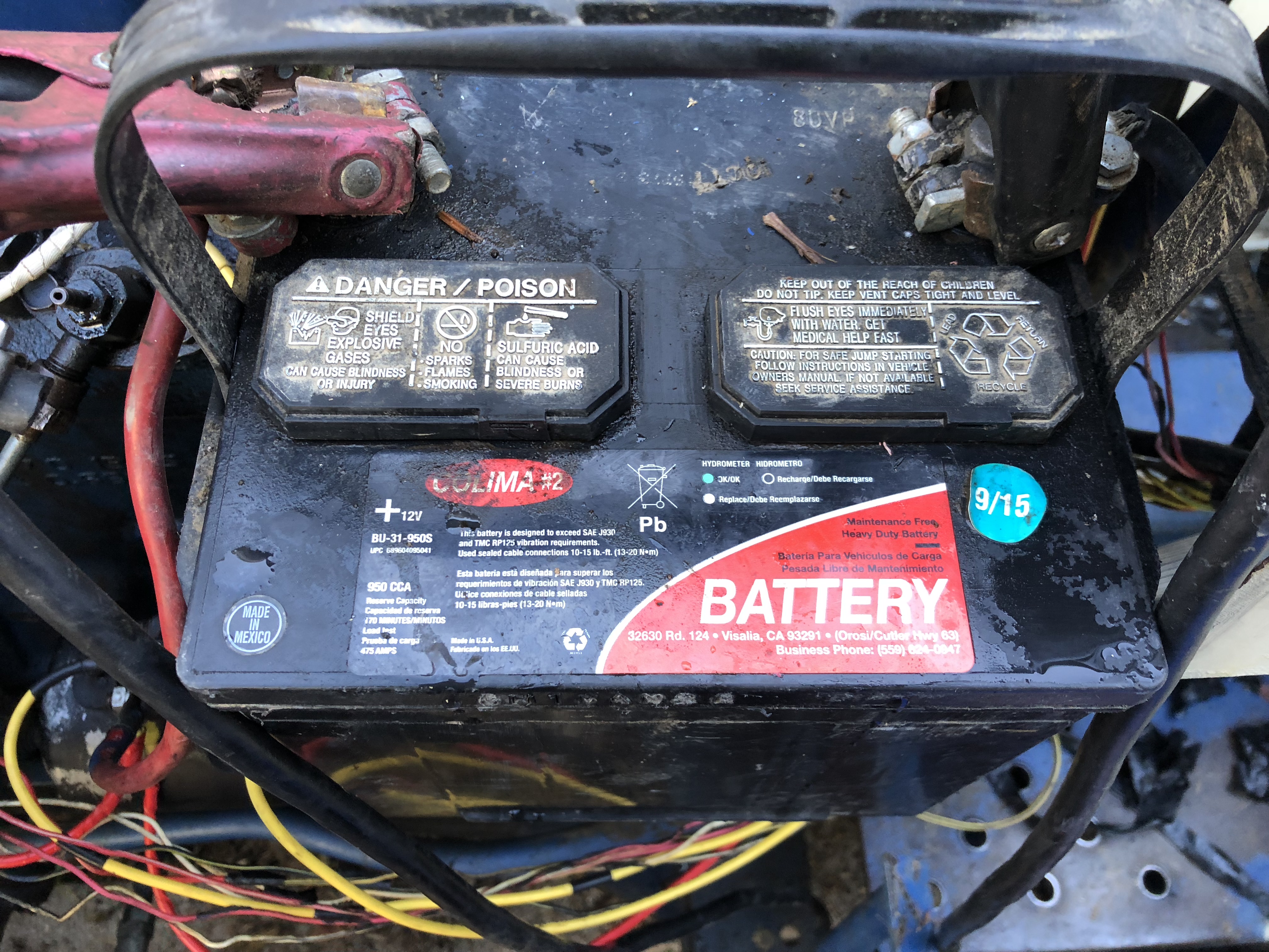

Battery dated 9/15, topped off with distilled water and connected to charger/jumper.

Id say the battery needs to be replaced, Im missing the battery clamp on mine and its a liitle wider than stock because the hood has trouble cosing around it. Anyone know the correct battery part number or at least the dimensions? I was also thinking injectors could be taken out and soaked in something for a while, but what? Whats the proper way to deep clean an injector, or is it a rebuild only type of deal? Battery cables are at least a 4 gauge, but looks like 2 gauge. They look a little raggity, so they might need an update to some bigger stuff at a later date. Id like to install an onboard inverter, as a cheap alternative to a generator. I know the cranking speeds are low, and I think its mostly the battery it dies quickly even plugged in when I crank for 2 or 3 times. Maybe Ill pull my optima from my ford escape and try that out. The escape is one of the broke down cars, but I've got it on a trickle charger.

I wish you could snap/post a picture of your fuel system set-up.. w/ a pic. I might be able to tell you how to hack into the fuel system.

I have never owned a 2 cylinder Mitsubishi but have had several 3 & 4 cylinder models, the 3 cylinder models are very hard to start with slow cranking speeds, even at moderately warm temps. The video indicates your's are very slow. You may just find that a new battery will correct your no start issue. Pay no attention to the inlaws, the day will come when they want you to use your awesome little 370 to do some work for them..... "Come what may, all bad fortune is to be conquered by endurance". Virgil

A jump start should get you going. Same rules apply for jumper cables as the battery cables - 2 gauge or better. If you are careful you can clamp directly to the + starter lug bypassing the + battery terminal. Same strategy for ground. No use forcing more through what could already be taxed battery leads.

I retested compression the correct way with injectors unhooked and throttle all the way forward, i did notice fuel coming out of the injector lines anyway. I tried 2 times with the other plug in and other plug out and got the same readings of 300psi #1 and 355psi #2. A lot less than 455 and 550 as before, but still more than my baseline of 275 and 300. The glow plugs get super hot, but in sunlight I cant tell if theyre white or red or whatecer. They smoke all the diesel off and the top is too hot to hold against the negative side of the battery. I went to swap the optima in and realized my trickle charger was no longer plugged in so that battery is dead too. I put that one on a charge and will take the other one to get it checked at an autoparts store and will probably end up buying a new one. I took measurements for the correct battery at 9.5L, 5W, 7T. Length and width are set by the tray, but the height is variable and could probably fit up to an 8.5-9” tall battery there.
