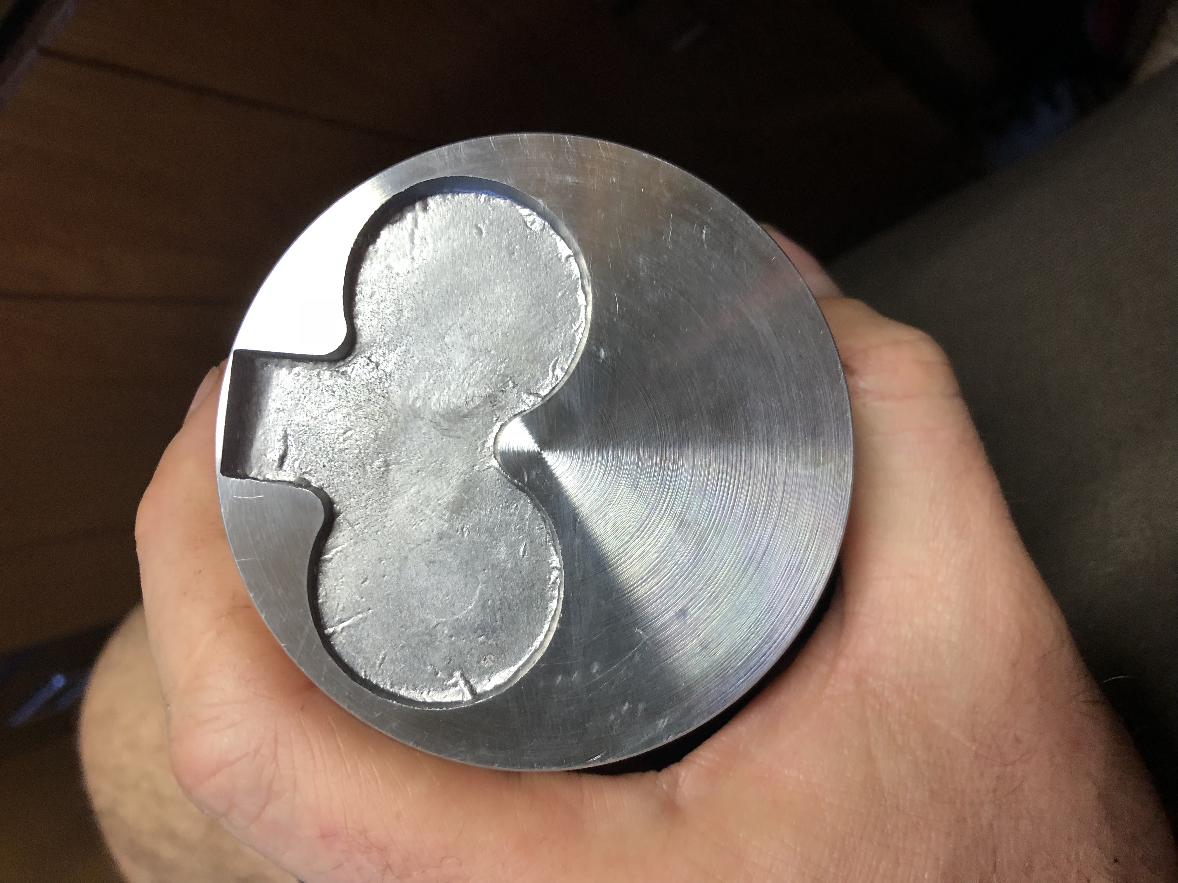

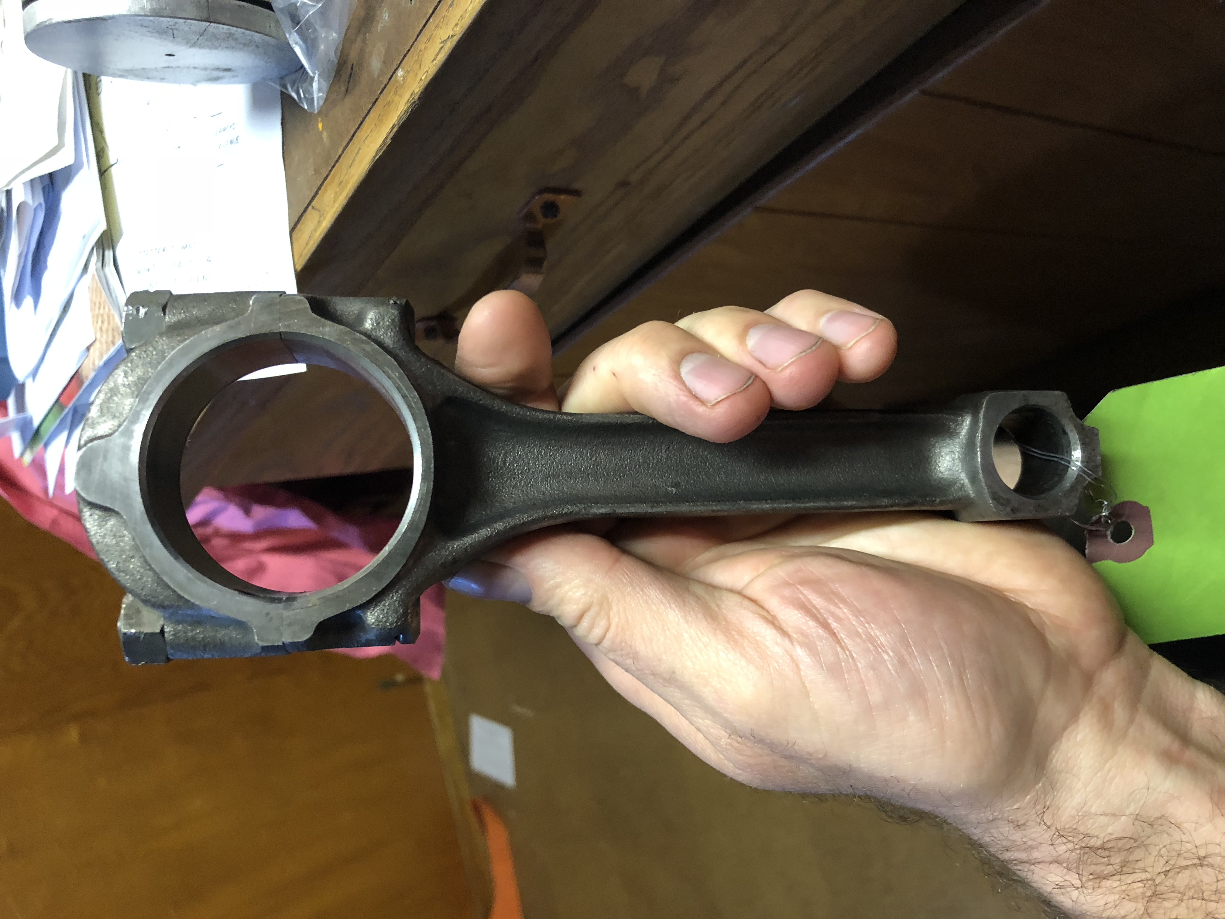

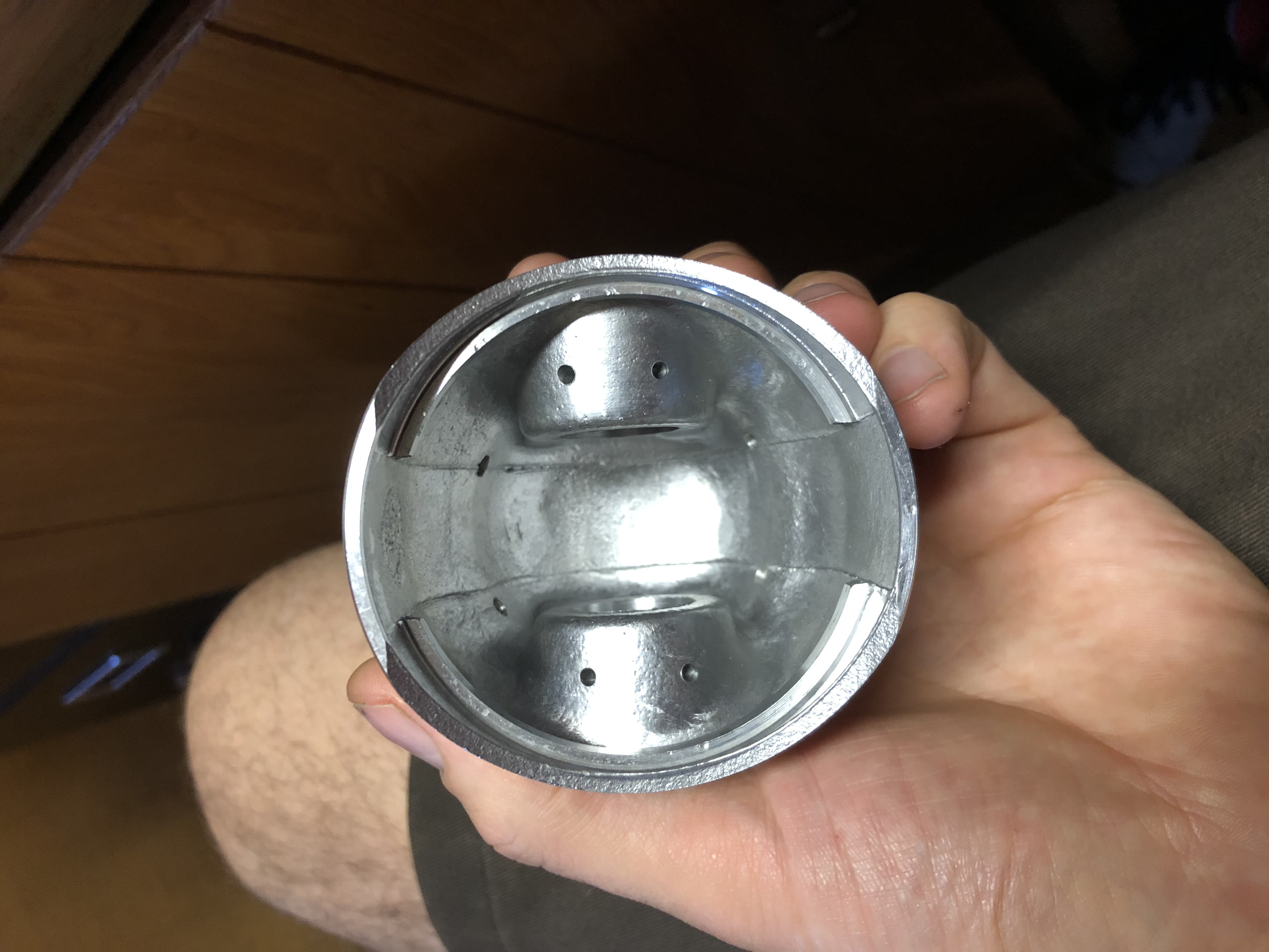

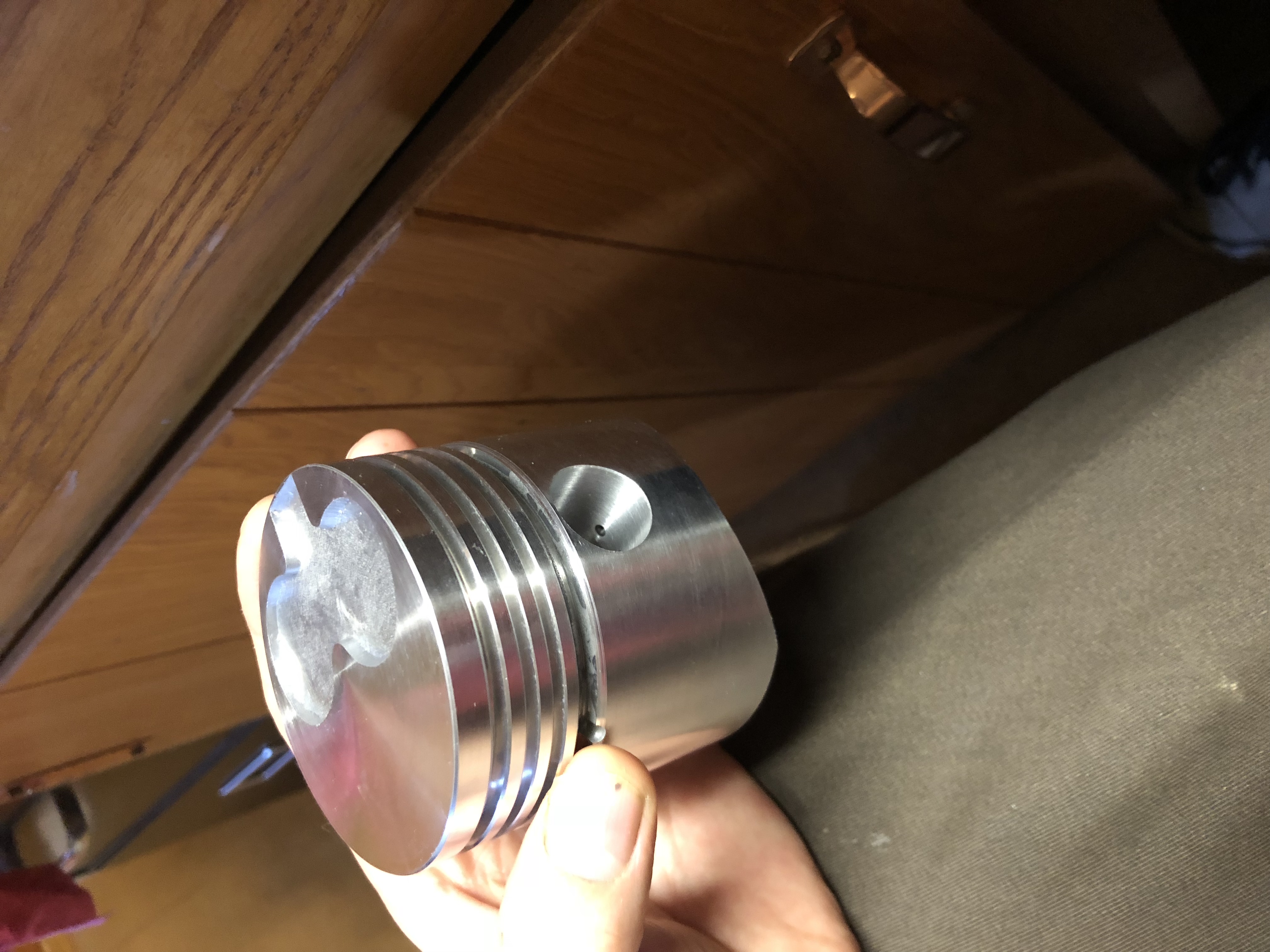

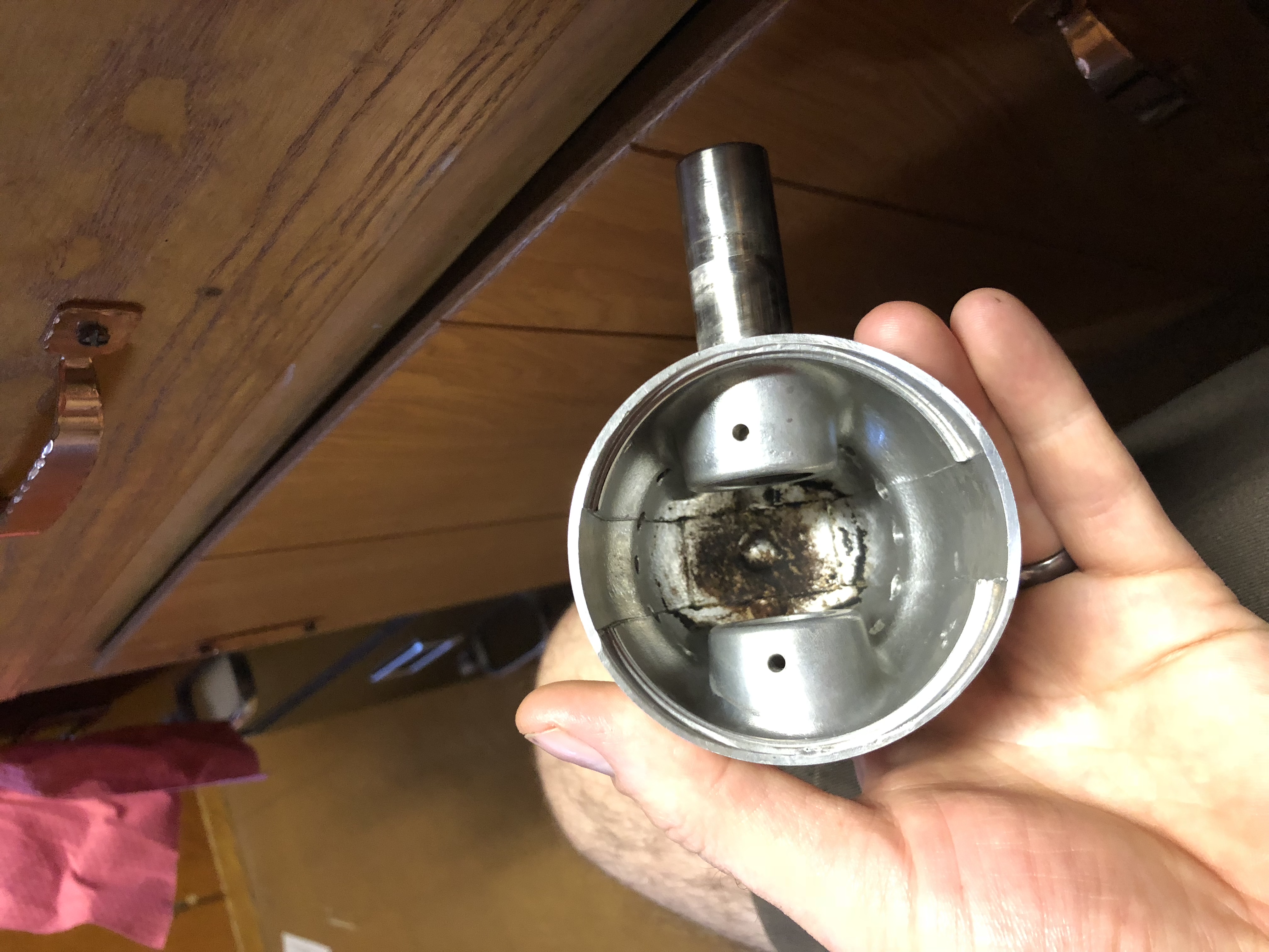

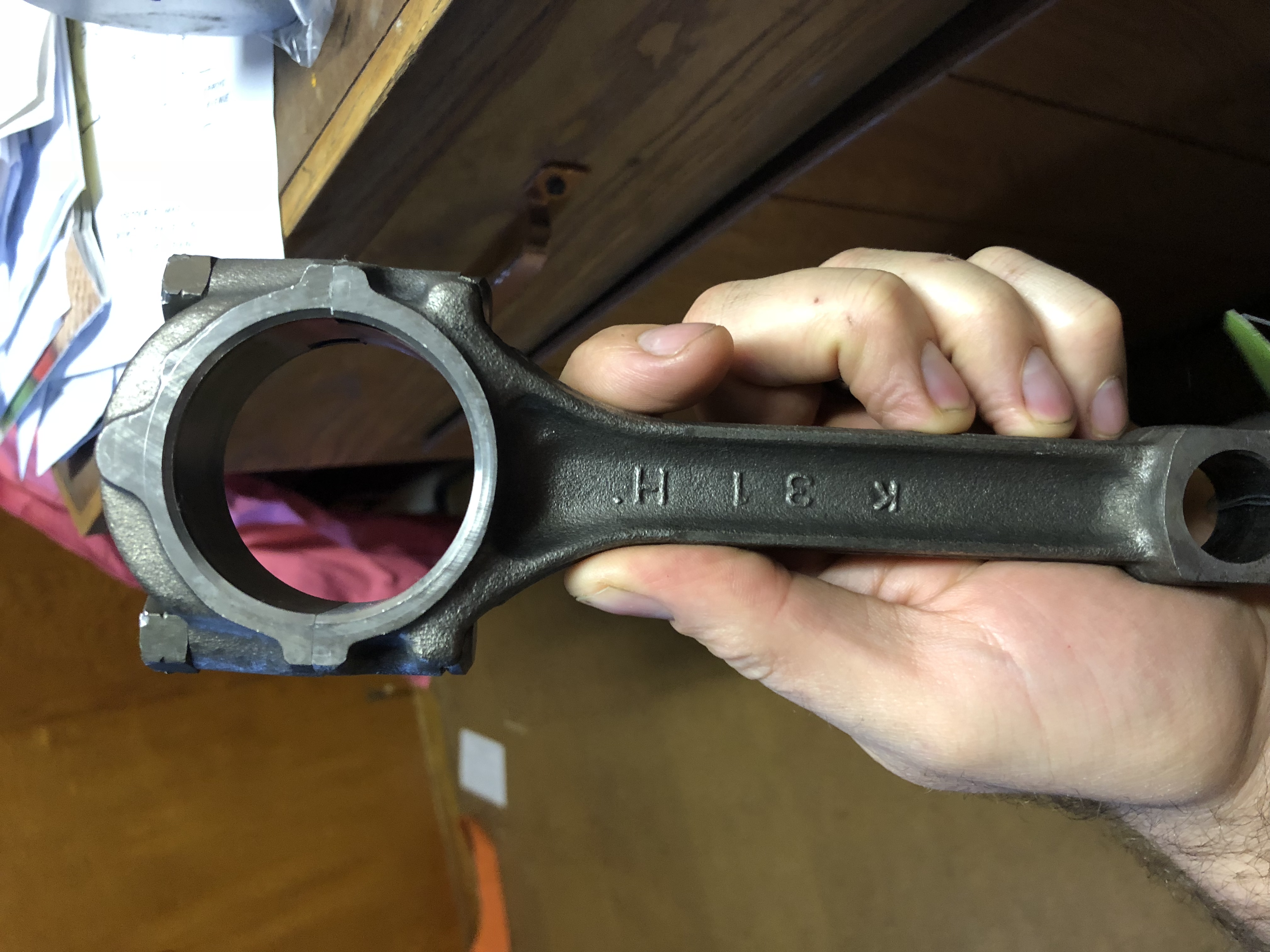

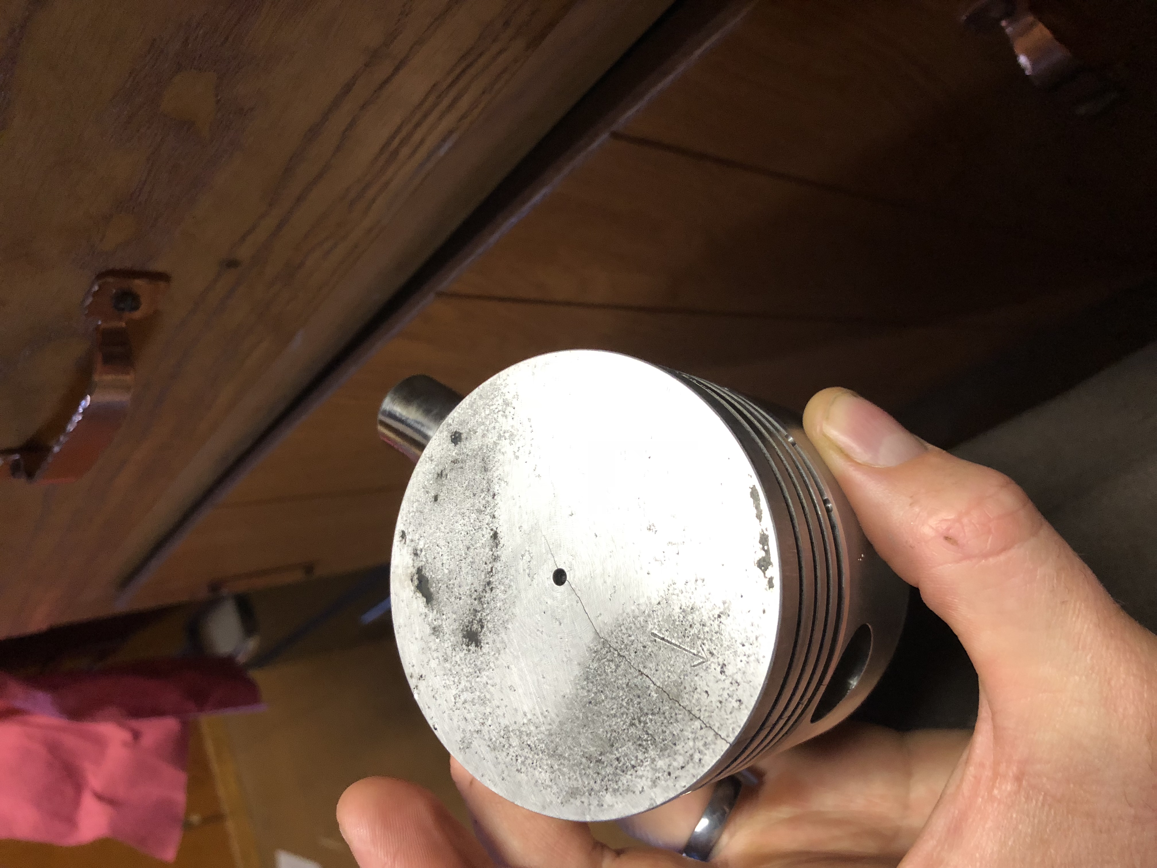

Just got the pistons and gaskets in, and I wanted to head to the machine shop to get the pins pressed in. The only problem is the new pistons dont have arrows on them to point the direction of the front of the engine. Has anyone installed these new style pistons before? I dont see a description of which was is which for the pistons, or rods in my maintenance manual. Any help is appreciated.
New piston top, which way do the reliefs go?
Side view to show orientation of the rod.
Underside of new piston.
Old piston top and side with artow towards front of engine.
Underside of old piston.
Connecting rod side with lettering and nub on the crank side
Back side of rod, no lettering or nubs

So I got some advice from the machine shop, they say rod lettering normally faces the front of the engine, and after reviewing videos of my old pistons attached to the rods thats how they go. The reliefs match up with the valves so they are on the injector side of the engine. My newest problems are the machine shop marred my piston and then cracked it on the side when they were trying to press the pin out. They paid me for the piston, and didnt charge me for pressing the other side correctly. The owners son did the first one and messed it up, but the owner did the second one flawlessly. I told him Id give them a shot at pressing the new one.

Also, I just noticed that the valve reliefs do not line up with the valves. They do not run parallel with the piston pin, is this normal? Both pistons look the same, but they have the same markings in the reliefs (from same casting).

Do those pistons look ok? The relief cut is pretty close to the edge, and the pin is not parallel with the axis of the relief. I saw a set of pistons for a larger bore with the same relief cut, but it was further from the edge. It almost looked like they took that one and milled it down to make this one.

So far I haven't experienced any issues with the relief-type pistons (other than harder than expected starting) but who know what will happen in time. I don't really know why the reliefs are randomly laid out on the piston crown. It would be nice to know the history behind these pistons. Maybe the supplier took flat-top pistons and ran them through a CNC to cut that pattern because it was handy and they knew the orientation didn't matter anyway. I can only speculate. Flat-top pistons are available from other suppliers but at higher cost. Probably worth the difference though.
