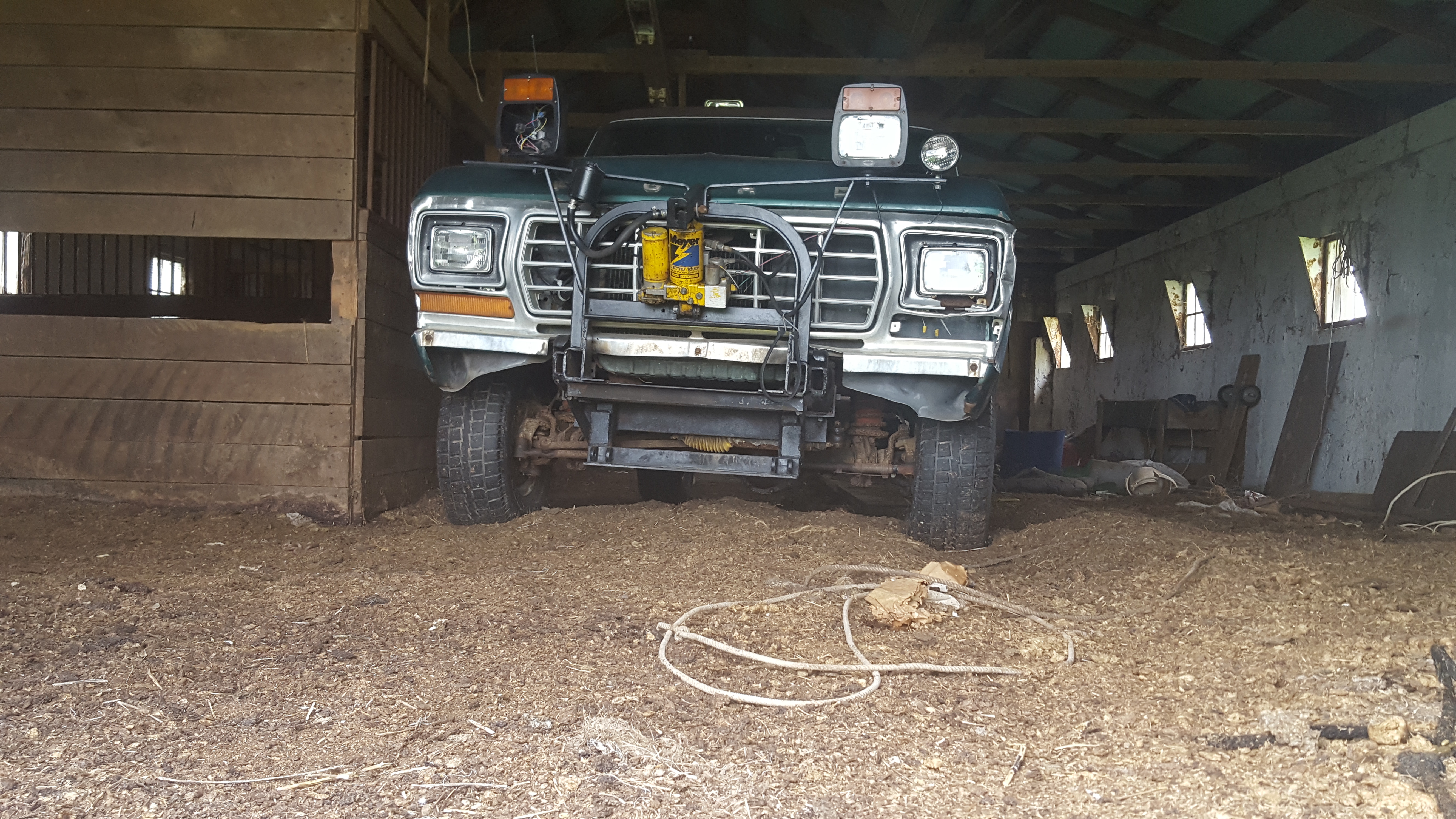

Just a lil update on the truck. Played with it some more and have to have the semi alternator rebuild or buy a new one. That is the only thing now that can be holding the truck up. Hopefully can get it soon before the mud bogs start heavy. Plans is to build a few guards and 3in body lift to put our 33s ground hogs under it 1463250632753.jpg
