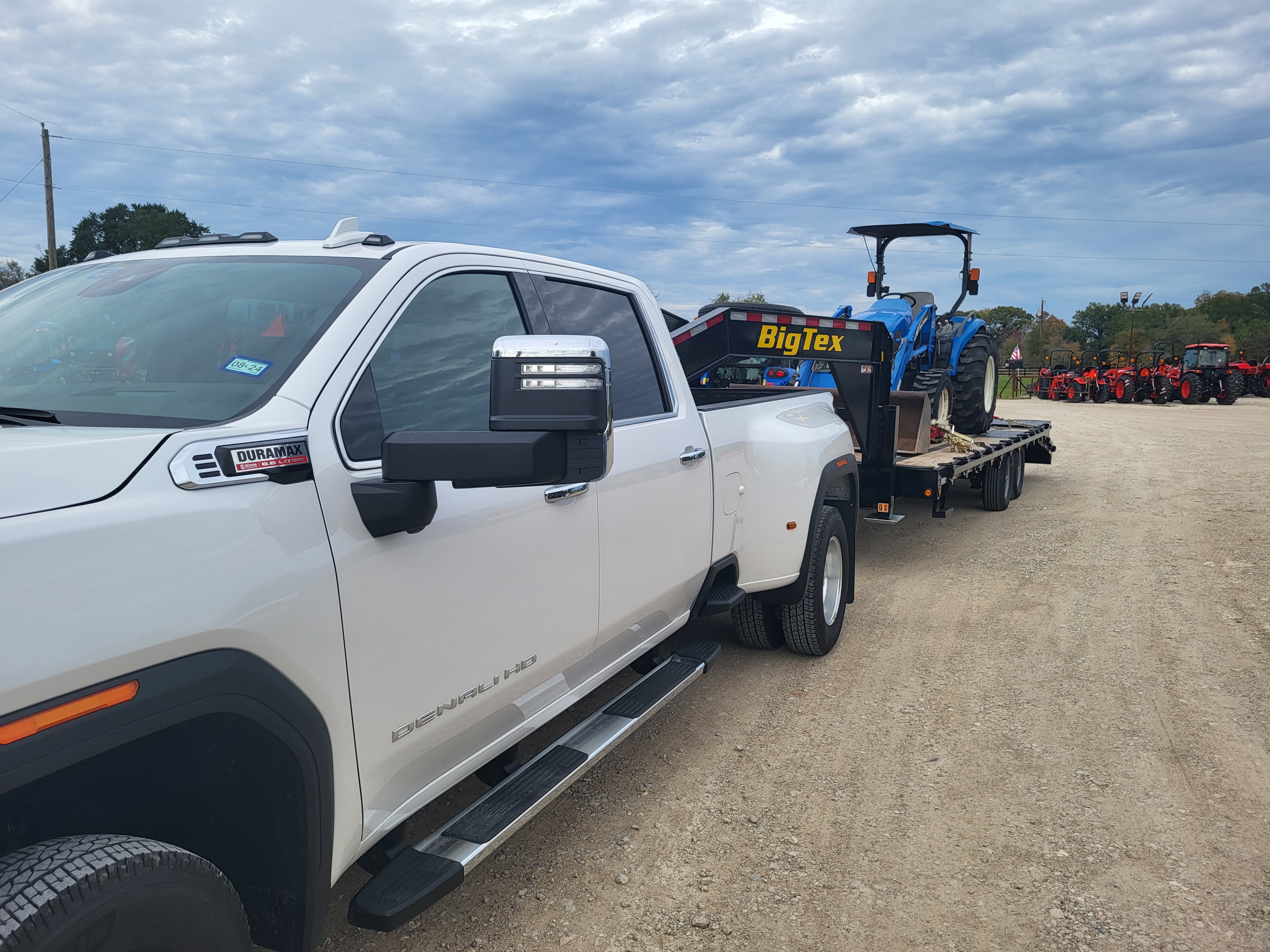

I bought a bigger truck and trailer to haul my tractors. I was using the dealer to pick up tractors until they started jacking up the price to $300 round trip. Plus I needed to haul larger amounts of hay. With my new hay barn the trailer will be out of the weather. Truck goes in the garage. Here is the TC40DA going in for service after a 200 mile round trip to get new tires.
