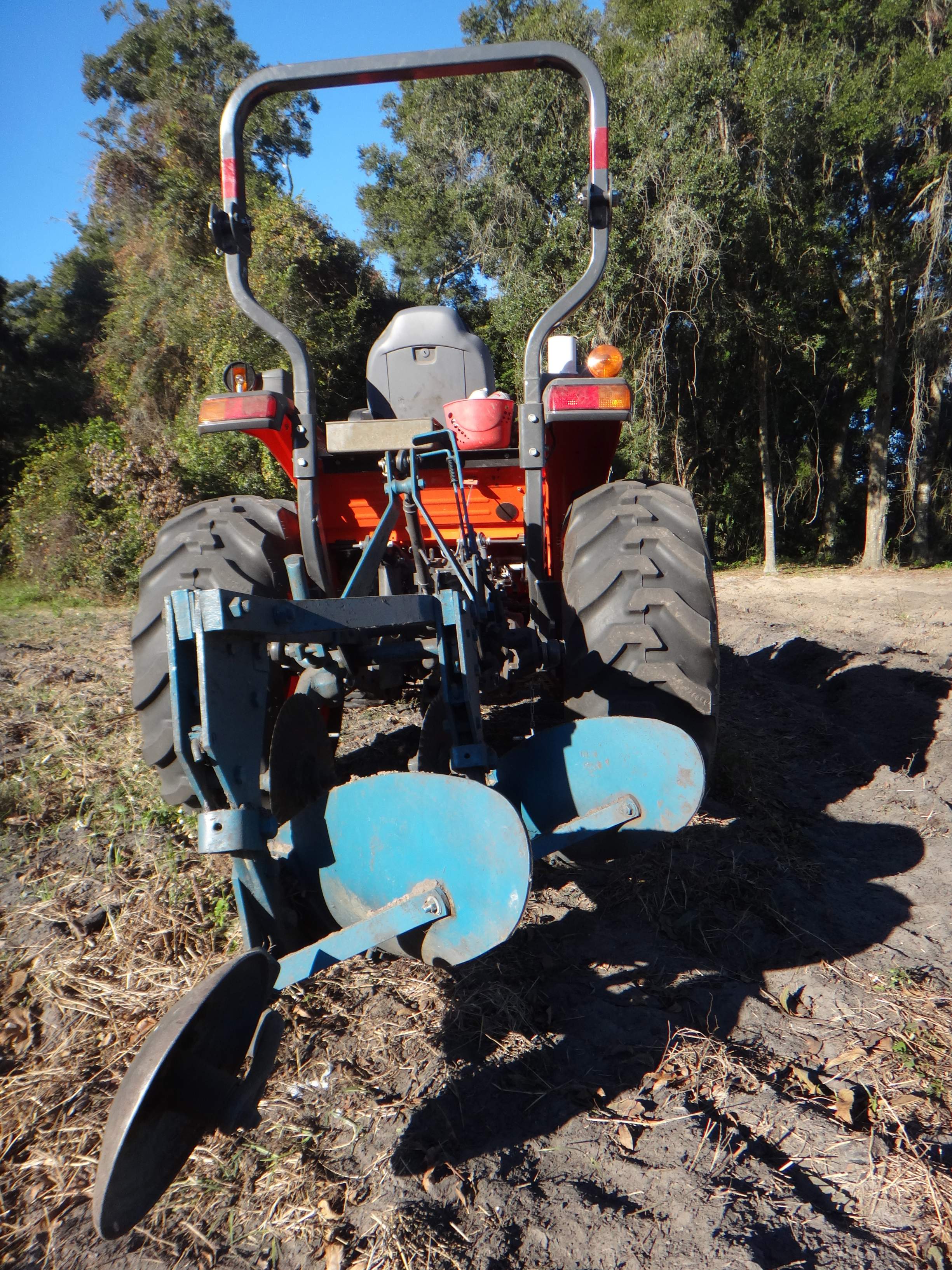

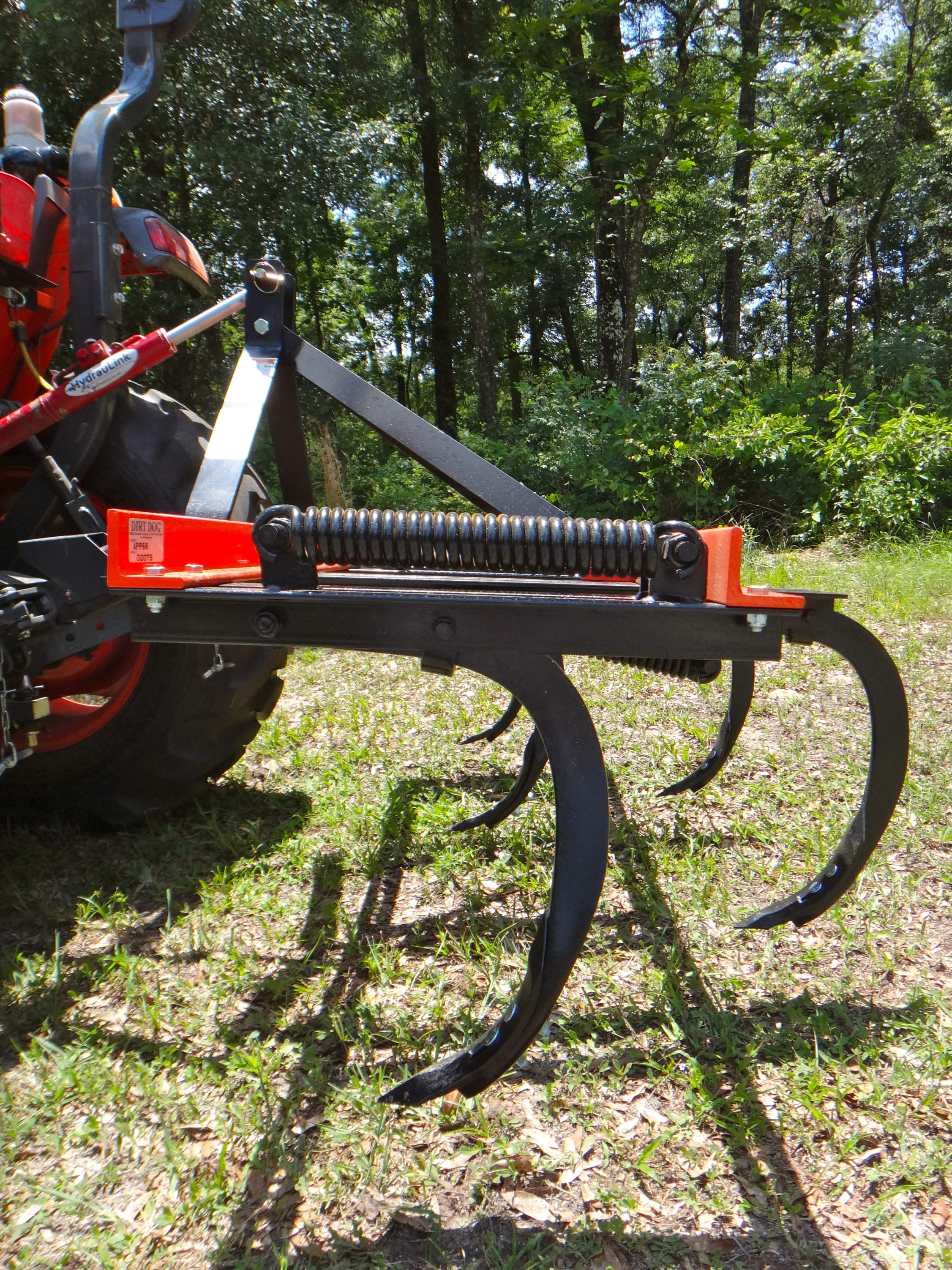

Disc Harrows and PTO powered Roto-tillers are two variations within the tiller category.
I plow land reclaimed from Florida jungle with a Ford 12", two bottom moldboard plow, so a Disc Harrow meets my need for secondary tillage and reducing plow furrows.
When wild grape vines are exceptionally intrusive, after the Bush Hog I go over the land with a Dirt Dog All Purpose Plow / Field Cultivator, to tear out the underground grape vine runners mostly intact, before plowing, then harrowing.
