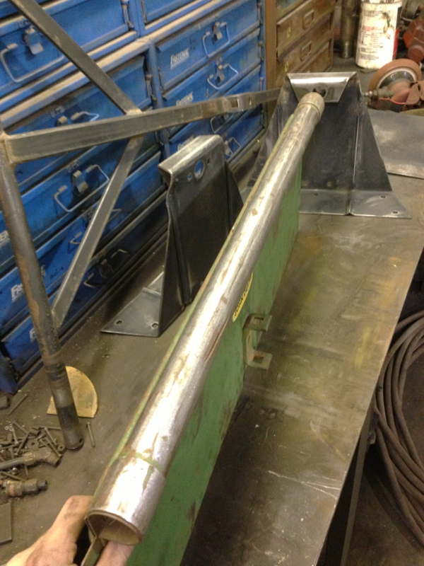

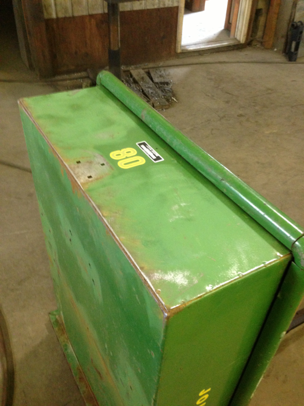

Okay, so most of you know that I have a 317 thats just about done with, so tonight I asked my grandpa if I could get out the 80 to bring it over to our shop to start the process. He said go for it and left for a meeting in town. So I jacked it up, and started to take the tires off but it was 5:00 so me and dad had to go home. I managed to get 1 tire and ril off, and its in overall good condition. Its an aluminum sticker tag with the number 7846, so next week it will turn 34 years old! Heres a pic of what it looked like when I dragged it across the yard. The pic of my hand is where my father extended the hitch to reach the 2210 my grandpa has now.

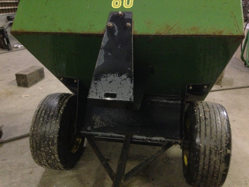

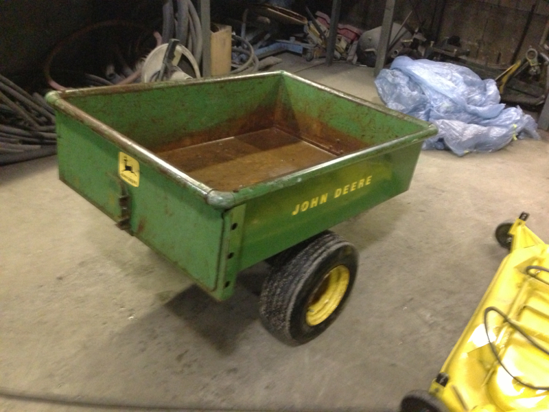

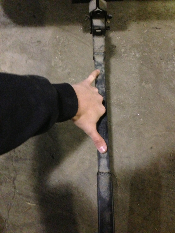

Oh yeah, not a rot hole in it! My dad and his siblings/friends would put this behind their 3 wheeler and i guess gave it a hard romp every time. :/ im glad its in decent shape so all i will have to do is bodywork, and fix the latch for the thing to dump. It trips open if you hit a bump with it and bang hits the ground and drags.

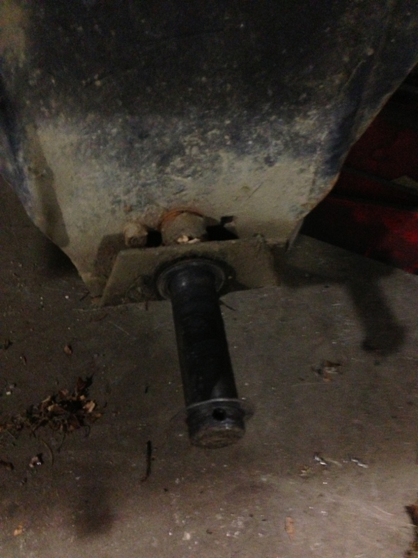

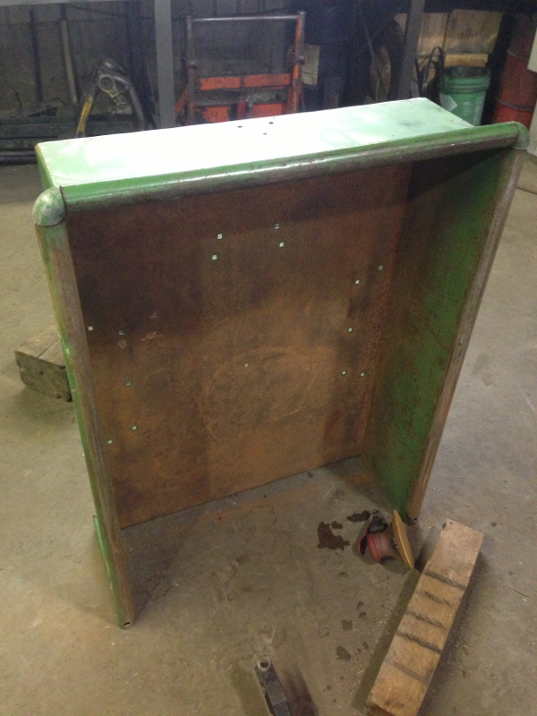

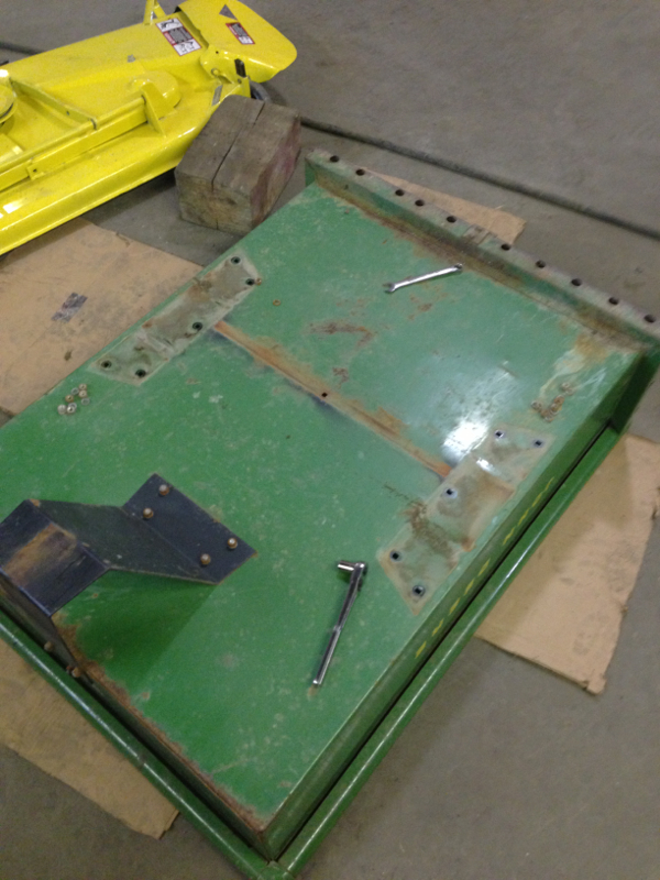

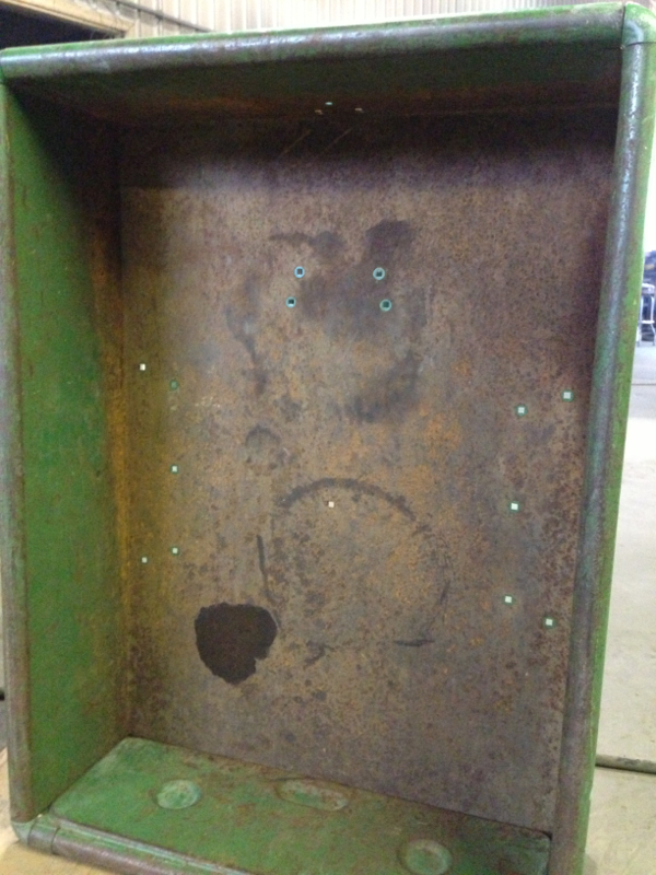

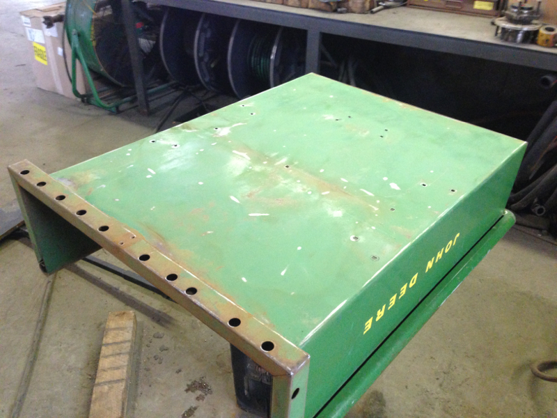

Okay, so tonight I got home and decided to wash the cart, and after that, I brought it inside to start where I left off yesterday. I took the wheels off, and started washing all of the parts and rims in the parts washer. I ended up getting the rims to look fantastic, with a little bit of grease left around the hubs. So tomorrow night I will clean the rims up the rest of the way, and start to sand them down and get them taped up for paint. In the meantime I will tear the wagon down and begin cleaning and sanding parts.

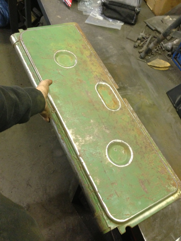

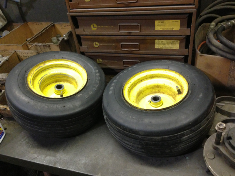

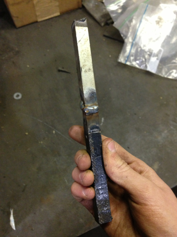

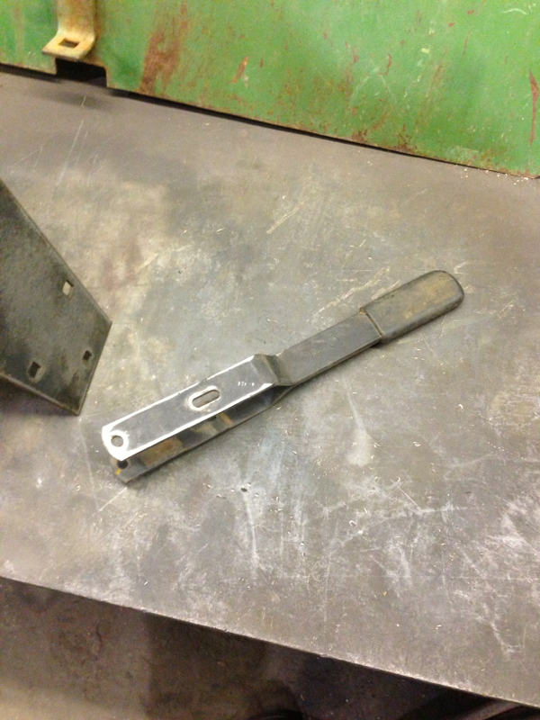

Tonight i really made progress, i took all of the running gear bolts off, and removed the running gear. Then i removed the bracket for the dump latch, and put them aside. I then proceeded to remove the tailgate, which was hard to get out. I got that off, and disassembled the latch. After this, i moved on to the dump latch, this was a task because the pins were brittle, and didnt want to come out to boot. So once i got them out, i was able to completely remove the latch assembly. I will need to modify the bracket for the latch that bolts onto the box, because the latch(pin) doe not go far enough back. I need to make a trip to TSC to get some carriage bolts for this and some things for the 317. Overall, I dont believe that there is much that this cart needs, even though i plan on getting new springs for the latches, and 1 or 2 decals.

Yeah I'm lucky with this one. I look my parts up from the online catalog, and the tires are Goodyear Rib II's. not carliles....

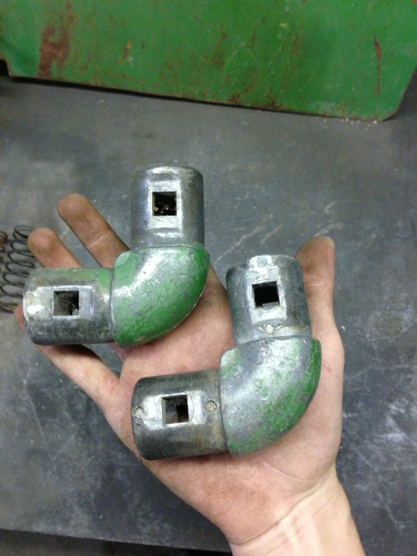

So today i spent a long time working on the cart, took the rest of the running gear apart, and started sanding everything down. I still have to finish sanding most of the running gear and the tailgate, then once I'm done i'll mask off the decals before I can find the right ones. My grandpa was painting a trailer today so I gave him some things to put primer on. I have alot more sanding to go on the box, and when i was sanding the bottom, many dents were revealed. Since this cart will most likely be used again when i'm done, I just plan on putting bedliner in it and not worrying about dents.

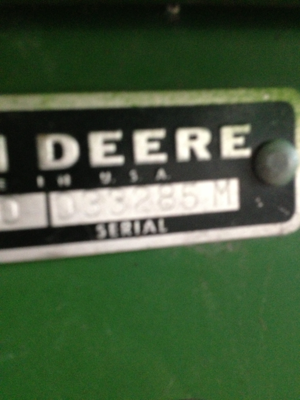

no, only the early brass tags you can figure out the year, foil tags like this one are easy, since this one is 7846, it was made the 46th week of 1978. that alum. tag i posted is much like the on you are talking about. i would guess the one i posted is a 73, because they used up the patio decals when tge patios were phased out. if the 140 and the cart were bought together new, then maybe it would be the same year as the 140. this one still has the Goodyears on it too!
