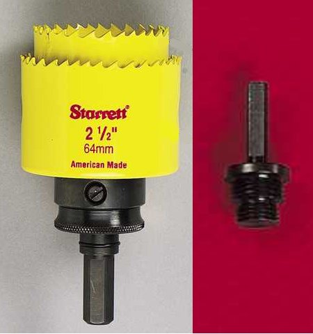

This is what I have used with great success in the past and will work for your exact situation.
It's called the "OOPS Arbor" by Starrett although I'm sure this type of arbor is available from other manufacturers.
The hole-saw arbor can accommodate 2 cutters being used at the same time. One cutter, inside, for the original hole size and one cutter, outside, for the newer, larger size hole. Finding your "exact" hole sizes for the cutters may be a fun journey... ;-)
3 things:
1. Buy the best quality hole-saw cutters you can afford - "inexpensive" hole-saws do not hold last! "Quality is long remembered after the price is forgotten."
2. Use a good quality "tapping / cutting oil" and lots of it.
3. Stop the cut when about 1/2 or 2/3 of the way and remove the inner, smaller cutter and only then continue with the new, bigger hole. This will allow for the continuation of the larger hole cutting without trapping the small section between the 2 cutters. 1/2 to 2/3 the way through the new cut will allow for the cut to be finished after the inner cutter is removed. Easy Peasy!
