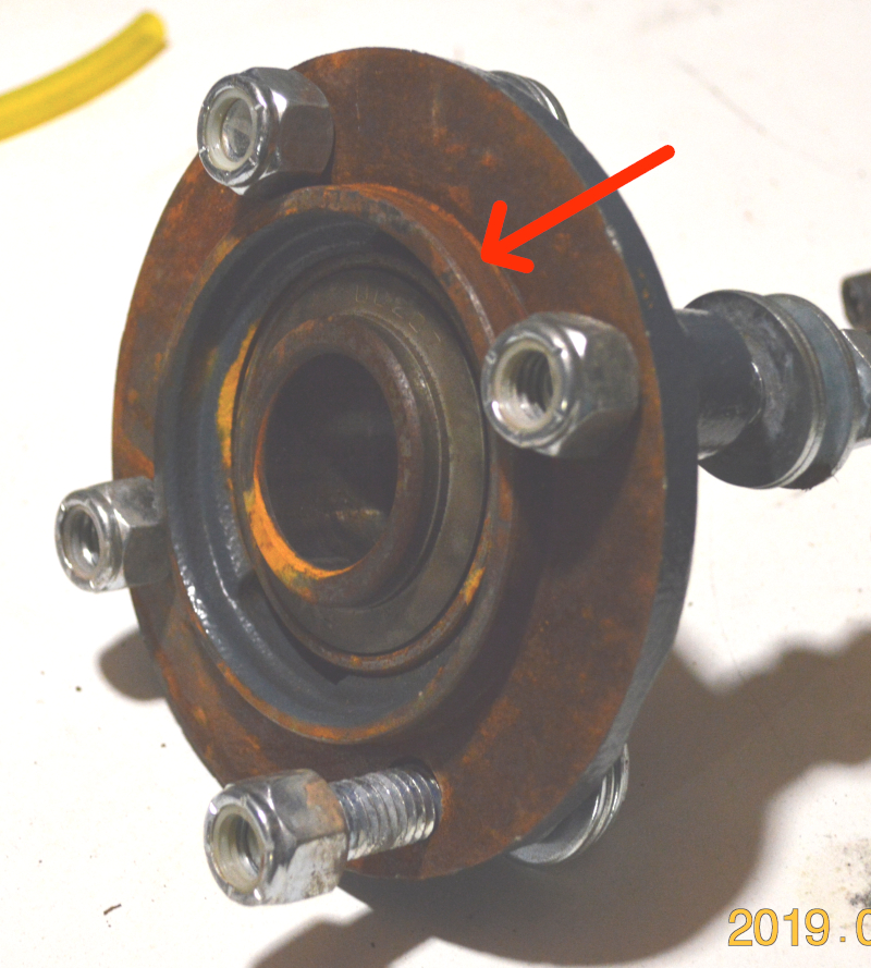

I used a Milwaukee Hole Dozer (non carbide model) hole saw to drill 4 1/4" (108mm) in a couple 1/4" steel plates. I used a little bench top drill press and only had wd40 for lube. It worked much easier than expected, only taking a couple minutes. The saw still looks like new, with the only some pain rubbed off on the welded seam. I think I could probably use a hand drill if that's all I had. A mag drill would also work if you can rent one.
   / 80mm hole to 90mm in 1/4" steel #22
Found a carbide cutter 90mm hole saw on Amazon. You could use it to cut a hole in some wood, plastic, or metal to make a guide. Clamp or weld the guide over the 80mm hole and have at it.

I've done the tacked strip for a pilot hole before, also done the guide-bore holding hole made of plywood. The double hole-saw is news to me, never done that but it sure sounds like a good one too.
What worries me is the 1/4" (vertical) steel that I cannot put into a drill press. I'm scared that it's gonna take a day and who knows how many holesaws.
Also there is a new tag in the mix. The purpose of the holes is to fit the round lip of flange bearings into the side of a snowblower, 2 augers, hence 4 holes.
But since posting someone has suggested that the round lip is for alignment and not for housing support. My alignment can afford to be rough, like 1/8-1/4". The support is allegedly more than handled by four 1/2" bolts holding each housing to the blower body, so all I would need is a 1/4" thick washer to put around the lip with holes to pass the bolts through. This I could make out of polyethelene in minutes. I'd like to have this advice seconded though, the bearings cost 60 a piece and that alone is reason for prudence :)
