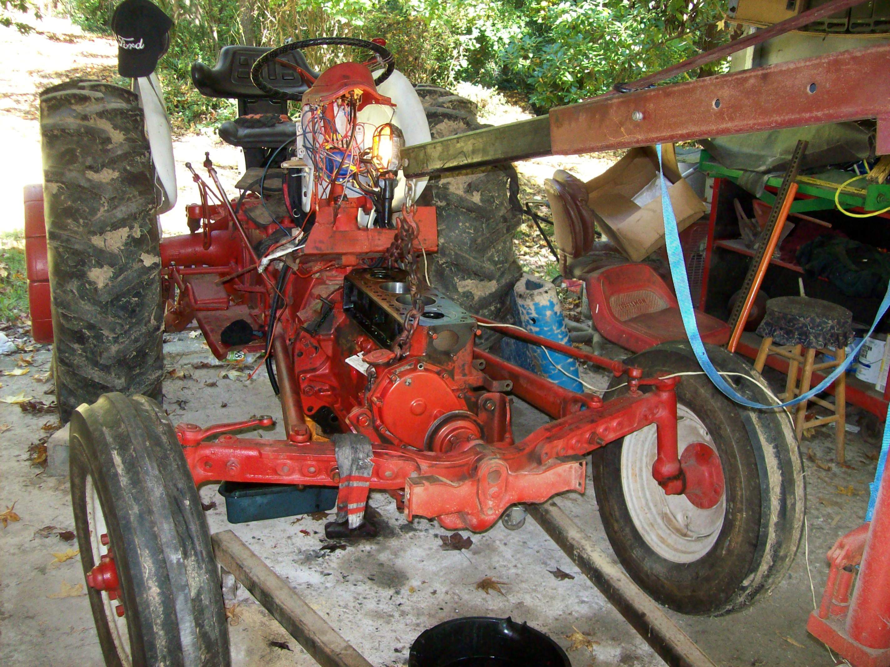

Made a lot of visual progress today. I RTV gasket sealed in my rear main bearing block clamp & V-seals; got the oil pan, front cover and pulley installed with new gaskets; took the engine off the stand and hung it on the my cherry picker at an angle so I could install my flywheel (with new bearing) and new clutch. That was a bear to do alone. Suckers are heavy. Then I thought before the sun goes down, why not try to put the engine to the transmission. Well that was definitely a job I recommend having help with, but after 1/2 dozen alignment bars, 2 C-clamps and a lot of prayers and cursing, it finally slipped it on by myself and I even rolled the axle back bolted in place. All the nuts are still loose, but at least the engine is back in. Now I just got to remember where that pile of parts in the corner go!

I got the engine block bolts to the transmission housing tightened and the 4 bolts that hold the axle to the front tightened. Reattached my radius rod and tie-rod to the axle
Removed my cherry picker, jack and jack stands underneath.
Torqued the head down to 100 lbs. and put one bolt in to hold the starter in place. Not sure why I only had 1 bolt stored with the starter when it takes 3, but I guess I'll find them later.
installed my new temp gauge sensor, but had problems getting my oil pressure line to screw into the brass elbow fitting on the engine block. It was getting cold and darkish, so I called it a day.
