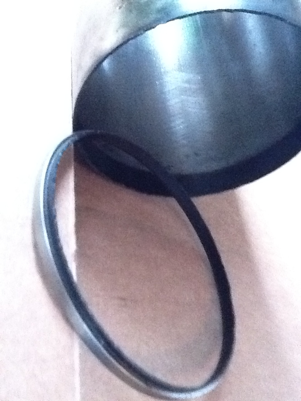

Ouch. That may be what the previous owner did to mine... Lasted about 10 hours after I bought it. First picture is #2 cylinder where the lip fell off. The second picture was #1 cylinder which disintegrated. #3 was left intact. Maybe he got the hang of it by the third cylinder.
I don't know what happened to yours. I am not saying that the way we did it was anywhere close to the correct way, it is just the method that was used. :) The 861 has ran well for 35 years since!

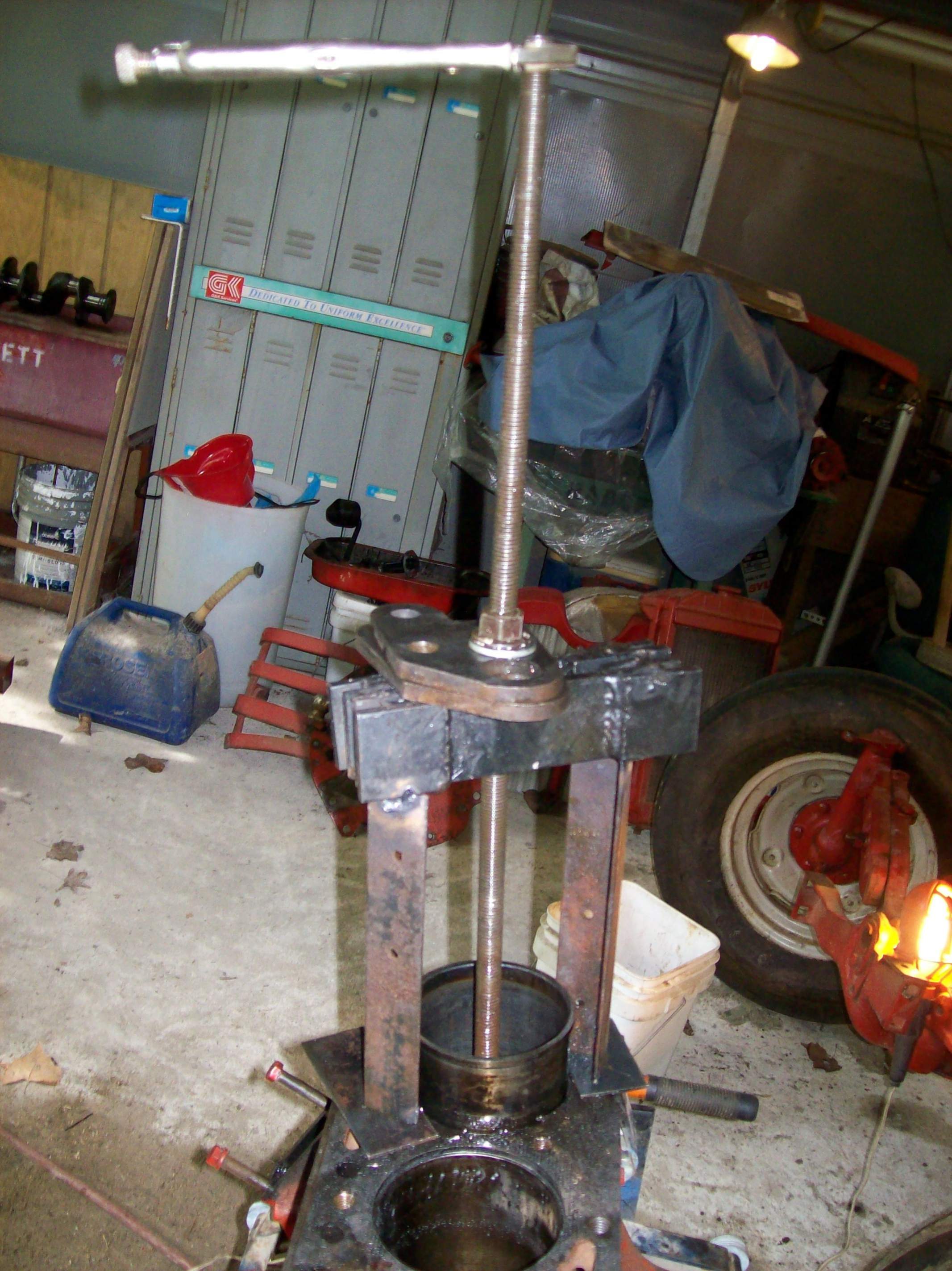

Finally got the last sleeve #4 out this afternoon just as the rain began.
Although it was the easiest one to start, it was the most difficult to get all the way out and cupped the aluminum pull plate I made in the process.
My new parts have arrived, so I think tomorrow I can officially claim to be putting everything back together then.
I had my doubts about my homemade pulling rig, but it held up long enough to get them out. Now I got to come up with two longer metal braces to span the bottom of the engine where the oil pan attaches to pull in my new sleeves from the opposite direction. While I may be able to bang the new sleeves in place with a 2x4 and a BFH; I'd rather try to pull them down with my 5/8" rod/nuts and a flat plate on top of the new sleeve.
