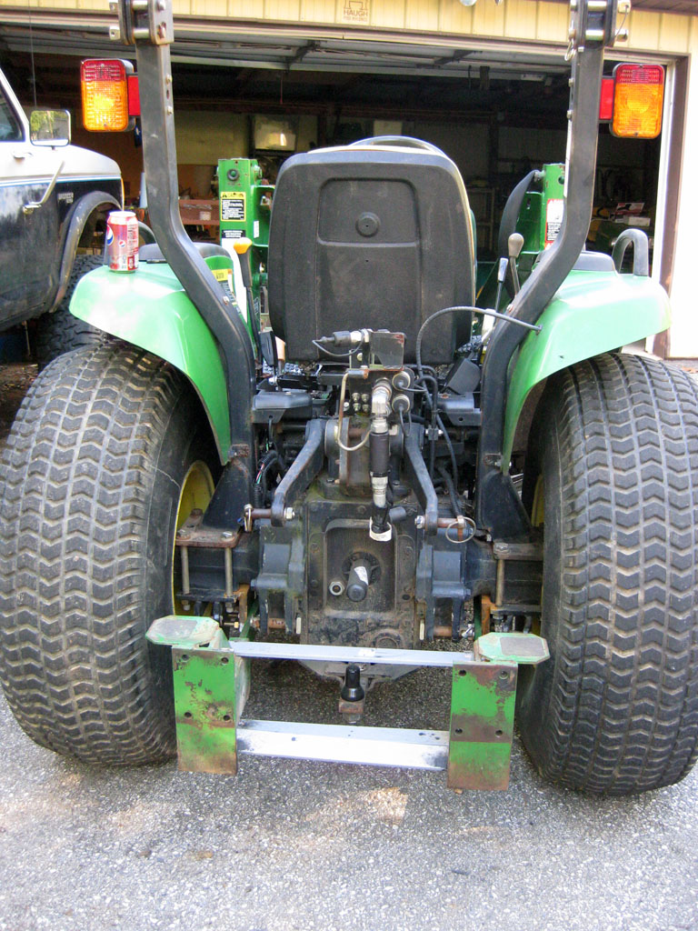

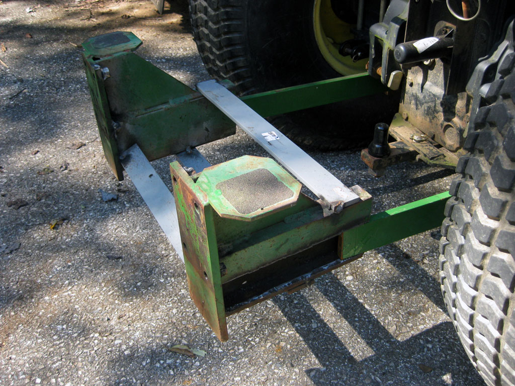

#71

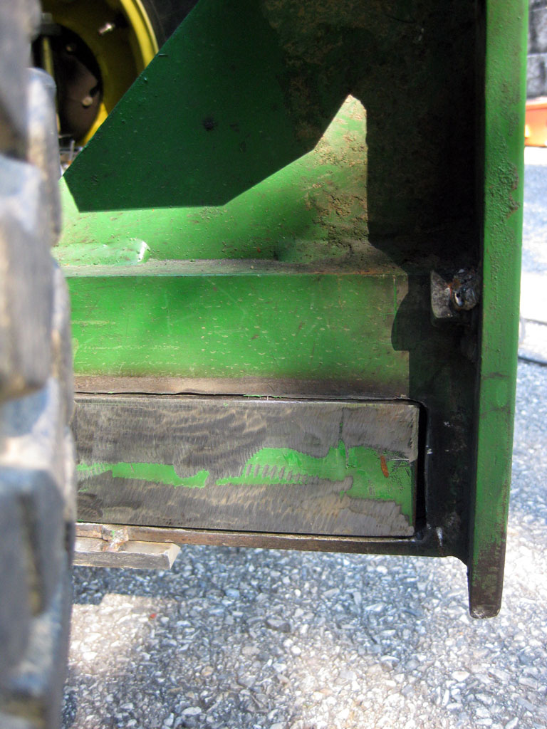

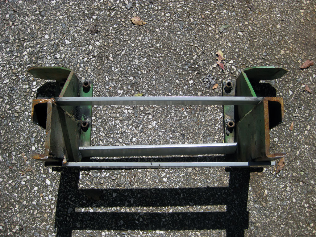

The final product and the trial fit...

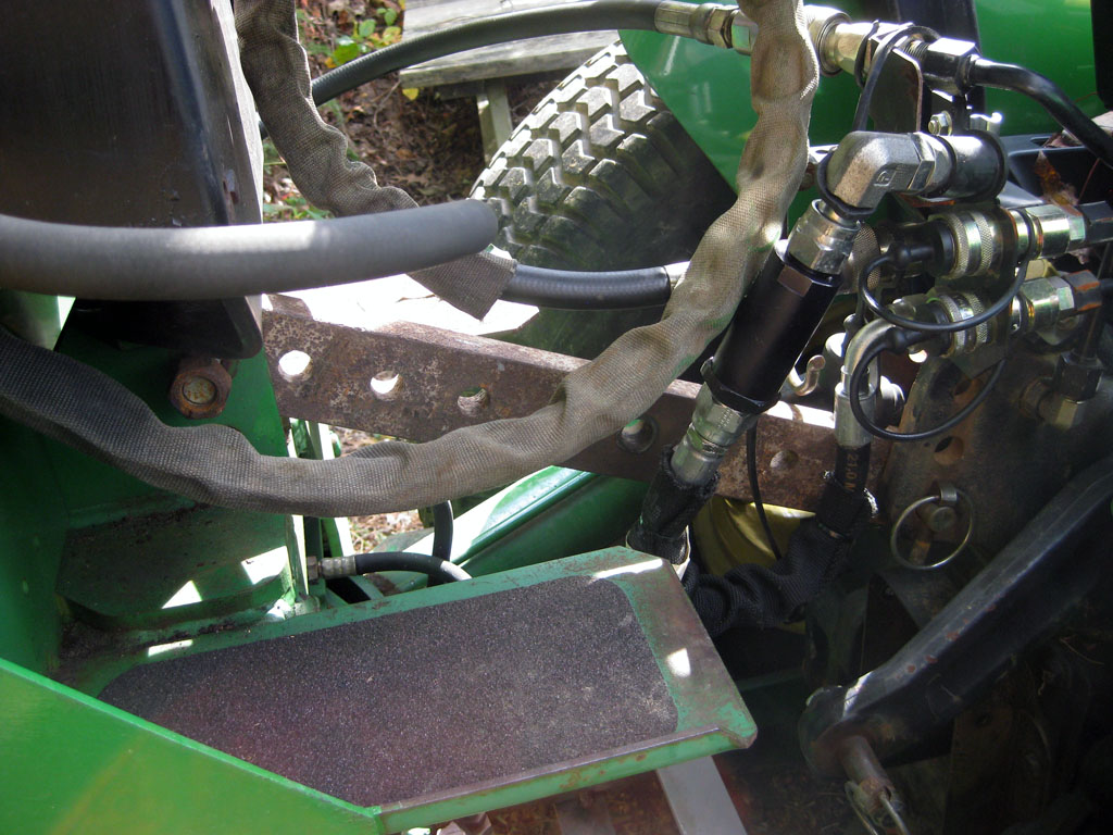

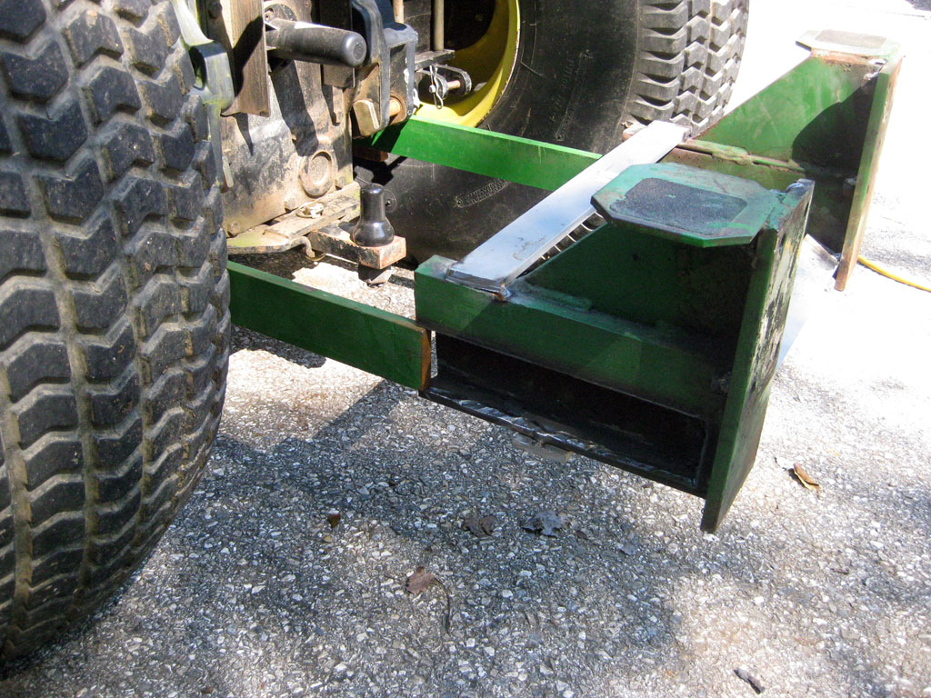

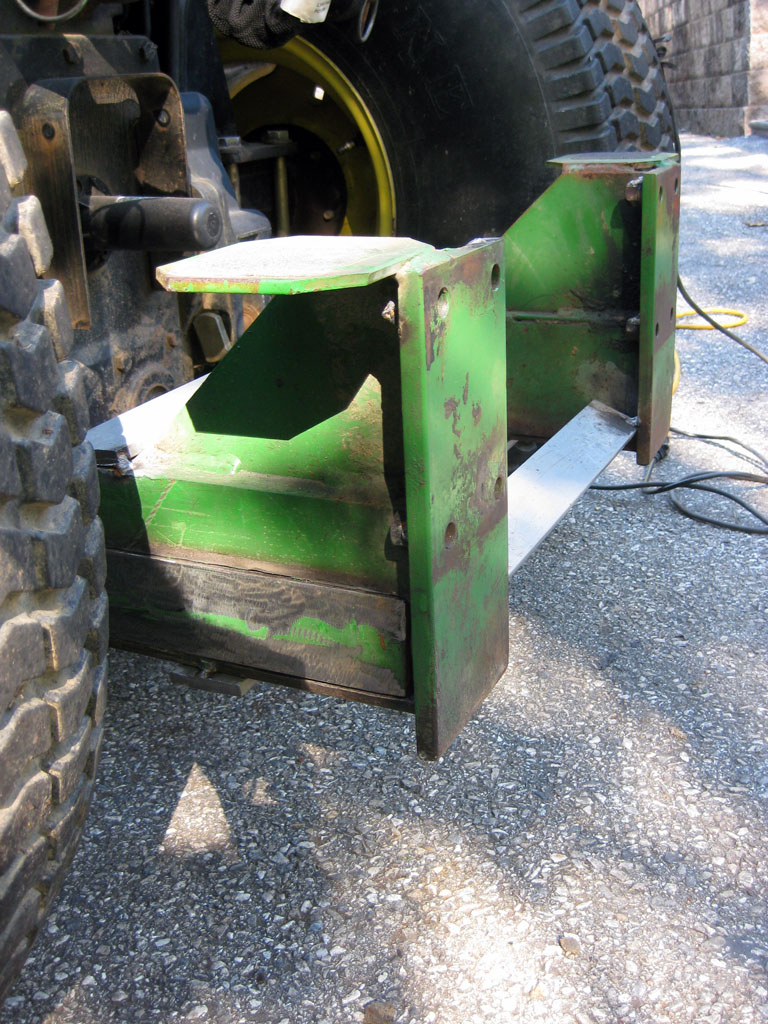

#72
Perfect fit. Need to measure for level and weld it up.

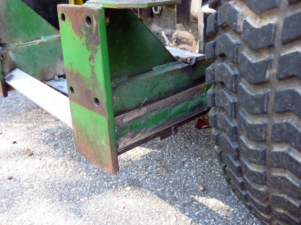

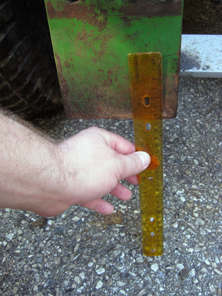

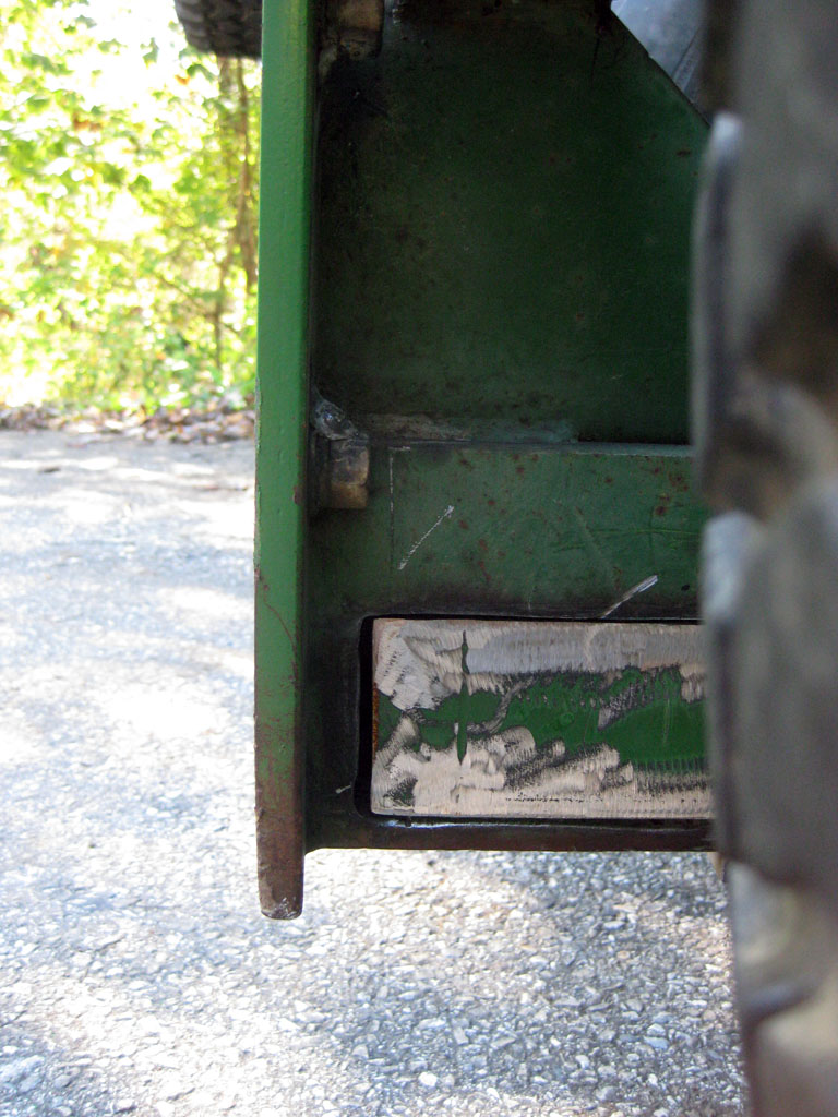

#73
9.5" ground clearance. As good as I can do actually.

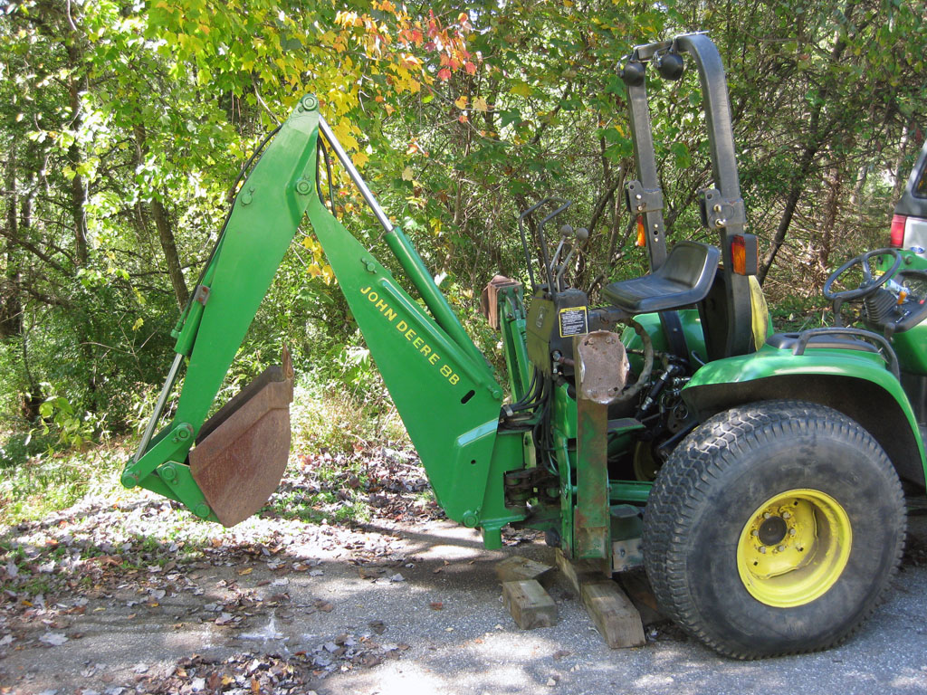

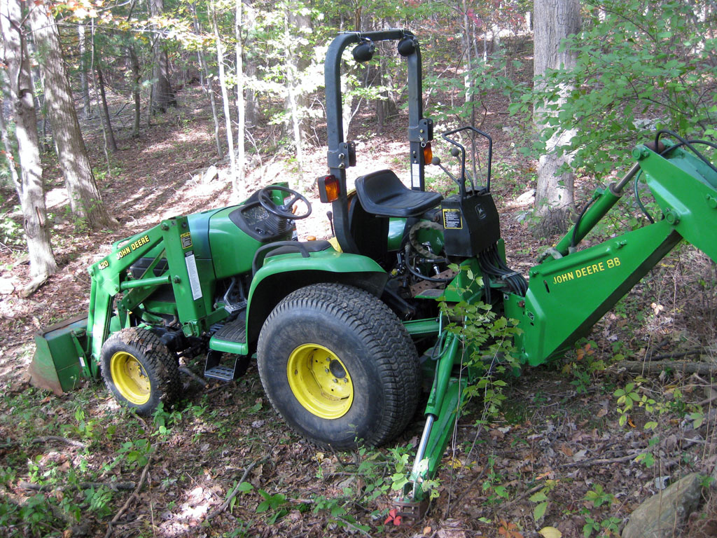

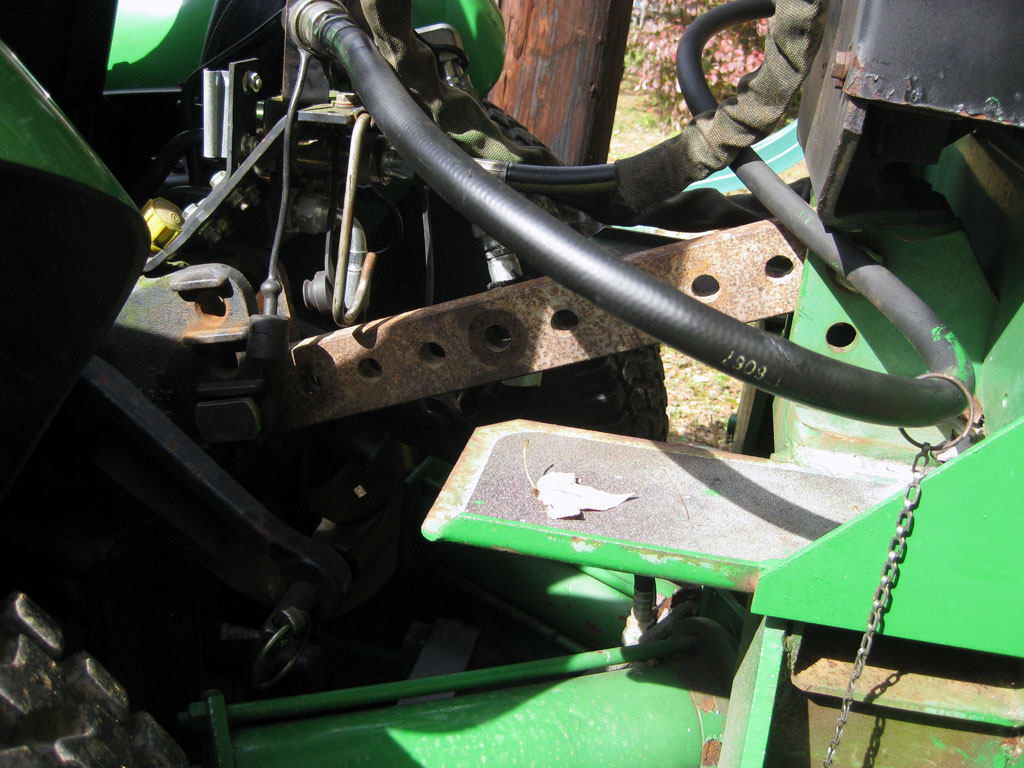

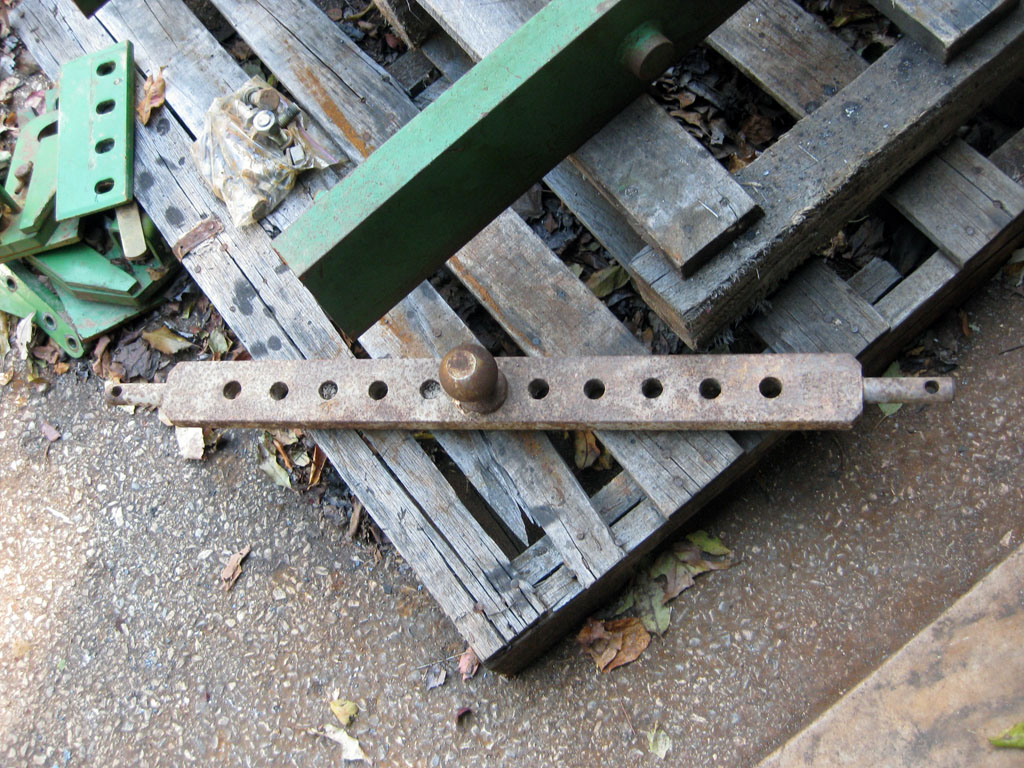

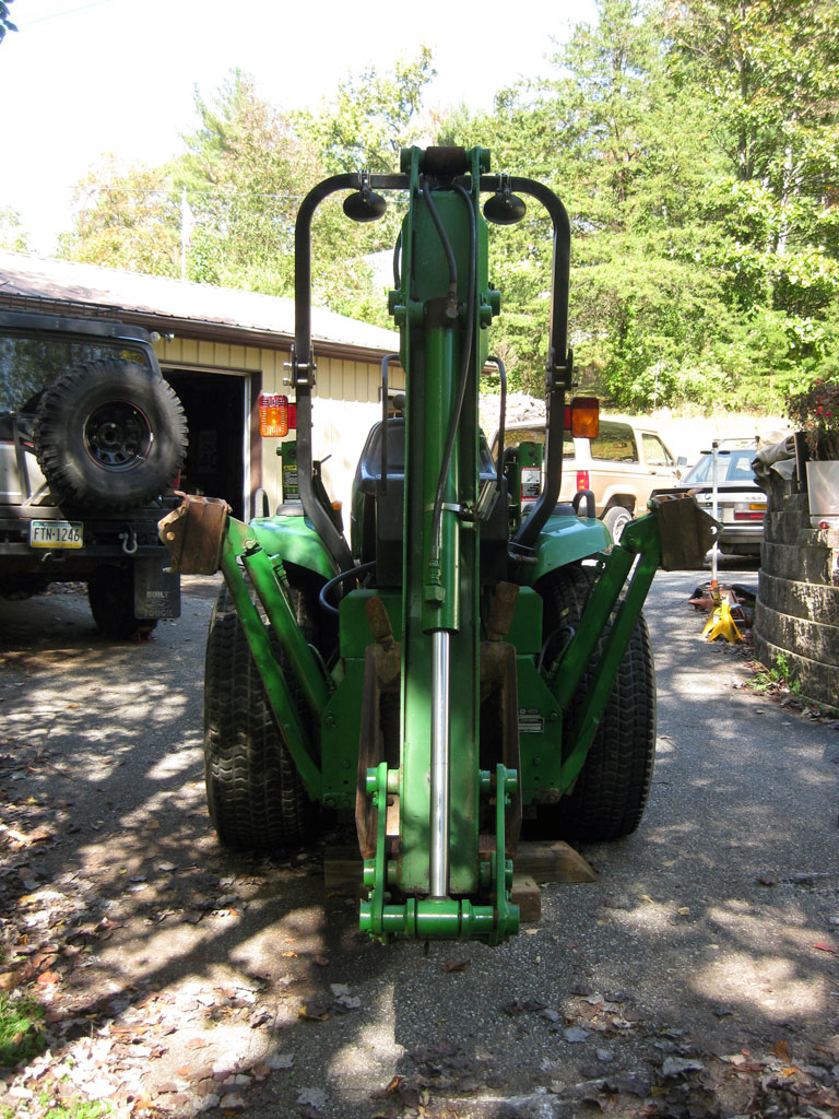

#74

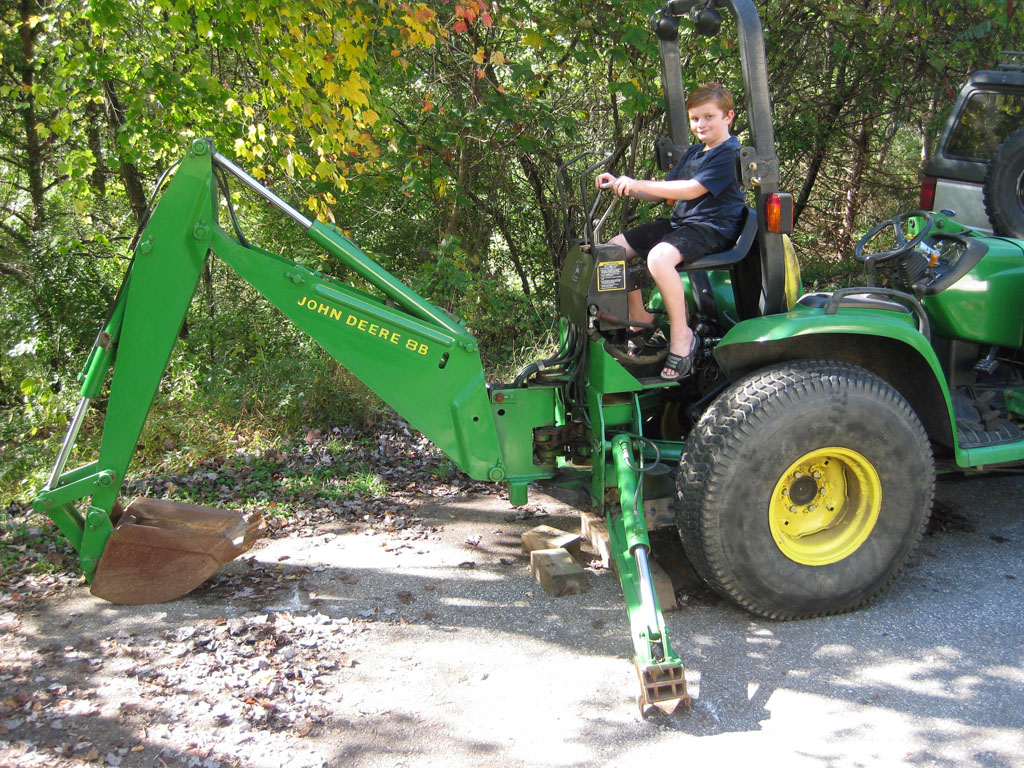

I guess the question "8B Backhoe On A 4200?" has been answered.... :D
The drawbar was in the neighbor's scrap pile and will become the top link. The kid likes his new toy.

   / 8B Backhoe On A 4200? #75
Wow, you really are short. No trouble with hitting your head on the ROPS there.:laughing::laughing:
Nice build. Looks great.:thumbsup::thumbsup:

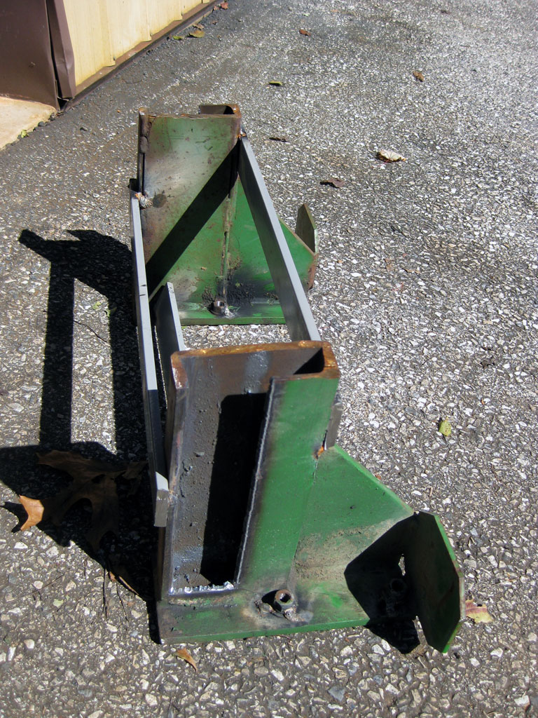

#76

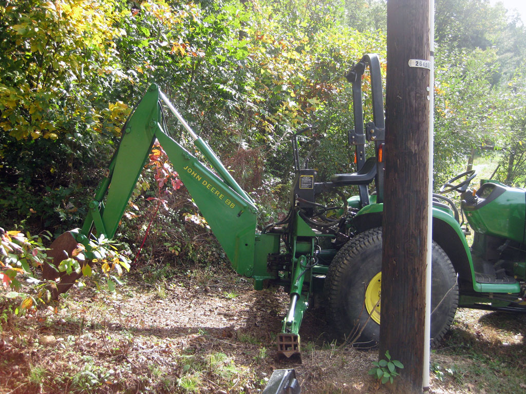

The toplink is installed. It REALLY affects the stability in a good way.
You can see its mounted pretty straight.
And it clears my worst transition so thats perfect!

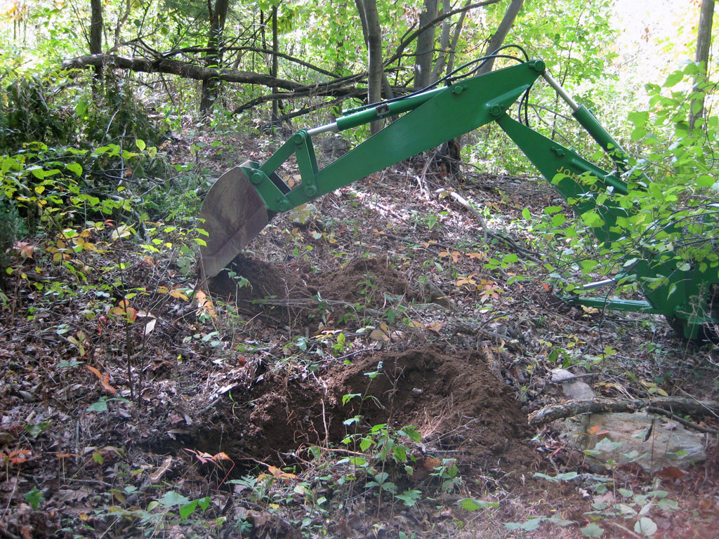

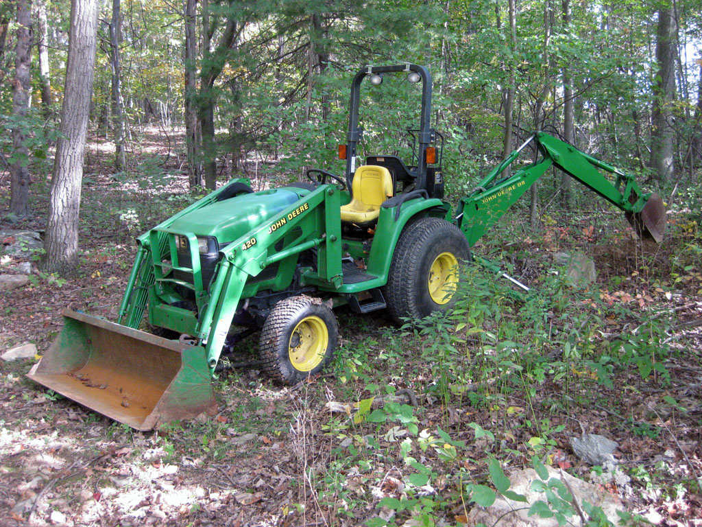

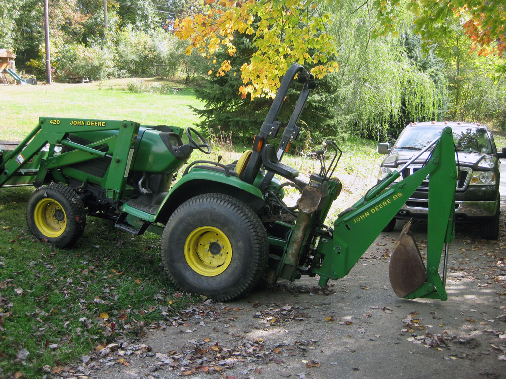

#77
Ooh, the first hole! And some on-site glam shots.
It digs pretty good. Lots of power. The valve needs a rebuild. Some of the movements stick. Others cause the engine to bog. A couple work just fine. The stabilizers cause the relief valve to go off. Its a $279 kit to rebuild the control valve and the relief valve. I might have to spend the money on that and flush every hose too. At that point I might as well rebuild all the cylinders too. A project for a different summer.

   / 8B Backhoe On A 4200? #79
Brother Arrabil....you ought to feel proud of yourself..great job!!!!
#80
Thanks Brother Roy! I do feel proud. There is still a lot of work to do though.
