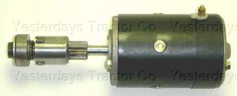

Any chance someone can give me pictures of what i should be removing and spraying?
/ 8N clutch plate issue #4
the starter should be blaringly obvious.. but I'll dig up a pic of one somewhere...
it's the thing with the heavy wire going to it from the battery.. :)
ok.. here's a pic from a parts seller I use. the big black part is what you will see. it's on the left side, installed into the tranny bellhousing .. 2 LONG BOLTS HOLD IT IN.. remove those and then angle the starter toward the block and down slightly so that the shaft sliding out is angled away from the tractor at about the 2 ocolck position.. this will let the drive gear slip over the ring gear.. the ring gear as you know is on the flywheel.. and thus you now know the location of the clutch.. etc.
if this doesn't make sense.. i sugest you HIRE someone to fix your tractor...

ps.. forgo to mention.. the outter shell of the starter can slide off if the drive gear hangs on the flywheel. DO NOT let that happen or the starter will be in 2 pieces.. :)
then you will be positng back asking how to capture the brushes and get them back on the comutator.. :) ( fishing line works by the way.. if you decide to go that route.. :) )
