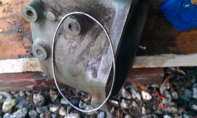

So I took apart my 4 wheel drive housing and while I was cleaning out the old oil... this metal o ring fell out. Anybody know what it is and more importantly where it goes?
Is it like a spring of soft coiled metal, very flexible? If so my guess would be it fell out of a seal, somewhere. Seals will usually have those metal coils in them for pressure.

Yes its like metal wraped around something and its very flexible. I bet it popped out of the knuckle seal...which I am replacing anyway. I could not find it on the hoye schematic so I was a scratching my head....not the first time I had extra parts after disassembling something LOL

Yup I agree with clemson its the seal spring some guys like to pack grease in around those to keep them in place on install fwtw.
