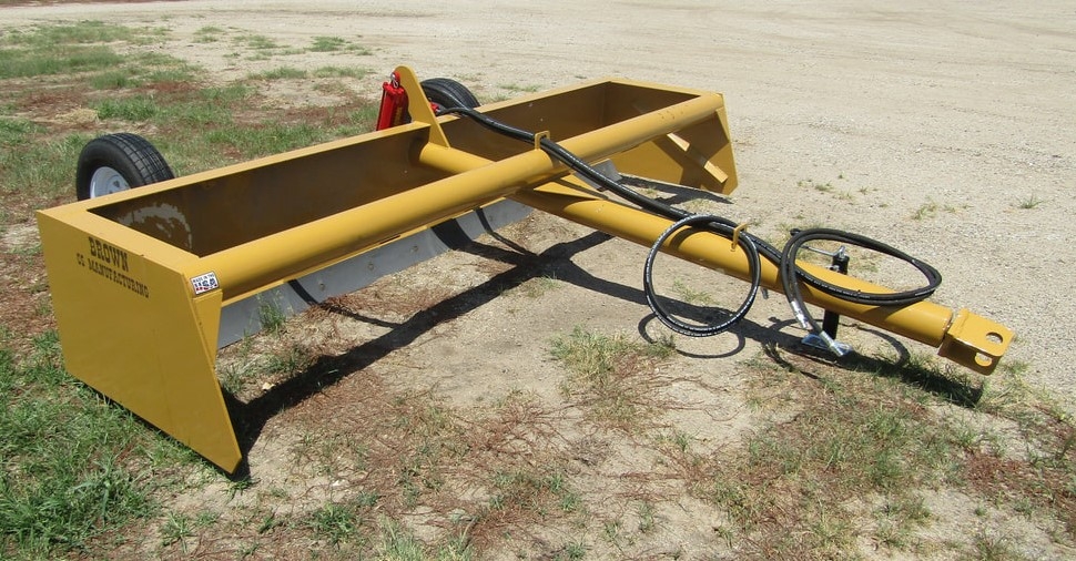

For what you are wanting to do I think you'll need something like this...and a much heavier tractor.
