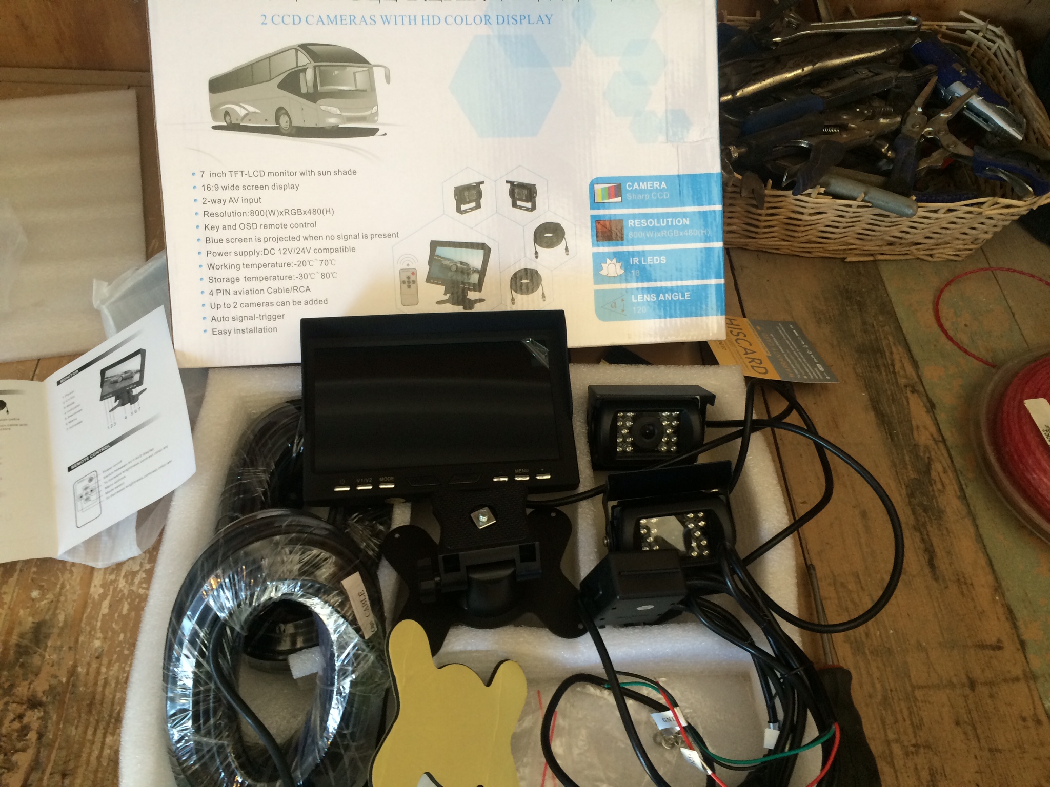

The kit came in today. This is what was in the box. The installation instructions consisted of a list of what is in the box.

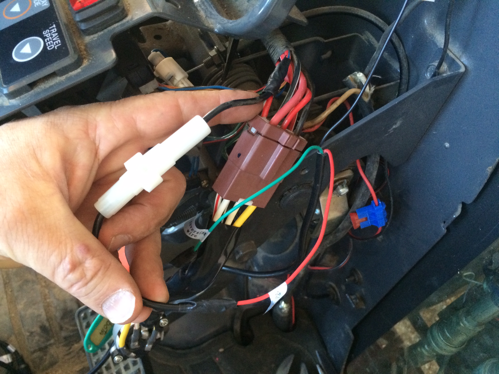

My most difficult task was finding a place to get power. There is a plug available under the dash, but I already have 2 other items running off that plug. I ended up skinning a wire and putting a 1 amp fuse to get power.

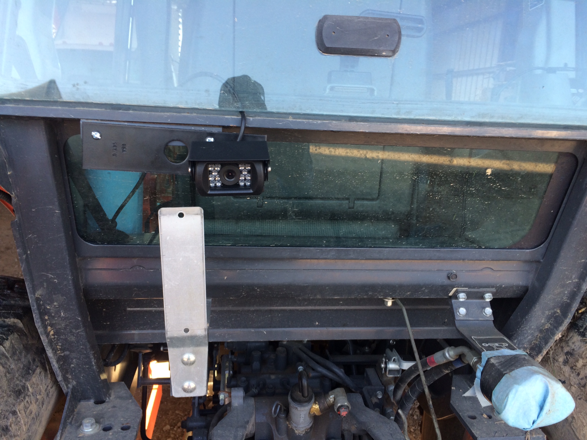

I drilled a few holes in an edger blade to mount the rear camera. It seems to have worked out well.

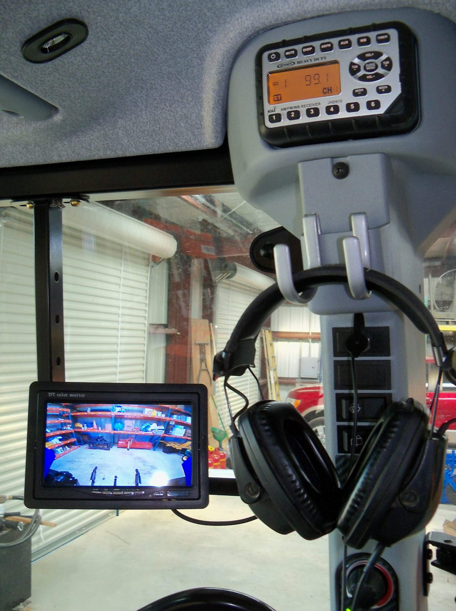

I thought I would update that my camera and monitor are still going strong. They are on anytime the key is on. The camera comes in handy when I am on the road. I can look down and see if there is traffic behind me. One day this week I was in tight area in the woods between a bunch of trees. The camera made it easier to navigate through them. It has been very handy when I am loading the truck, I can just look down and back up. In some cases I can see my implements good enough while I am working them that I don't have to turn around to watch them.
