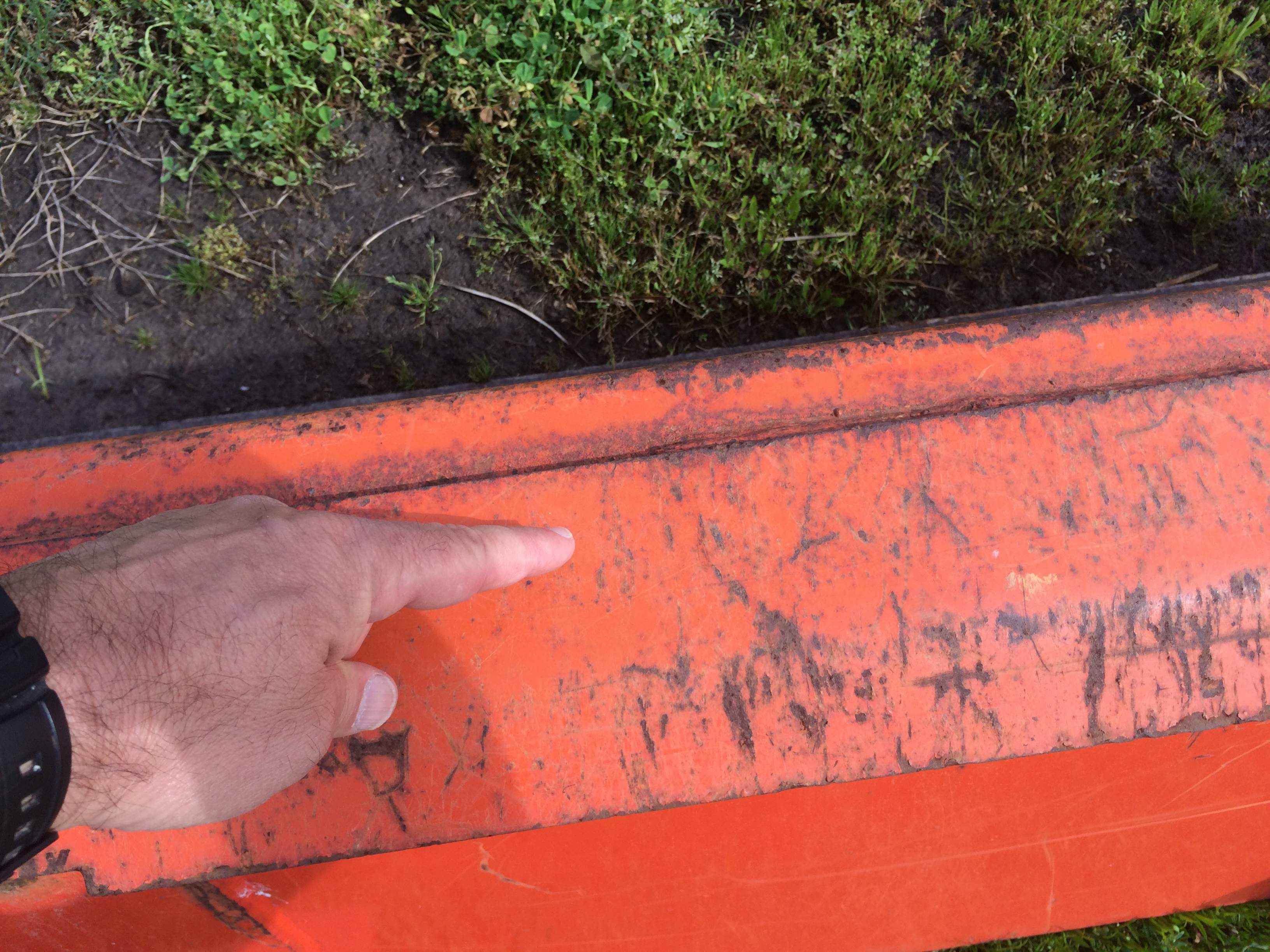

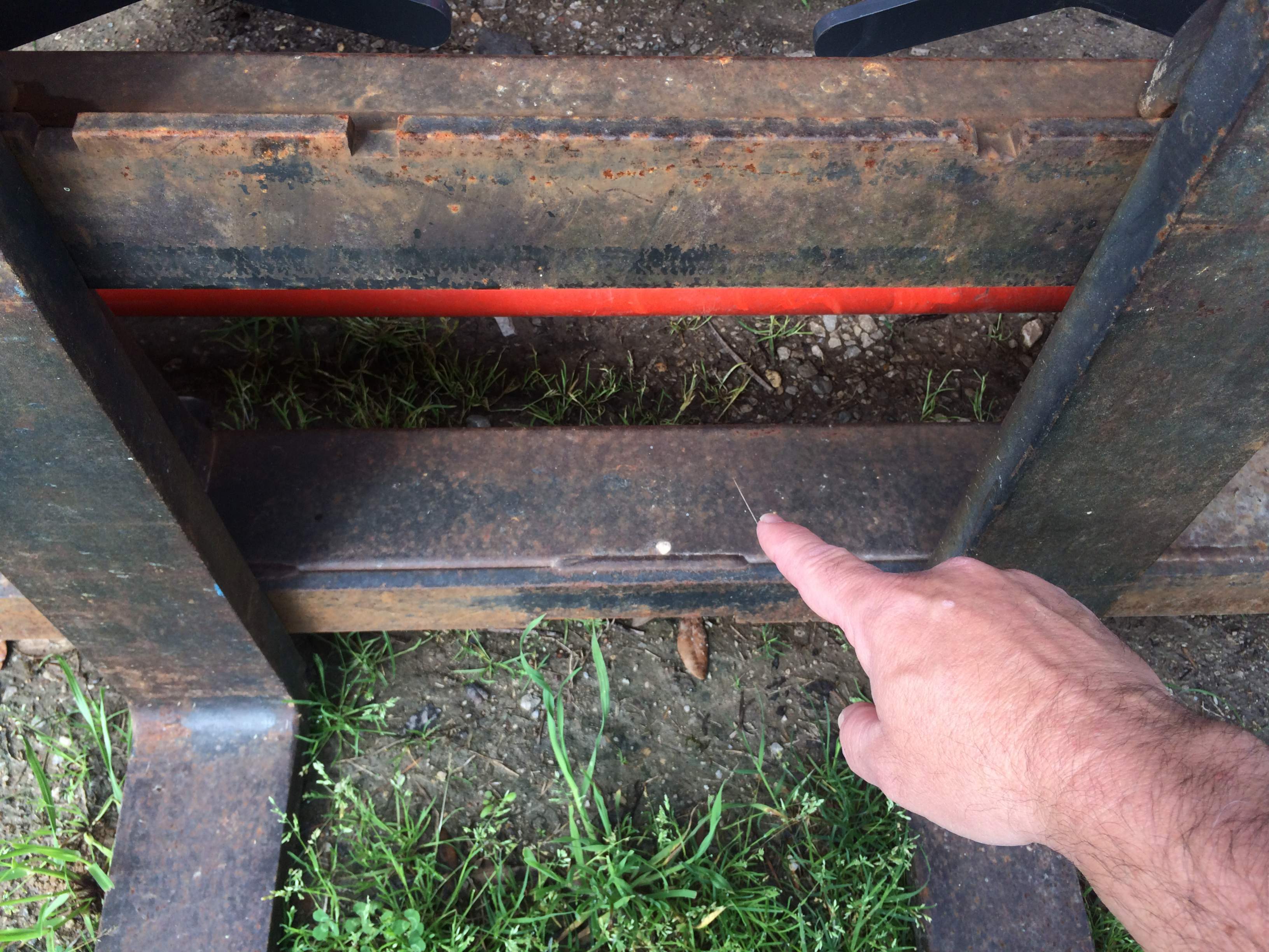

Because this system includes cables (which look rugged)I'd suggest that their price is fair and not worth shopping farthur.

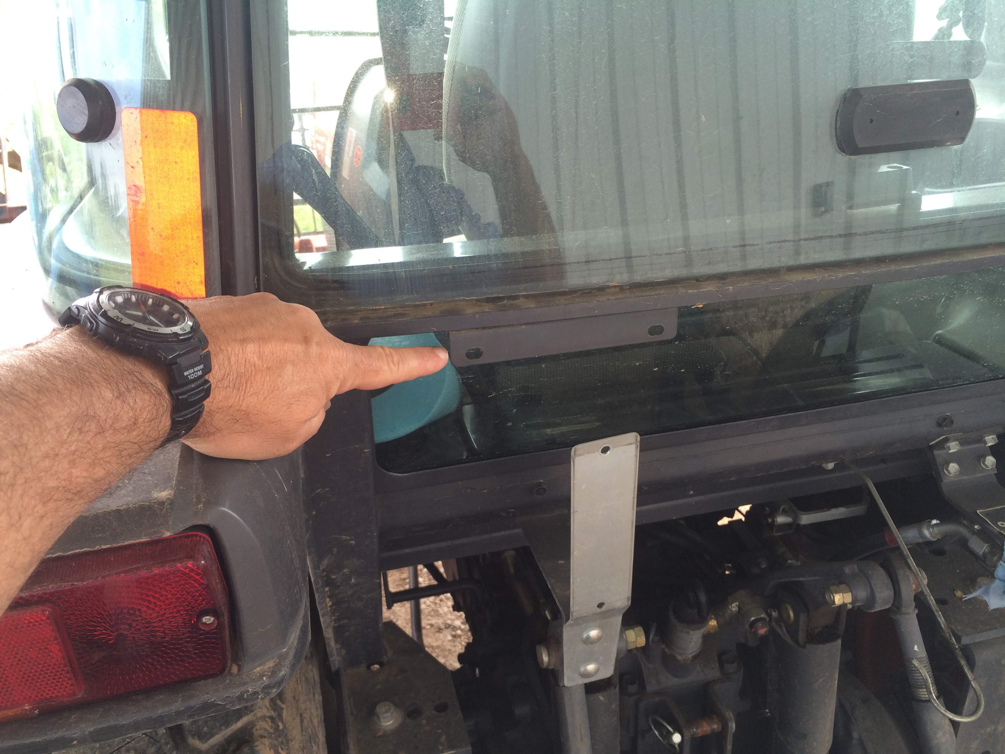

I just ordered this system. I like the fact that it is a 'system' and all components are (supposed to be) compatible. And, the 'refurbished' system shows the monitor measurement as horizontally at 9.1" which I suspect would be the same as the 7" diagonal monitors.
The only thing I don't like about the system I ordered is that the cables are 66' long, which is waaaayyyy more than I need.
Now I need to find some good magnets and build a bracket to mount the front camera.
For the rear camera, there is a bracket already just below the rear window that I think will work fine, although it is a little offset from center.
And, I think there are several flat surfaces on my loader and on my buckets (I have 2, one with a grapple, and one without) and on my forks. I think the magnet will give me plenty of options for mounting the front camera.

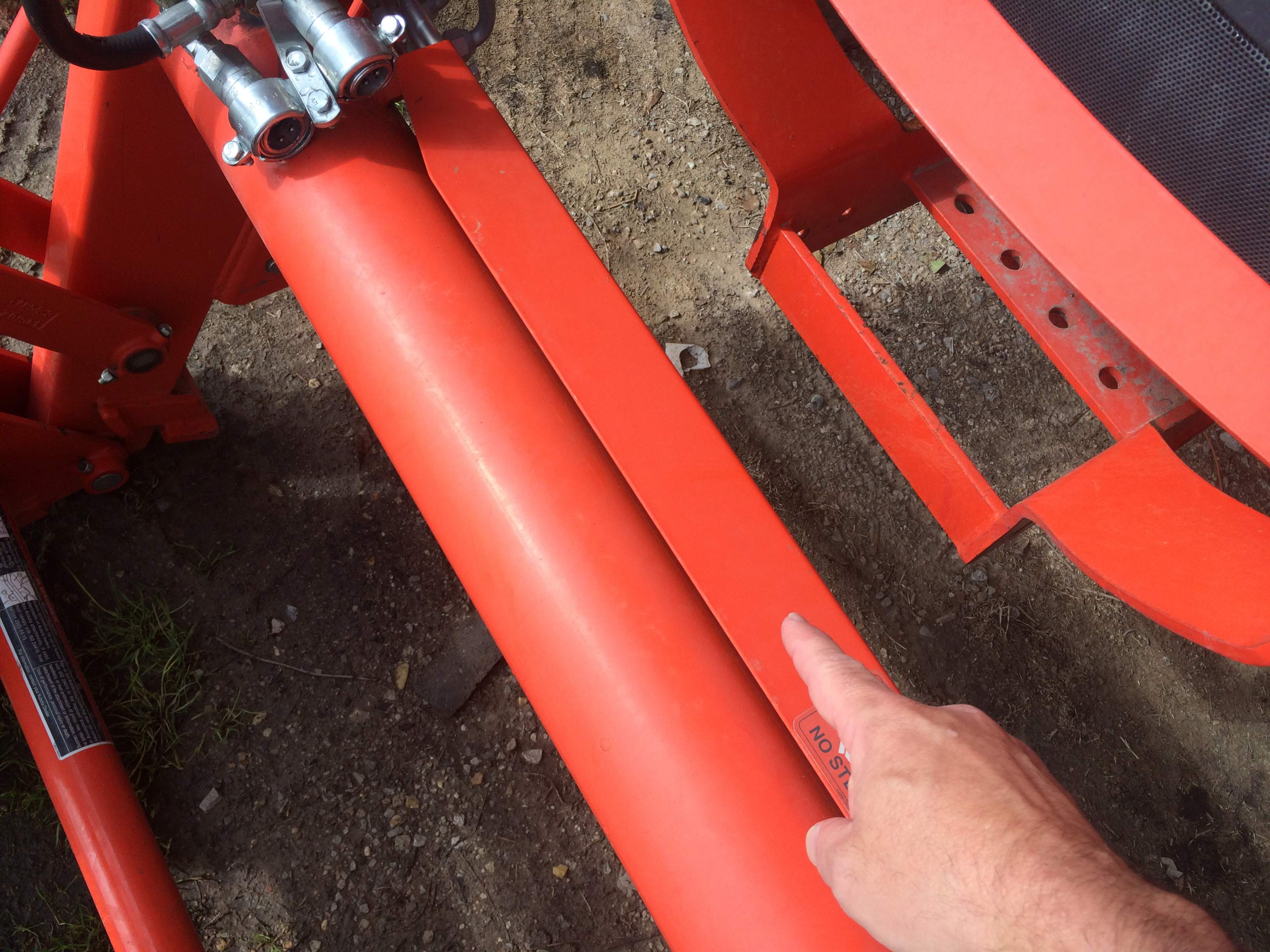

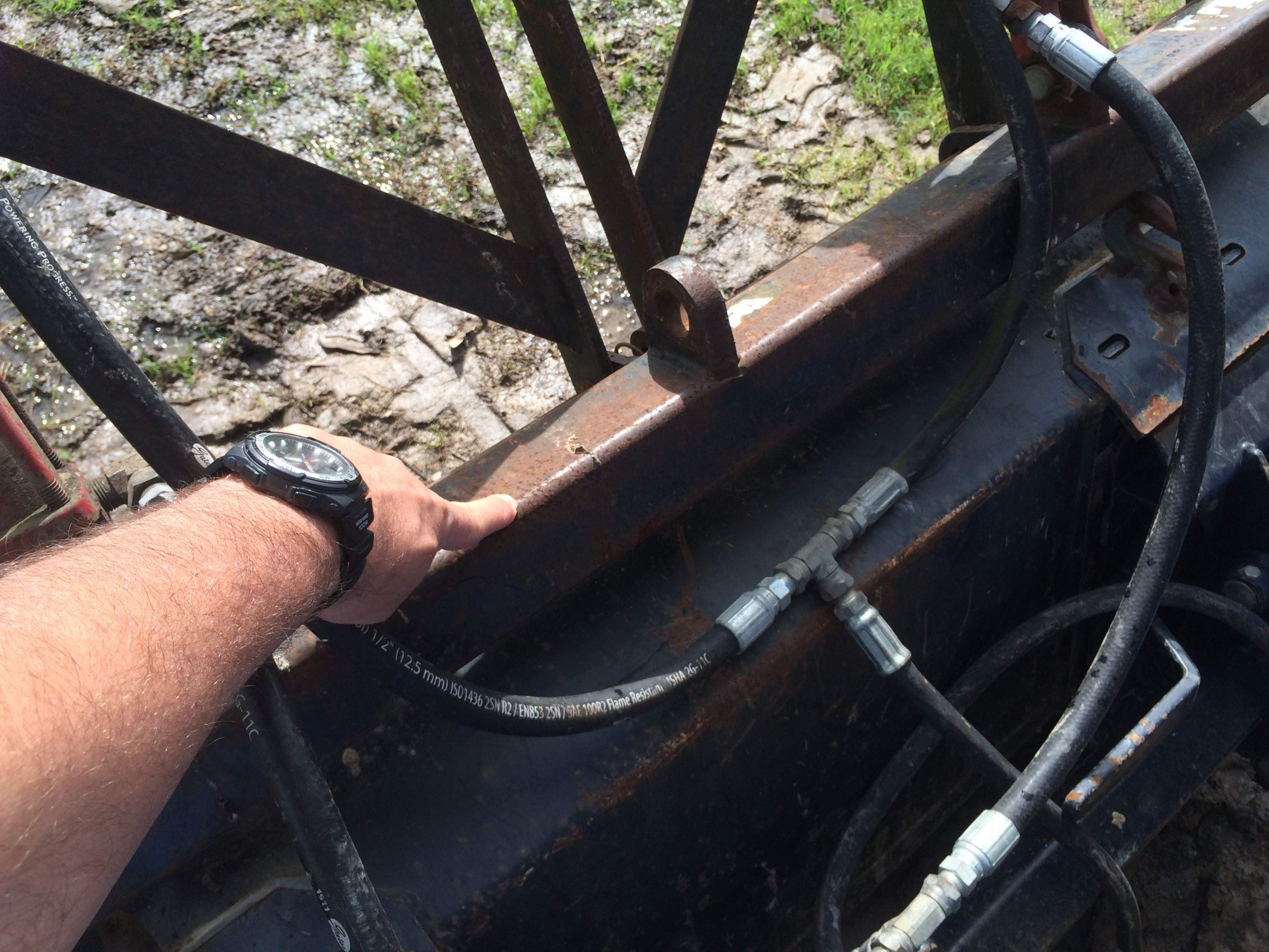

"The only thing I don't like about the system I ordered is that the cables are 66' long, which is waaaayyyy more than I need."
Hey, better long than short!
Man made it, man can alter it. Best would be to unsolder the connector at one end and resolder to your liking.
Where the cable runs from the cab to your FEL mounting area add an additional protection of some sort as that will be a very vulnerable area. Best would be some kind of braided metalique sleeve material.
Having pretty much the same system I can confirm that type and length of cable is not critical.
If you have old TV co-Ax you generally can skin the outer plastic and underneath is just the kind of braiding that I'd suggest.
While not bullet proof It certainly will offer excellent protection.
