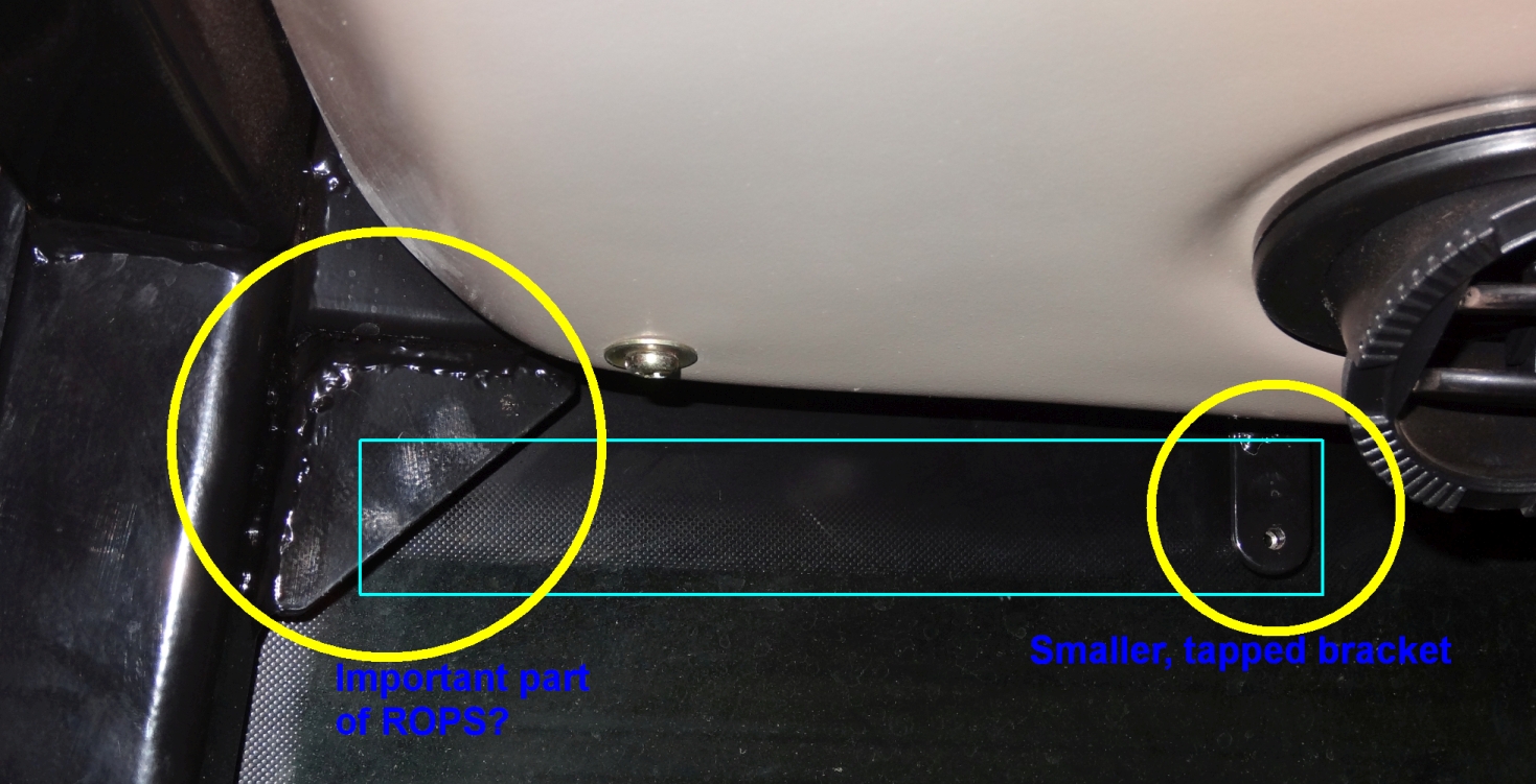

Hi all
An engineering kind of question - I am in the process of installing front and rear cameras (link) in my Kioti FX751 cab tractor. For the monitor, there is an unused bracket with a nut attached already welded to the ROPS top left in the cab, and then a corner brace as shown in the image below. I am considering drilling a small (~4-6mm) hole in the corner brace to hold a home made bracket about where the blue outline is on the photo. The "rules" are that you should never do anything like welding or drilling a ROPS as you might weaken it. Would drilling a hole that size in the ~10mm thick brace be enough to matter?
Thanks, Mort

As long as you don't punch thru, with your drill, and pierce your windshield, you will be okay. Is there enough space to put something between the ROPS brace and windshield?
When you fill new hole with a bolt, your brace will be just as strong as before.
Chances are you are probably safe. However I wasn't willing to risk it when I mounted lights to my ROPS. I clamped rather than drilled. I'd rather not screw with my safety devices, especially when other options won't be much harder.
Could you clamp a bracket to it instead of drilling relatively easy?
   / A backup camera for $50!!!!!!!!!!! #378
I agree it is best not risk altering a safety device. In an ideal world it would probably be a non issue. Should it ever fail at that point with another operator even if it did not become a legal concern I would still feel bad if someone got hurt or worse.

An n52 magnet 1" diameter by 1/4" thick will hold it on no problem.
