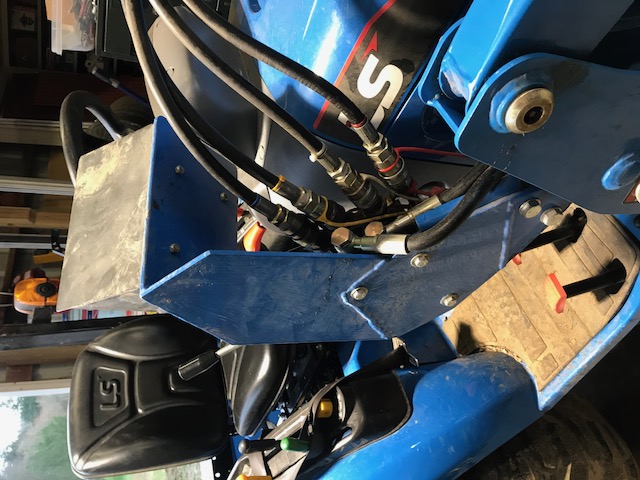

Linked from another thread .... but on a quick scan, I still don't see a way to protect the monitor without a cab.
   / A backup camera for $50!!!!!!!!!!! #466
I extended a cover more so for glare though it will protect it in the rain to some degree. It wouldn't be hard to fab something better than I stitched together for rain. camera LS.jpg
