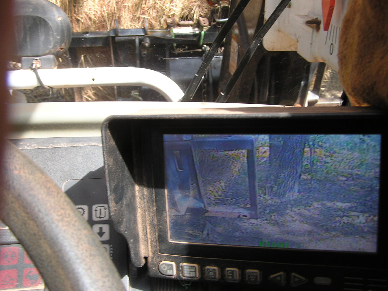

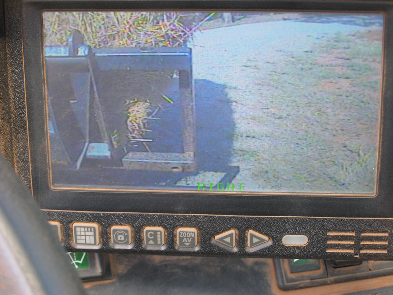

Which one do you use and do you have some screen pics from the seat?

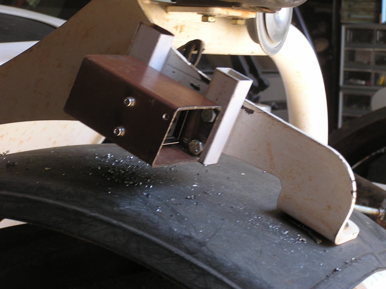

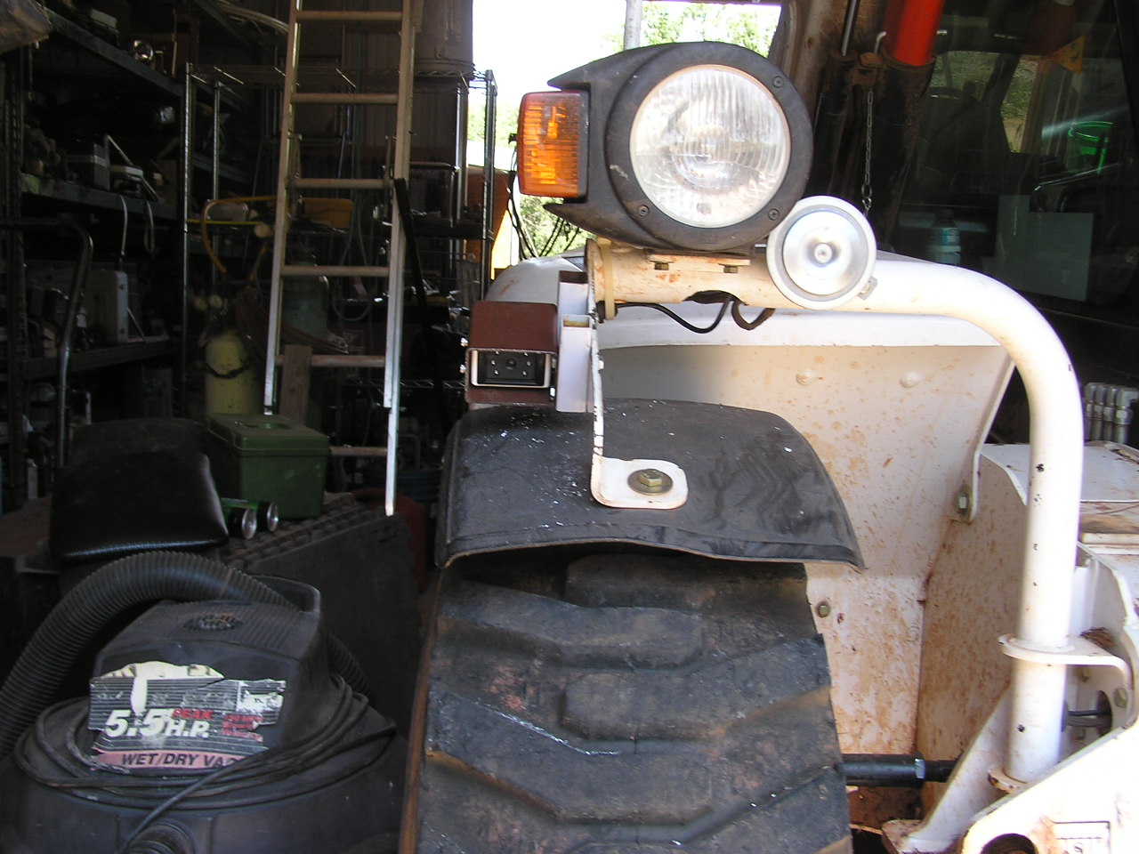

I have one from Rearview Systems: Backup Camera Safety Kits & Accessories Paid more but it had a 5 year warranty. Installed it on 9-2-2012 and it is still working great.
The monitor is right of the steering wheel, low enough to see out the windshield over it. The camera is over the right front wheel, pointed down to see what is out there and see the the SSQA plate when changing attachments:

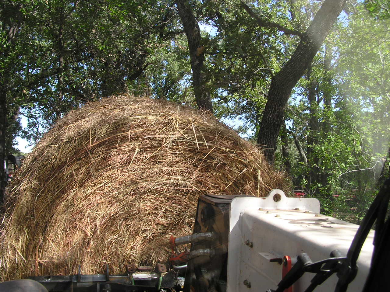

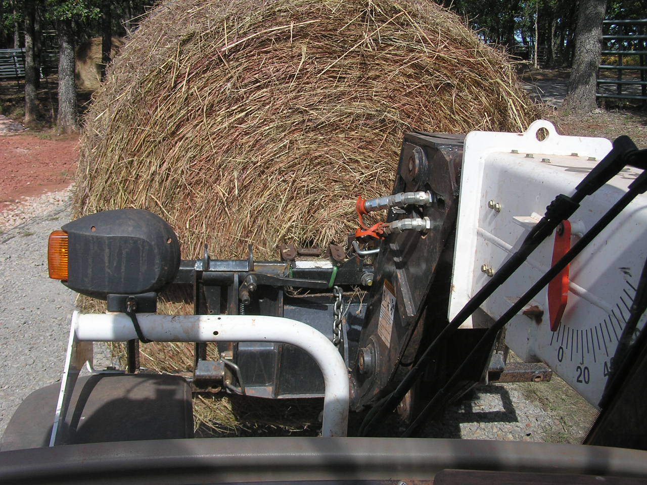

The view from the seat, moving a big round bale and the monitor showing what I can't see:
Looking up I see a tree trunk ahead. Looking at the monitor I see that I will miss it:

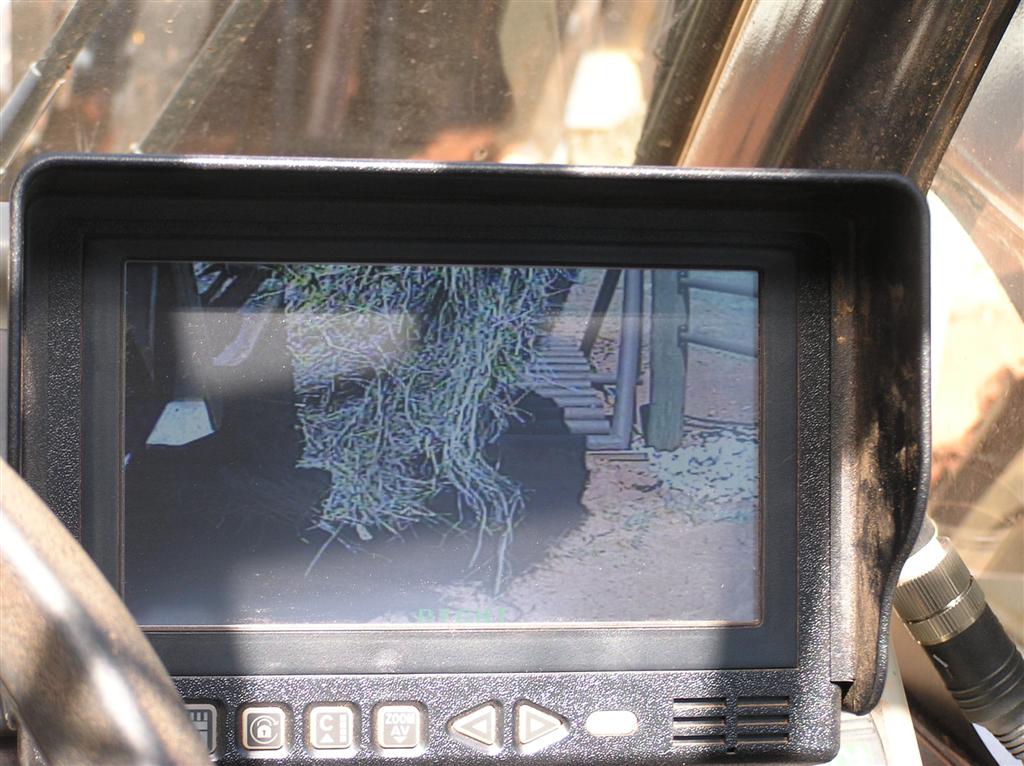

Approaching the cattle guard:

And a picture from behind, showing the clearance:

I have to say that I am still disappointed with my system. The screen is just too small for working. I have a 7" monitor. And, I'm in a cab, but the sunlight is still too much for me to see enough detail.
I've put about 40 hours on my tractor in the past week, about half of that with the tiller and the other half with my blade doing some laser leveling. I find myself looking at my mirrors a lot more than looking at my monitor. Oh well....

No sun problems with mine. You can see the sun on parts of the screen in some of the pictures, above.
Thanks! I think that offset cab works to your advantage with the camera setup, being able to eyeball the left while viewing the right on the screen.
