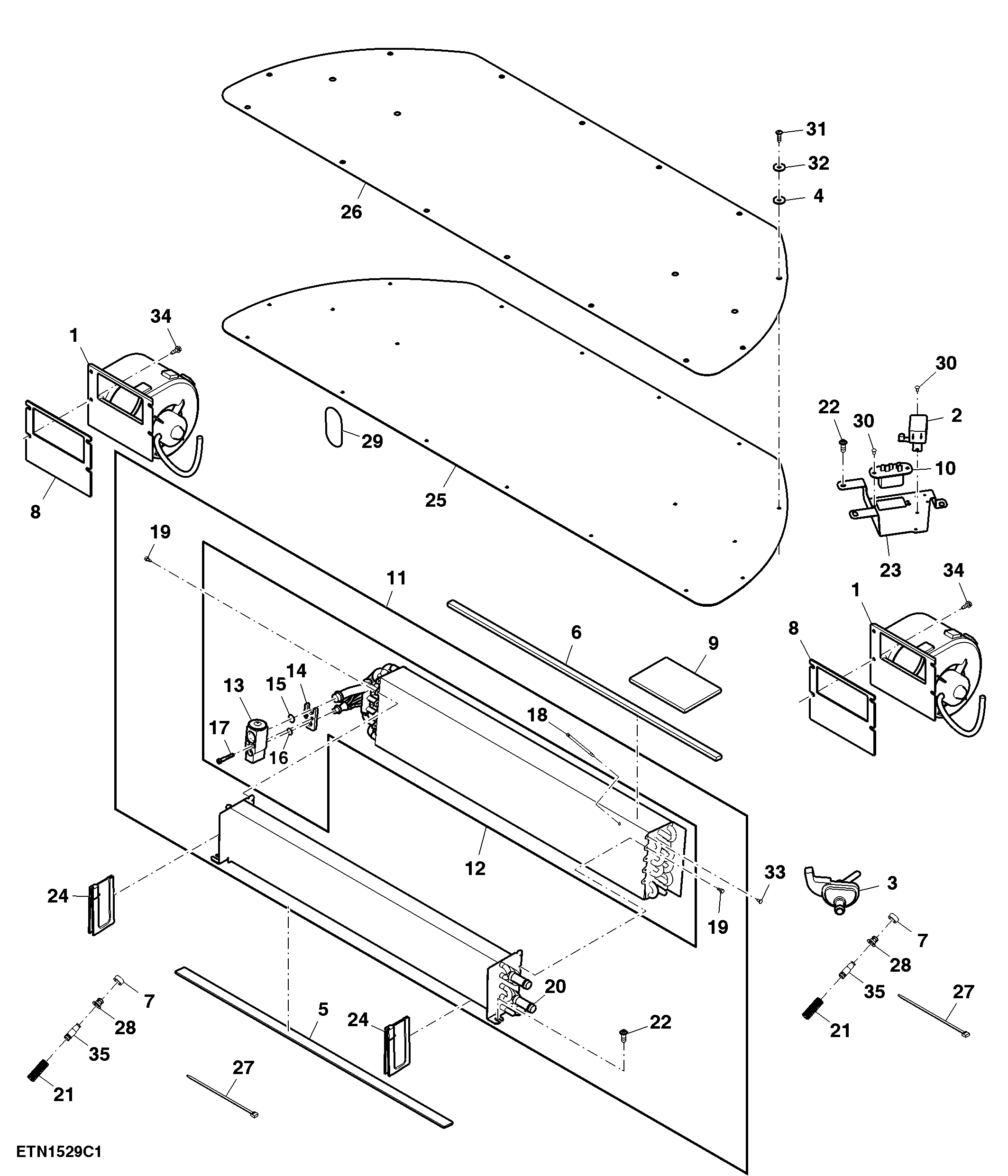

The service manager stated that when they had the tractor 2 weeks ago, the Freon was a little low on the gauges. So they recovered the Freon and charged it back to spec and leak checked the system. He said it was blowing ice cold in the shop. Since I am still having problems, he said it sounds like the water valve may not be closing (just as some of you have stated).
A tech came out Monday afternoon and determined that the water valve was indeed letting in too much warm water. After fully adjusting the valve, it was still letting in too much warm water. Therefore, they ordered parts and will hopefully install them Friday.

The service manager stated a good symptom of the valve letting in too much warm water is that the ac will cool good initially but starts to diminish as the engine warms up. He was spot on. I held a thermometer to the vents and the air was blowing 45 degrees upon initially starting the tractor. However, a few minutes later, the air was blowing 70+ degrees.

Where is that valve at trook?

I'm not exactly sure, but it is apparently somewhere in the roof.
Correct water control valve on a JD 5075E is parts key #3
