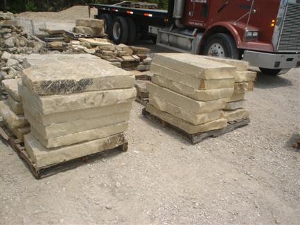

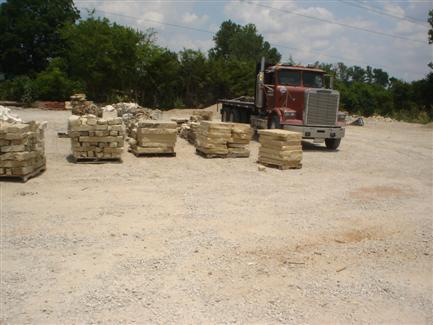

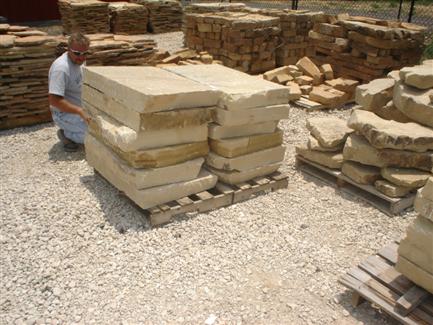

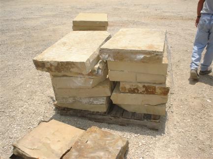

About two thirds of the stone slabs found their way to the stoneyard yesterday about noon.

Good grief those slabs look heavy! How do you move them around & into place?

Heavy AND awkward!!!!
I'm trying to imagine what it will be like moving them around on that slope. One missed step, or slipping while walking, and it's going down. Maybe a crane????
Do you start at the bottom and work your way up? Can the first step support the weight of the next stone?

I'de be real curious to know what a pallet of stone like that is worth Harv.
That stuff looks like it would put hernias where they don't belong.

The slabs weigh between two fifty and four hundred lbs.
All the work with them once we get down to the lower level (upper level of the walk way) will be done with leverage and luck.
The stone was cut to our dimensions. It's almost three hundred dollars a ton. One of those pallets weigh between thirty five hundred and four thousand lbs.
We will be handling the stones quite a bit. We will have to get them down from the street to the lower level. There I'll pick a stone I feel is appropriate and manuever it down to the place it's supposed to be on the walk way. Once I have it where I want it I'll turn the rock over so I can drill the locating pin holes.
The way it will work is every stone after the first one (last one since it's the bottom one) will be held in place by a couple of locating pins that attach it to the framework I've installed. It'll have the next stone laying on top of it and that stone will also have locating pins to the framework. Every stone will have gravity and mechanical advantages. ; > )
The positive side of this method is the farther up the walk way we get the less distance we have to move stone.
Job planning!!
