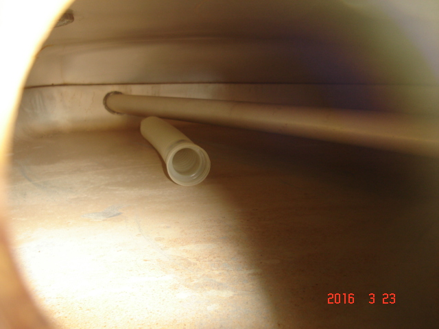

EH, that would be a 1956 PA-22-150. Currently have the wings in my garage for some needed repairs-- last time they were re-worked, it seems quite a few short cuts were taken. :thumbdown:
Found a plastic gas can spout sitting inside the right tank (here's a view through the fuel gauge sender), as well as a totally plugged up finger strainer in the forward tank outlet :grumpy: A labor of love. Wish it worked as well as my GC2310!
