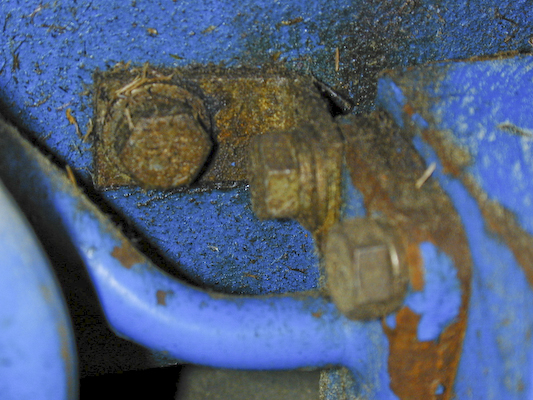

Looking for other owners of the 1510 tractor that can share some photos of their tractor with me. I am trying to figure out how the Hydraulic Manifold mounts. The block located in front of the right step plate. Mine is just hanging there being supported buy the hydraulic lines. Would be nice to see a picture of one mounted and / or the bracket .

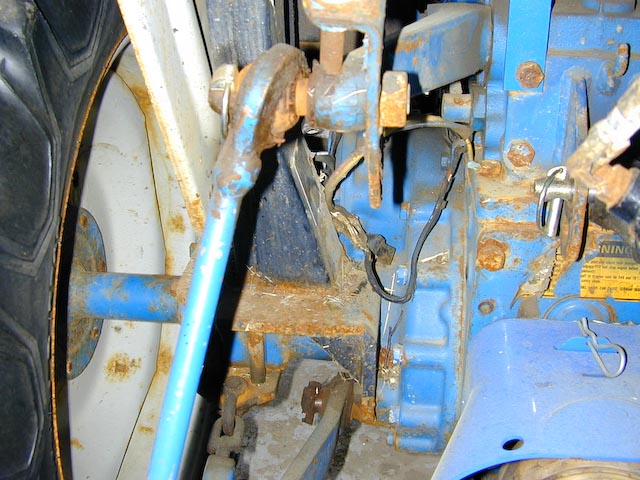

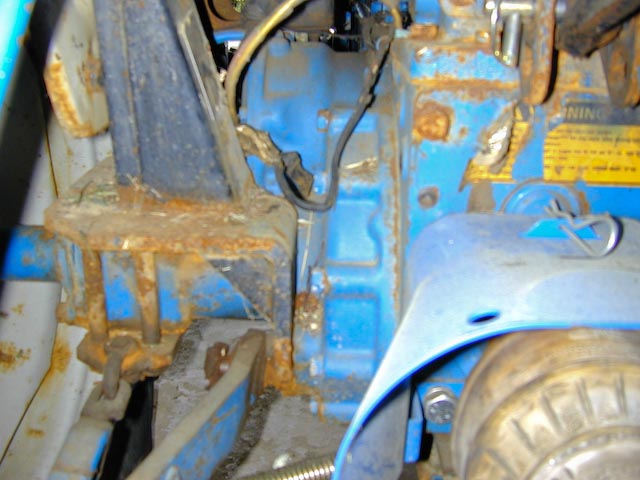

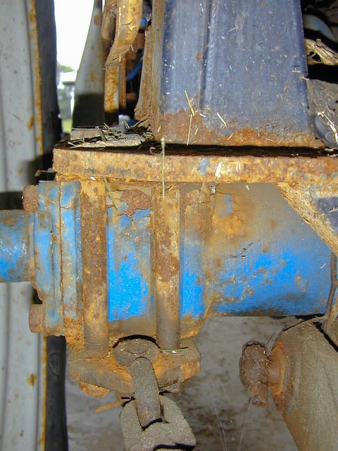

Also would like to see some close up photos of the ROPS assembly and the way it mounts.

on my 1710 tractor which i think is very similar to a 1510, the manifold block has a small L shaped bracket that screws to the manifold block and then to the frame. there should be a screw hole right next to the manifold. my bracket broke years ago so i replaced it with another L shaped bracket which also broke. they both broke at the bend.
   / A few questions about Ford 1510 tractor #6
Here's a closeup view of the mounting bracket. As randy41 says, it's just a small L-shaped bracket - one end on the manifold block and the other on the tractor.
p.s. repeat after me....I see no rust, I see no rust,

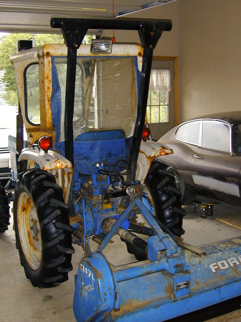

now as for the rops...
I assume (hate that word:mad:) you need to see the bottom attachment points - (repeat previous magical chant...I see no rust....):laughing:
I included a (poor) overall view to give some idea of proportion - no one EVER accused me of being a photographer:confused2:
Let me know if you need greater detail or different angles.

Thanks for the photos. You know what they say, a photo is worth.....
That helps a lot. If I may ask for a few more from the front side and a overall shot from the side to see the angle of the cage.
BTW it is a 2 wheel drive
Mike
P.S. What rust???
