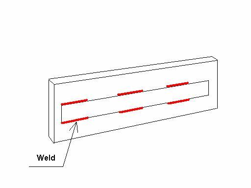

but stitch welded it so it won't distort the existing angle. Is this right?
When doing this type of work, I like to use opposing welds. Make the same size, and length of weld opposite of each other. That way you'll have less chance of warping. ;)

Thanks Shield Arc. Where do you get those diagrams?
