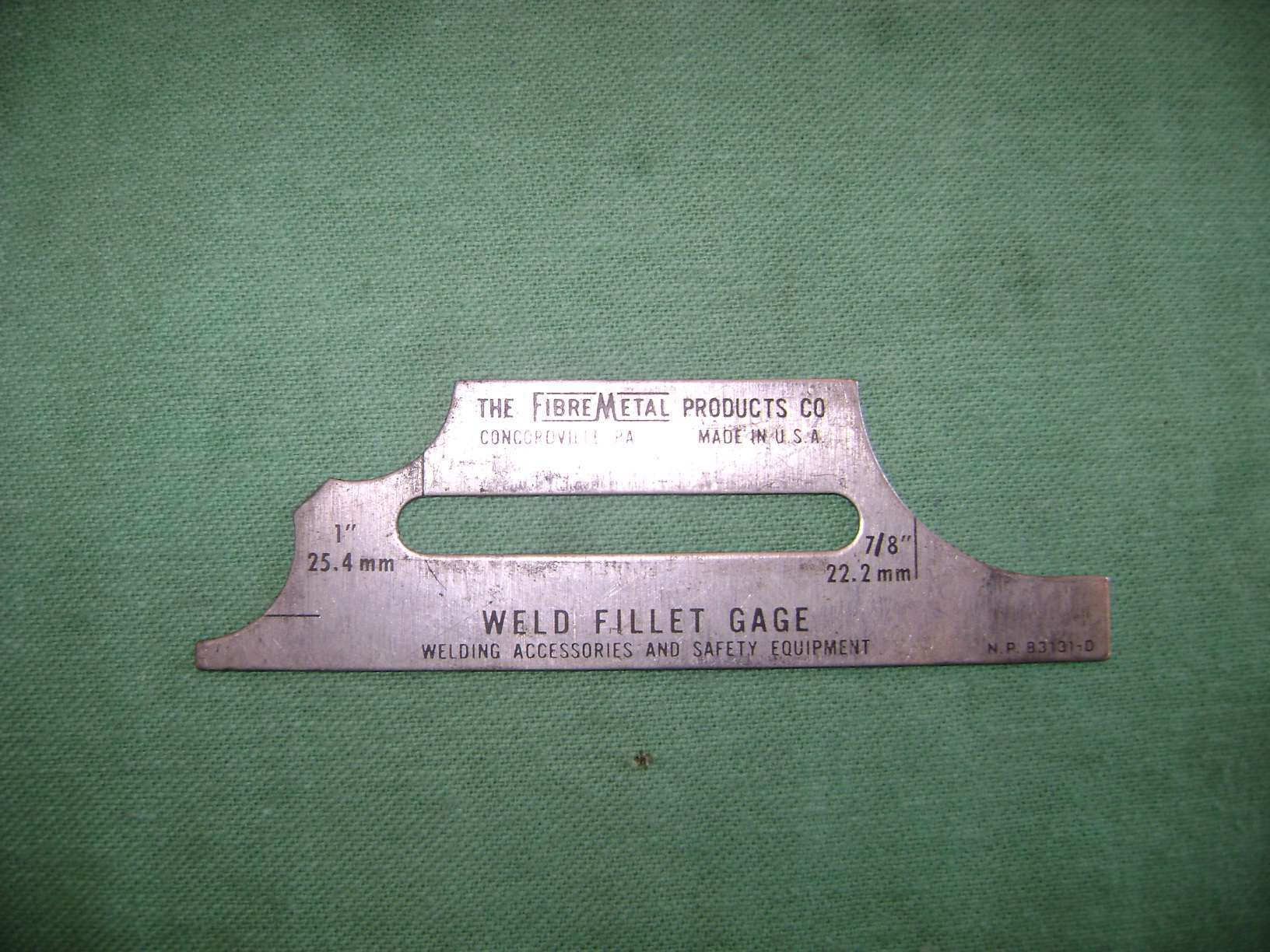

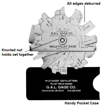

What, do you teach welding? With my 'toy outfit' or my lack of skill, or both, I have no consistentcy in the size of my welds.
I usually always lay in way too much then go back and grind them down. Any advice?
No I'm just a hobbyist.
Really the size of welds comes in time, you just have to put in the time. Once you've welded for some time you should be a pretty good judge of how big to make a weld. Now really this only matters when you're working off blue prints where the engineer calls for certain size welds. But you really need a set of these so you know you're doing it correctly. When the time comes post some pictures of your welds there are several guys here who can help you with your welding.
